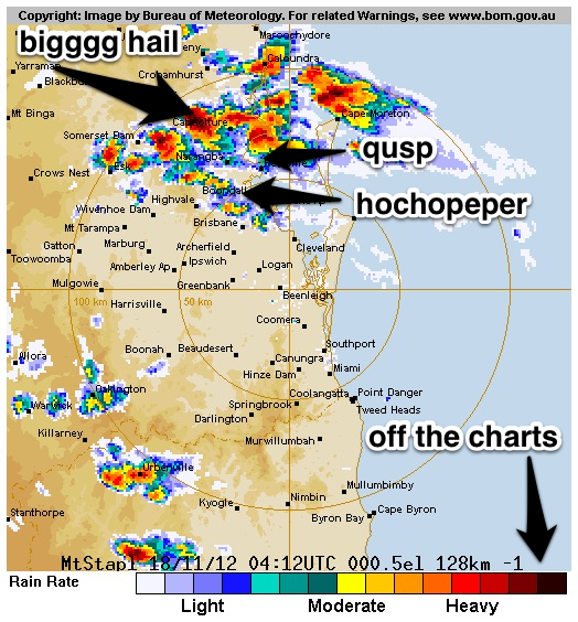

Time to shut your windows mate? Another storm not far off here now 😱
Edit: For shenanigans I did up a screenshot of the weather radar ...
