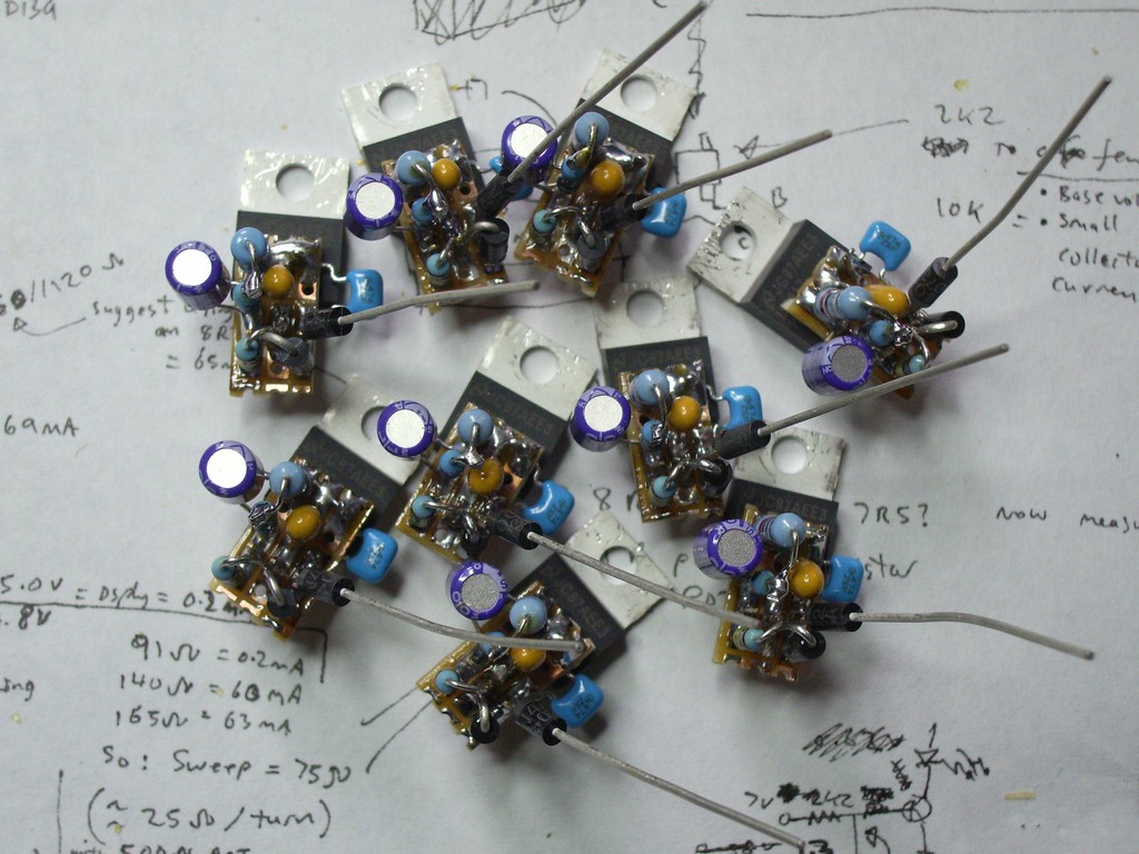

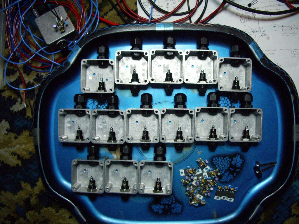

Why not just fit the same components Owen used onto some Vero board, or better, Tripad board? It's easy enough to do.
Here are some I made for another project. They had to be 6.9 volts:
Why not just fit the same components Owen onto some Vero board, or better, Tripad board? It's easy enough to do.
I was considering that as my last resort as I am not an experienced DIY'er. Maybe I will look into it more seriously. Thank you.
The heatsinking was done by the case the regulator fitted into.
If there was a next time I'd look at using more surface more components. With this project, on the non variable +5V regulators, I used just one surface mount, a tant cap which can be just about seen on the 3 regulators on the bottom right.
Thanks 🙂That looks fantastic!
