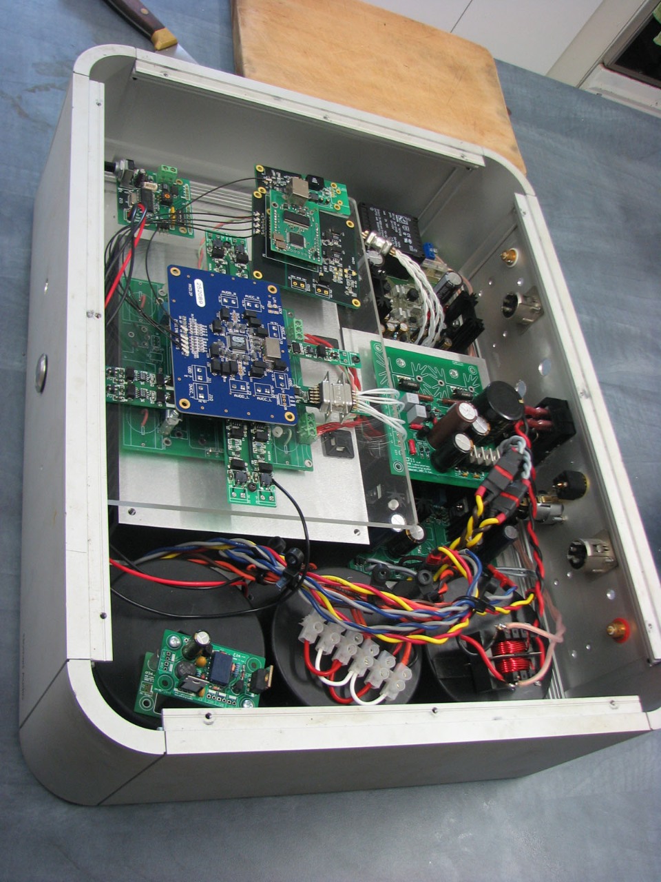

I rounded up another SE board, rebuilt it and stacked it to produce a balanced setup. Waiting on a new case, so here's the 'rough' of it 🙂

whats the point of the SE-BAL for portable? I could understand with a headphone that needs a lot of voltage swing perhaps, but its of no benefit otherwise.
It just adds more noise and doesnt cancel anything except the impossibly small amount of THD from the buffers themselves, it does not cancel anything from before the conversion, SE-BAL conversion for portable amps on head-fi is....
I just checked the spec on the RE272.... very high 103dB sensitivity and 20ohms, you would just be making them a more difficult effective impedance (10ohms), thats all, for no benefit. methinks you need a better dream =)
without a balanced source, the only benefit is higher voltage swing, which is unnecessary for your RE, it would actually be a disadvantage
the SE-SE has lower noise than any of the other wire headamps, the BAL-BAL has lower even order distortion IF fed with a balanced source, otherwise the SE-SE is the better amp

Well I hate to say it, but I purchased another builders completed amp, broke it down for parts, and rebuilt the board 😎 It certainly was the round about way, but hey - I was determined.

Since both the LME49990 and the LME49600 can handle +/- 18V your setup could be run at that voltage and would provide the highest voltage swing of The Wire series. I'm not sure if it's of much use, but if you do have a pair of high impedance and low sensitivity drivers, then it would certainly be an advantage to have the extra swing.
If you pair the above setup driven directly off the NTD1 I just shipped you, I think you'll be a very happy camper. I don't know that you could have a better front end for driving headphones.

Owen; pairing the balanced SE/SE/SE/SE wire with NTD1 is exactly what I've been working towards for quite awhile 🙂 I believe you're right - I expect it to be a chain I'll rest with for quite awhile (and I don't rest easy).
I'm driving HE-5's with a 4x gain. They're not very efficient but 50Ohms impedance; they may benefit a bit from the additional 'v'. Sonically as you'd imagine, the sound is more of the same. It has all of the characteristics of the SE/SE with more swing. It's dead quiet, fast, flat, dynamic and detailed. Yea, I like 🙂
