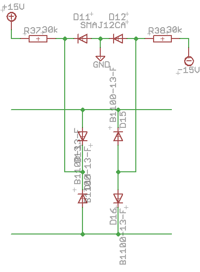

Input over voltage protection (OVP) with schottky diodes or 2N3904?
I'm curious if you guys (and hopefully OPC too) can comment on using diodes to protect The Wire (BAL-SE) from input overvoltage from upstream gear with higher rails, which could be accidentally (by human error) turned up very loud, and therefore be capable of higher output voltages.
There are a few documents outlining how this might be possible (such as this app note from Analog Devices), but actual implementations seem oddly rare. The general consensus seems to be low-leakage schottky diodes such as BAT-85 (or even 2N3904 wired as a diode using just CB and leaving the emitter disconnected). There are also special devices that exist for this purpose such as the ADG465, but the data sheet mentions nothing about distortion, and the ADG465 isn't popular on this forum, turning up exactly 0 (zero) times after a quick search!
So is it possible to maintain the ultra-high performance of the Wire, maintain the headroom, and somehow have trouble-free input over voltage protection? Attached is what I think might work, but I'm unsure about distortion...

I'm currently playing with the attached idea. I stumbled upon it at THAT Corp. (in a design note and an AES paper) and later discovered it in some projects (i.e. a preamp by Uwe Beis).
The general idea is that the protection bridge is biased into not conducting under normal circumstances, as opposed to a diode that is directly attached to a supply line.
It should be noted that neither National (LME49990) nor TI (OPA1632) are telling us much about the internal clamping diodes at their ICs' input.
To be honest, I never actually heard a difference between diode circuits at amplifier inputs (nor did I ever try to).
