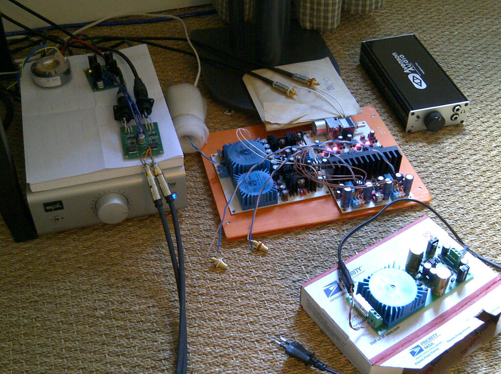

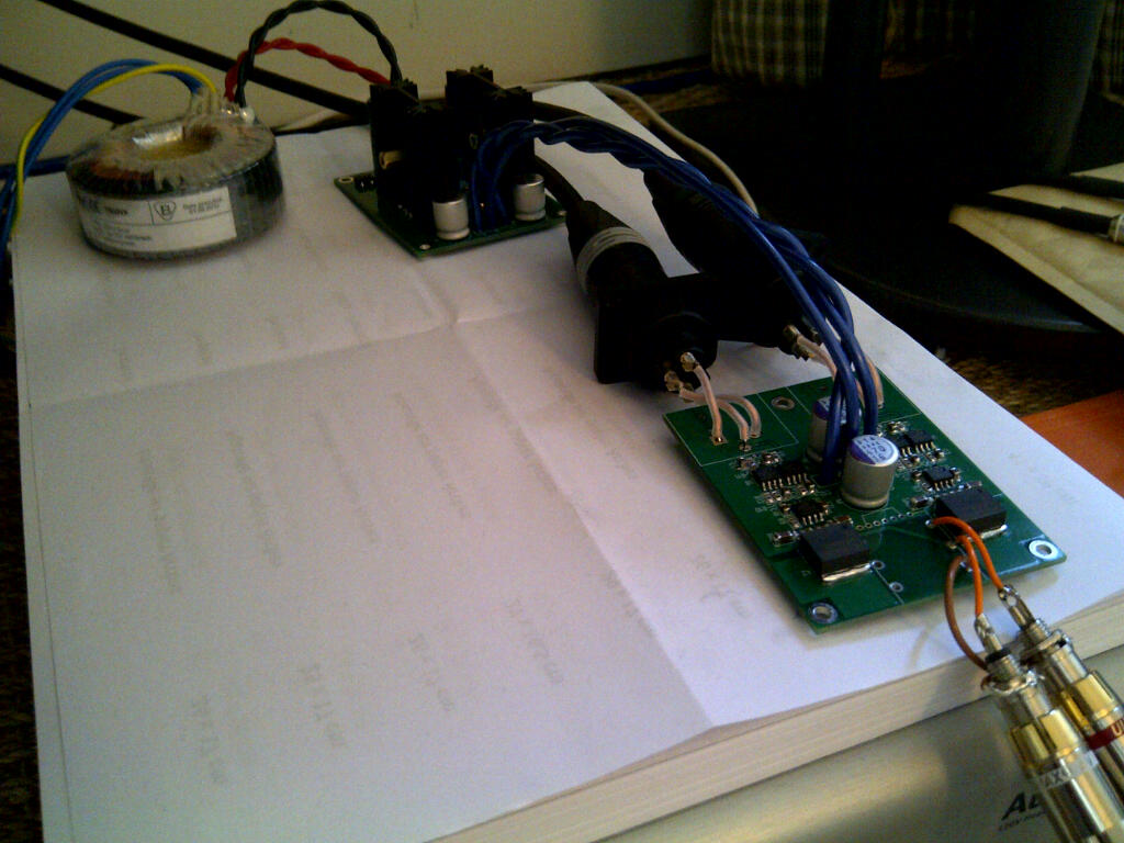

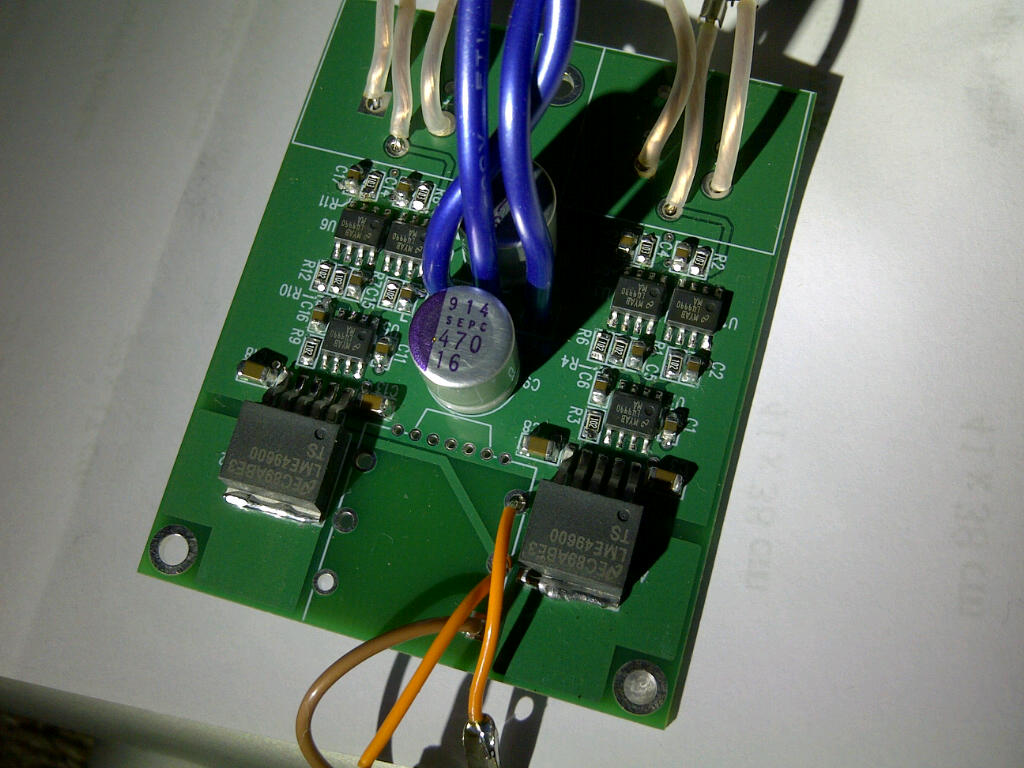

Yesterday I finally received the parts that prevented me from building the first iteraton of the Wire!
Next minute, solder time begun! Moved on with wiring and laying out a temporary test rig. Plugged my headphones on, and... listened to the radio! I could even faintly understand what they were saying. Cool. The high bandwidth of the wire do indeed makes it very picky to interference. Seemed like my shameless naked balanced cables were in cause. So I was back to the soldering rig building a good shielded cable using my trusted mogami 2549.
I plugged my headphones on again, and... Oh god is the amp fried??!! Nope, simply very very quiet (scarily so, I mean this thing is dead...).
Anyway, I hit play, and blissful sound came out.
Pics below to please you hungry people!!
Ruthless impressions to follow, and comparison with several commercial and diy products, in my quest of the ultimate line/ headphone amplifier.
Expect comparison with:
- SPL Auditor
- AMB Labs Beta22
- Avenson headamp
- Dispre-2 JFET
- Customworks Hypa-300SE
- SPL Auditor
- AMB Labs Beta22
- Avenson headamp
- Dispre-2 JFET
