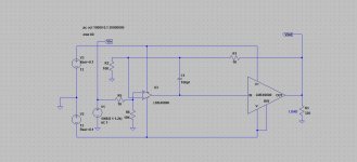

Regarding stability of SE-SE version...
Hi all! First of all, let me introduce myself, as I'm new here. I'm from Spain, and although I'm not working in electronics, I have a electronics degree and electronics audio is a great hobby for me.
I wanted to design and build a headphone amp from scratch (just for the fun of it), and I found the LME49600 buffer. I thought that was all I needed to do it neatly and high quality. I looked at the reference implementation in the datasheet, and tought about removing the DC servo, and making it unity gain. I performed some google searches and of course, The Wire SE-SE was almost the very same thing I wanted to build. The thing is with such high speed parts, stability was my main concern. I knew LME469990/LME469710 are unity-gain opamps, and LME46900 is advertised as seldom making inestable a already estable opamp, but I simulated the basic circuit and found some kirks...
First I implemented the schematic:
Then, performed a simulation with default parameters and a 500KHz 1Vpp square signal to test its response:
It seemed nice and ok, but I wanted to study the overshoot, so I reduced the simulation timestep to 1e-09 and ran it again to get more detail. That's what I got:
Oh my! That was oscillating like crazy! I took some measurements of the oscillation: 250mVpp and about 10ns of period -> about 100MHz
So I investigated further, and simulated the openloop gain and phase (a bode plot) to see if that oscillation was a simulation error or the circuit was indeed inestable... That's what I found:
According the bode simulation, the circuits runs out of phase margin well before the 0dB point, so with the little gain that the circuits has (1.1) it enters in the inestable territory, and the offending frequency is approx. the 100MHz I found in the transient simulation.
Simulating the datasheet version, which the LME49720 and a gain of 2, the circuit is stable indeed, altough with a phase margin of about 54 degrees, which I think is a bit on the low side.
And its square-signal at the same timestep shows a bit of overshoot/ringing, but quite bening:
So, after this looong post, the question is: did I perform any mistake in my analysis? Are the spice models/simulation wrong with such low timesteps? Did anyone measure the circuit's real response past 100MHz? With such a small amplitude oscillation, it probably almost didn't affect audio measurements below 50KHz, so it would be very hard to find when a default simulation shows good behaviour and a +100MHz would be needed to detect it!
Interesting analysis! I'll be curious to hear if anyone has measured this on the actual circuit, given that the TI LME49600 Spice model has such a boatload of conditions.
From the Spice model here: http://www.ti.com/lit/zip/snam140 (opens .zip file)
Notes:
- The following model parameters are modeled for nominal conditions: Gain, f-3dB vs RBW, Slew Rate, IQ, Noise, IIB, VOS, Output swing vs Output current,
- The following parameters are modeled but not accurate: VOH and VOL
- The following parameters are not modeled: PSRR, Gain vs Power Supply Gain & BW vs Rload, Gain & BW vs Cload
- This model does not reflect actual device behavior for supply voltages less than +-10V.
- Unlike the actual device, the model’s BW pin must be terminated by a resistance to VEE, and not left floating.

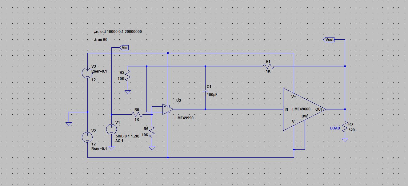

EgonVLC - I ran out of edit time on the post above. 🙂 Does adding 100pF or 200pF from the output of the LME49990 back to its inverting input in your sim solve it (with the LME49990 + LME49600 pair), as in figure 24 in the BUF634 datasheet?
http://www.ti.com/lit/ds/symlink/buf634.pdf (opens PDF)

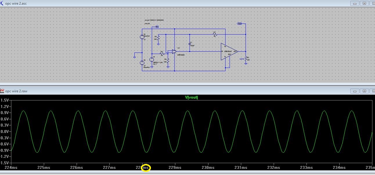

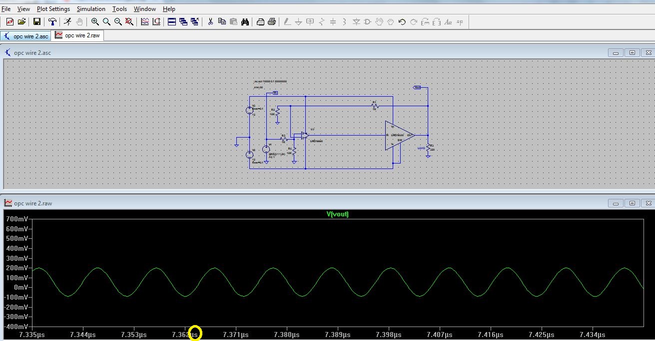

Does when I simulate it. Oscillates without the cap, doesn't with the cap. But... this is a sim. Might not have any bearing at all on real life. 🙂
Note the units on the graphs on the sims below. The first is without the capacitor. Period = 0.01032uS = 97MHz. The second, with a 100pF, has period = 0.833mS = the input 1.2KHz. The circuit shown in the 3rd is the same as the 2nd, just enlarged to be readable. These were done with a load of 320R, but the results simulate the same if I change it to 32R.
Yes, the usual ways to make a opamp stable do work here. I think the simulation could be right because the frequency response of LME46900 has a bump around 100MHz and that bump combined with the opamp open loop gain just puts the combined open loop gain in the unstable zone. If you use a opamp with less bandwith the simulation works ok too. Maybe in the physical circuit, because of parasitics capacitancies the circuit does not really oscillate, but it could be a interesting thing to measure.

Is the idea that you just need some voltage variation across R1 to vary the current and increase the accuracy of the Gm test and calculation and the exact voltage value is arbitrary? Or are you selecting the generator voltage so that the voltage at the FET's gate alternates above and below the threshold voltage and thus need a large enough VRMS?
If the FET is already biased to the operating Id and Vds by R1 and VR1, I don't see how 3VRMS from the signal generator translates into anything specific to the actual circuit operating conditions, but I definitely could be missing something.
If anyone has any clues on how to select the signal generator voltage for transconductance measurements, I'd appreciate it!
Hi Sabrosa,
I love the work you're doing with the simulations on the NTD1! I just finally (after 4 months of harassment and waiting) got my hands on the datasheets for the new ESS dacs. A complete system very similar to the one you've simulated is in the works. Preliminary measured results with the old DAC provide staggeringly good performance... exceeding datasheet specs for the old ESS DAC. I'll send you a PM to discuss further.
For the GM testing I think you may have misunderstood the setup. The voltage from the signal generator is applied to the location where "Vs" is on the schematic, and the resulting output voltage is measured across R1.
The 3V output value was chosen to give a reasonable adjustment range on the input side. If only 1V is used then your input adjustments become quite sensitive, and results will be less accurate. Larger voltages could also be used, but then you're starting to stray further from actual operating conditions. 3V was a decent compromise, but it's not set in stone. Once you have the circuit up and running, it's easy to experiment and see what works best for you.
Owen

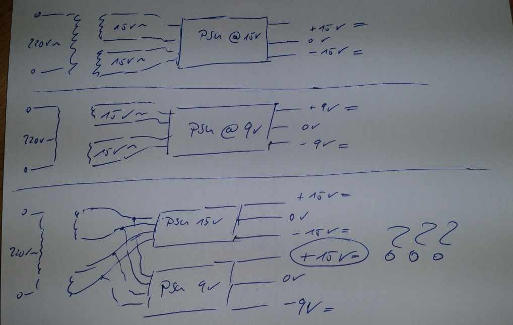

First of all; sorry for my bad english.
I have a very strange issue with The Wire PSU.
Transformer primary 220V~ secondary 15V~ 15V~
If I connect 15V PSU it works correctly @ +15V= -15V=
If I connect 9V PSU it works correctly @ +9V= -9V=
If I connect both PSU in parallel, 15V works fine, but 9V is -9V and +15V output
I have spent many hours on it but not the faintest idea what's going wrong ...
Hi Stachel,
Configuration 3 in your picture is not viable. Each power supply will require its own dual secondary transformer.
Owen
Owen
Hi Owen,
thanks for your reply.
Could you briefly explain why this is not viable?
Would it be vialbe if both PSUs were @ 15V?
And is it a specific characteristic of "The Wire" PSU;
would this configuration be possible with bridge rectifier + LM317/337 PSU?
Would you say it's "not best practice" or is it generally incorrect to build it that way; or even dangerous?
Thanks & Regards
Martin
