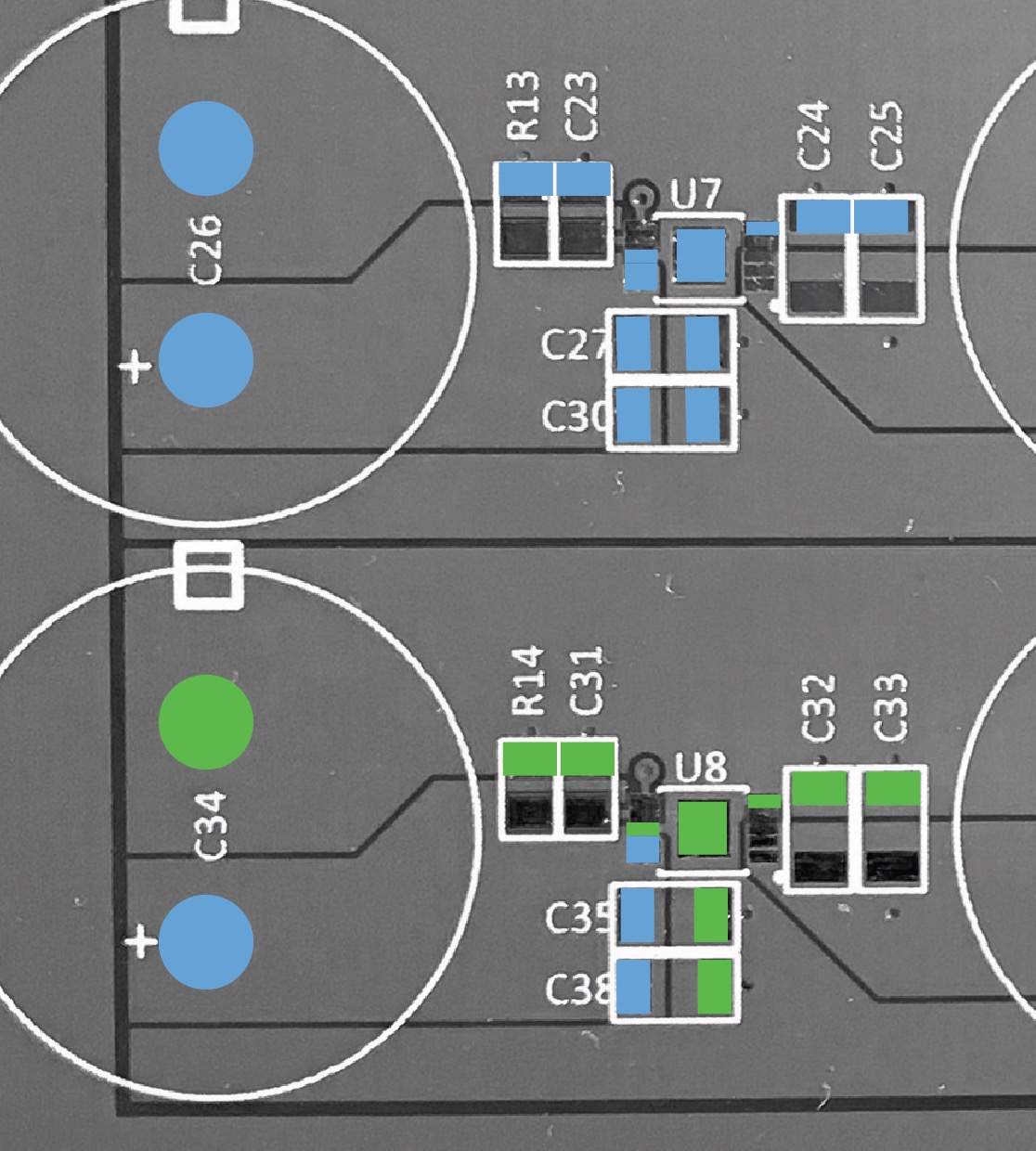

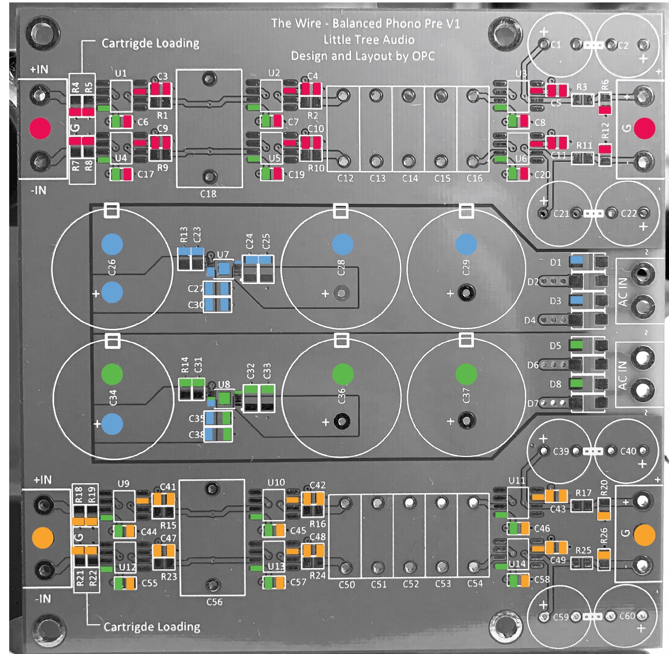

Through the kindness of a fellow DIYer I was able to get a phono board, and when it arrived I was concerned about the way the pads looked at the2 regulators. I think they're fine, but there is what I think a real problem. I've attached a photo of the board that has the 4 grounds color coded, and where they happen across the board. Note C26, which has both legs connected—this of course ends up affecting things all over the place. (I'm not saying that the problem is right at C26; it could be many places, and this is one of my questions.)
Is this correct? I don't understand how it could be, but I am self trained, and will be the first to admit my lack of understanding. I assume that the Caps all connected to the V+ on the INAs are shorted based on this also, but if not, would love an explanation about how they work that way.
Note that The grounds on both audio legs are shorted—I was testing across as 4 separate areas, but basically, anything marked magenta is also orange, and vise versa. But I kept these 4 colors going thinking it might make it easier to discuss.
So, if any of you either have specific experience with this board or can just explain what is happening (even better if you can suggest a trouble shooting process) I'd really appreciate it. I can send close ups of the board if that will help. I'd really like to build this project.

Hi Picovolt,
I'm impressed that you took the time to check the board for shorts before building! That's the sort of thing I always tell myself to do before building a prototype board for the first time, but then I get too excited and just build it. That has caught me out more times than one would expect 😉
In this case though, I can assure you the PCB is fine. The part that is throwing you for a loop is that I use two positive regulators to generate a bipolar supply. This is possible because the dual secondaries of the transformer are isolated from one another, and that isolation remains all the way until the output of the regulators where I use one normally, and the other has its "output" tied to GND and its "GND" becomes the negative rail. If you take a look at the schematic, this may make more sense.

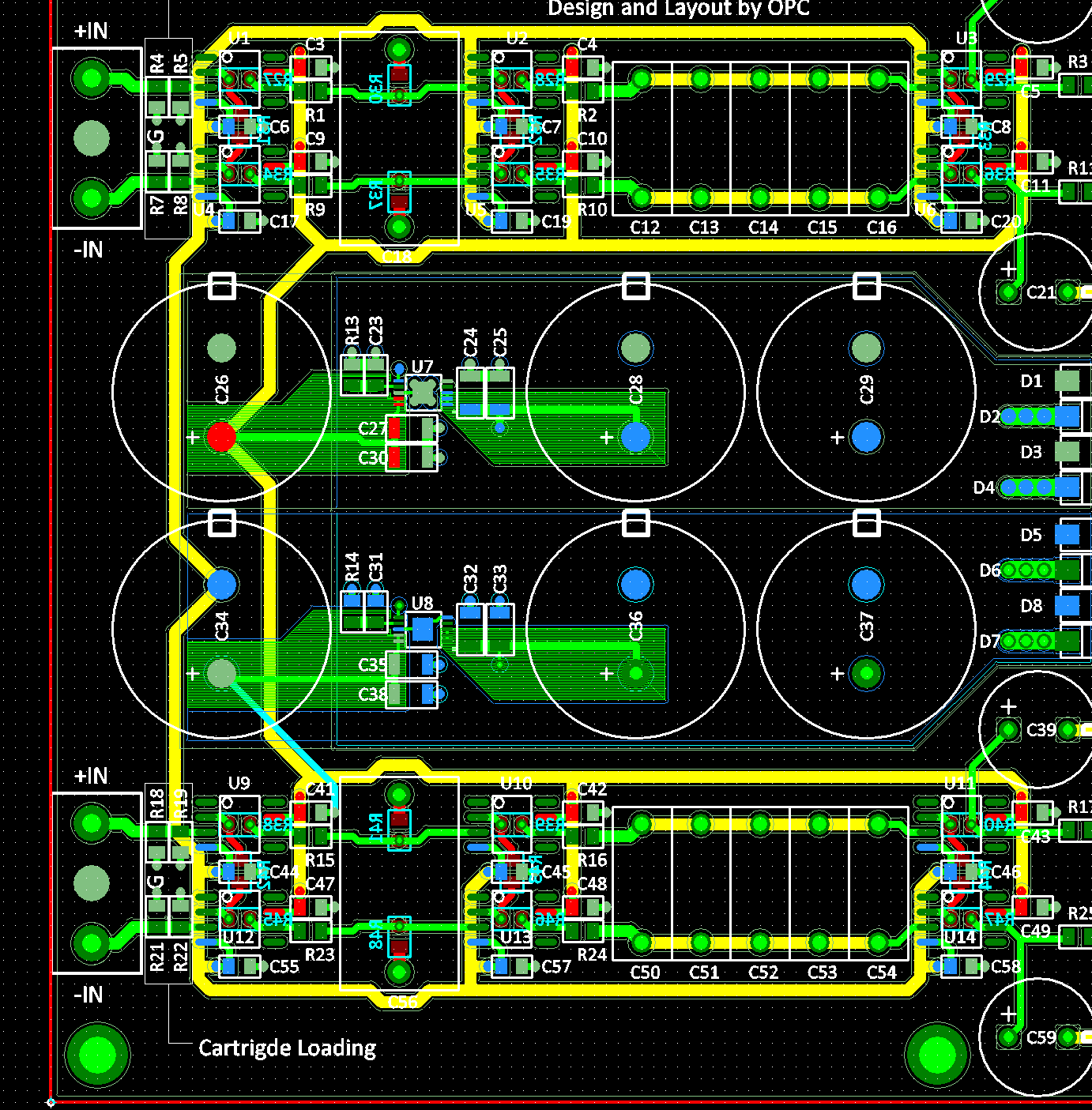

Also attached here is screen shot if the PCB layout without the power planes poured. Hopefully it will help you make more sense of things. I always colour code the nets when I'm routing as it makes things visually easier.
Take a look and see if it makes sense. I always build and test a board from every batch, so it's extremely unlikely that your PCB is not correct.
Owen
