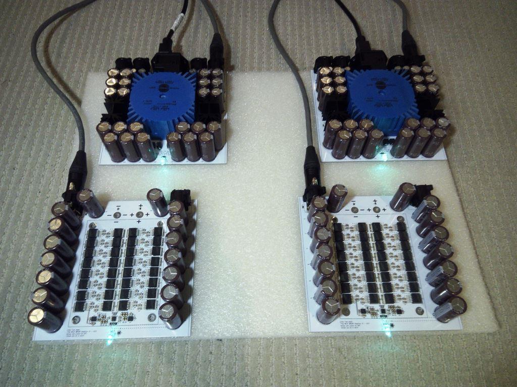

Thanks for the speedy and assuring reply—the board image helps a lot also. (It used to be so easy to look at aboard and see pretty much everything.) I'm going to need to study the board image to understand the V+ caps, this is still a bit of a mystery to me.

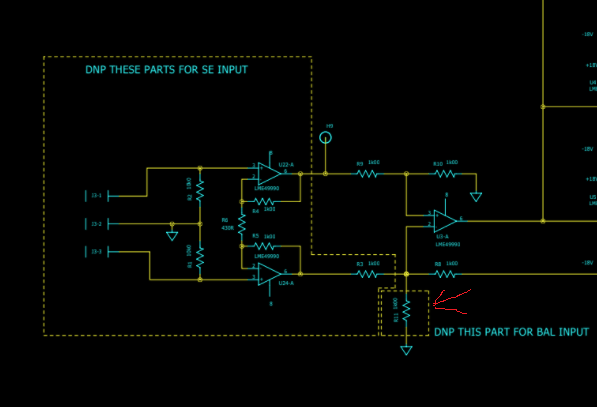

Do i populate R11 for SE Version or leave it out? anyone know?
Yes, you should include it for an SE build.
The contradictory negative right next to the other outlined section is somewhat confusing, I agree. Based on common op amp circuit design it should be there though, and that also seems to check out with the comment to the right of it.
Looking for one LPUHP V2 WIRE amp board if anyone would like to part with one or if some one has a pair willing to take them off your hands.
I have a pair assembled for unbalanced input.
I also bought a pair of "hospital grade transformers" and I have trouble finding the time to assemble these into an enclosure.
So I might sell them.
