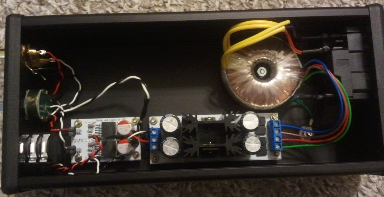

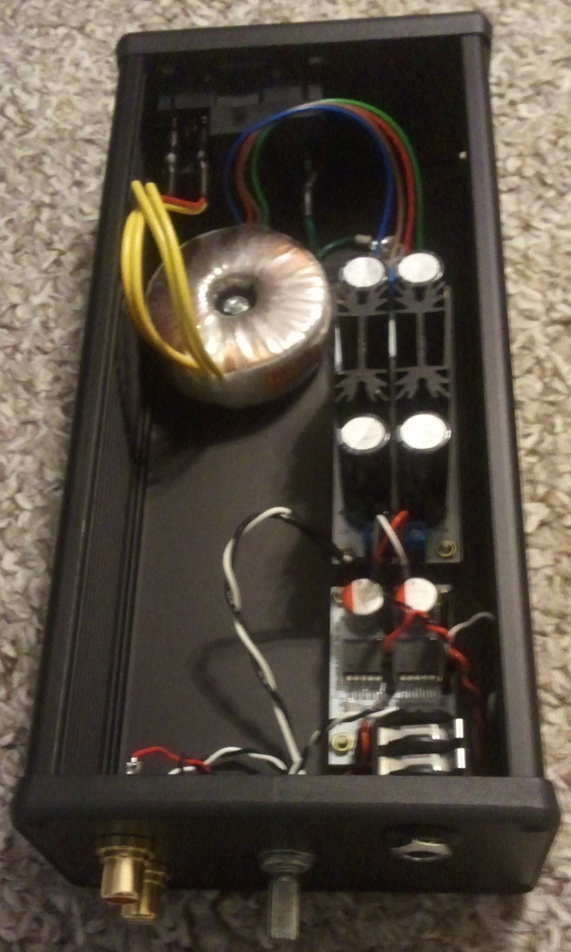

here's the completed build. i went with a gigaworks stepped attenuator which provides good channel balance and has a nice feel. still need to find a suitable knob, though 🙂.
it's running in unity gain and is fed by a subbu dac. i scoped out my normal listening level and found that i'm actually listening below the output level of my dac with my akg 271 cans, about 1.2v rms vs the 2.0rms they provide. on my other amp i was throwing away most of the signal. cranking it to max at unity gain feels like it'd blow out the headphones honestly, i'm at about 50-75% max.
the board level connections are standard .064" square post headers using ampmodu wire interconnects. they aren't as snug as i'd like but pass the signal just fine.
one thing that would've made things easier is marking the holes for the standoffs before completing the boards 🙂 maybe next time i will remember to do that.
thanks for a great amp.
-matt

Great looking build! I like the signal input, output and volume on the front 🙂
Overall the layout is very good, and everything looks nice and tidy.
As a "top tip" twisting wires together helps reduce the amount of noise picked up and the amount of noise radiated out, so if you ever have it apart, it would be worth twisting the AC inputs and outputs of the transformer together tightly in current-carrying pairs.
If you can't hear any 60Hz hum as it is though, then it's probably not worth the trouble.
As for the gain setting, I congratulate you on sticking with unity. As you mention, it's usually more than enough for almost any setup, and unless you have a DAC with very low output, or headphones that are very hungry, unity gain is probably more than enough. If you consistently listen around 75%, then you're right where you should be for system gain.
Owen

i ought to be able to twist the secondaries - but that thick yellow wrap talema put on the primaries would make it difficult to get a good twist on primaries. maybe it could be carefully removed but operations like that tend to take insulation with them in my experience.
sticking everything on the front panel was an attempt to minimize any 60hz pickup. so it'd make sense to take care of the secondaries. i can't hear any hum, i bet my adc would though ;-)
-matt
