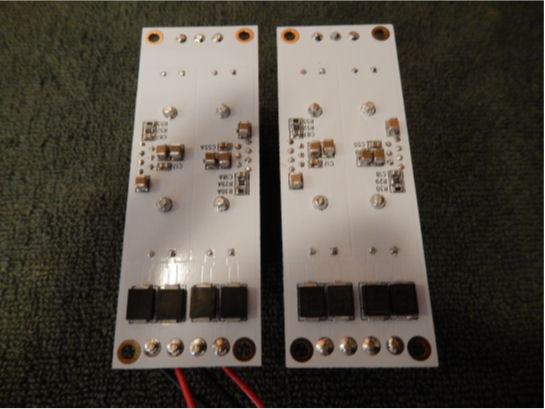

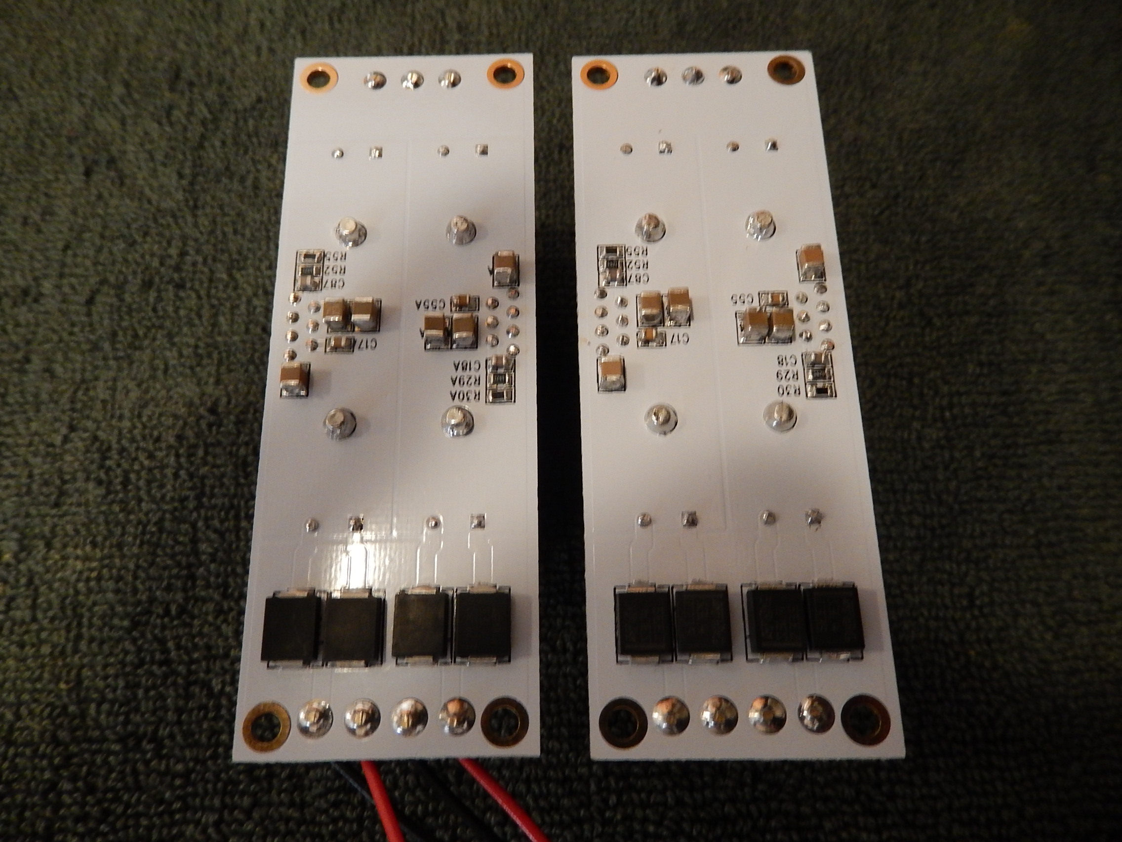

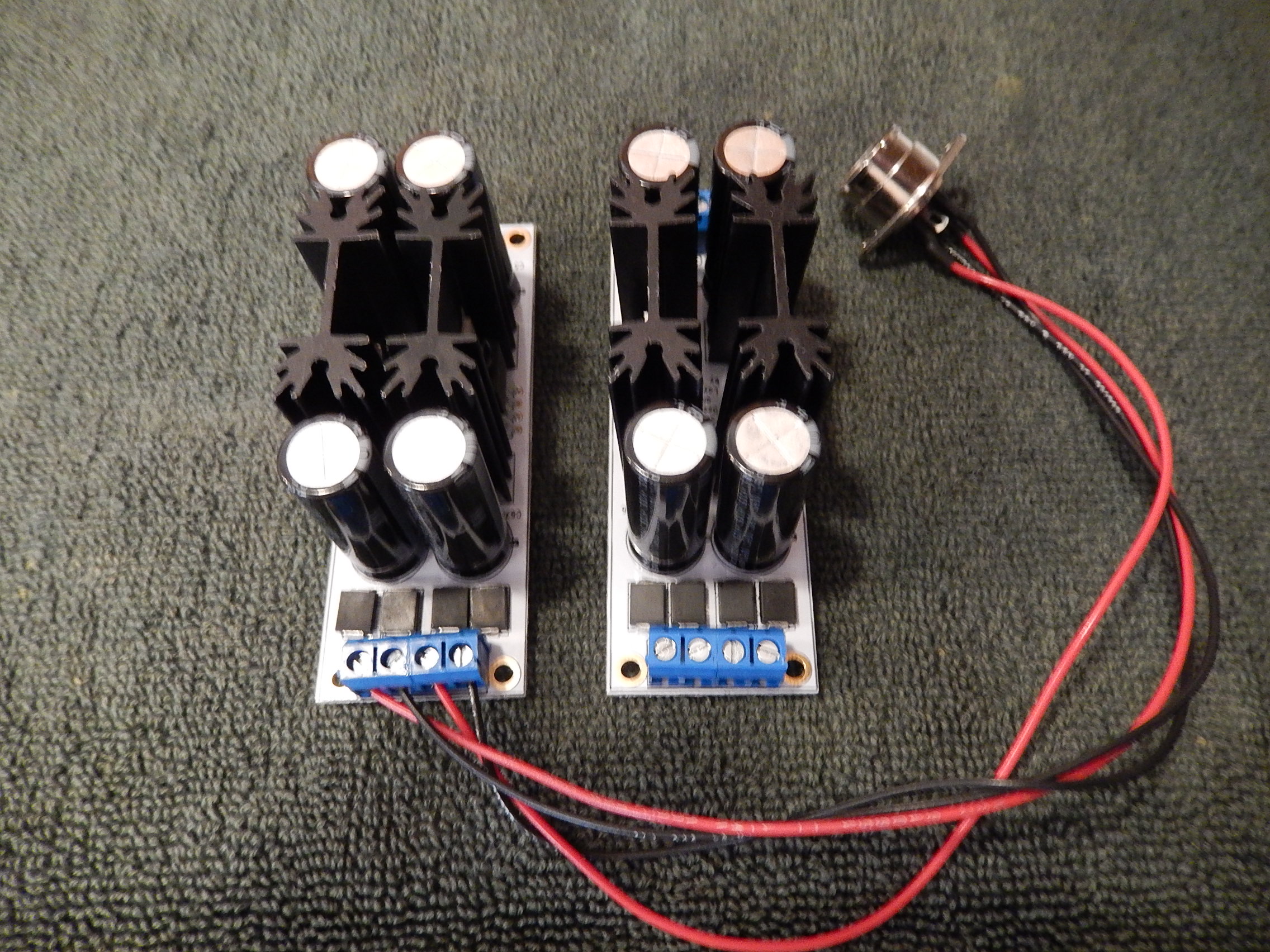

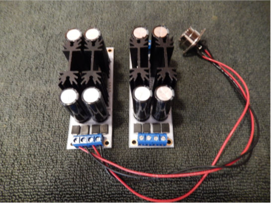

Hi All,
Finally got a chance to continue work on my "Wire". Completed 2 power supplies:
Supply on left measures -15.04 and +14.98. Ripple as best as I can measure it is .4mV. One on right measures -15.39 +15.14. Ripple a not so good 2.1 and 2.2mV respectively. I lucked out with the transformer, I am going to use a wall wart that I constructed for my CK2II. Perfect match.
Started to put the SE to SE amp together.
I stopped at the point shown because I had a question regarding the volume control. Seems that I read somewhere in the original Wire thread that there was a recommendation that 2 of the resistors should be jumped instead of being installed. I don't recall which ones. Sooooo, my question is what would be the best way to populate the input section of this amp. My primary phones are Senn 600HD's (300 ohm) and Beyer DT 880's (600 ohm). I have a Goldpoint 50K pot that I would like to use.
Thanks'
Jim
