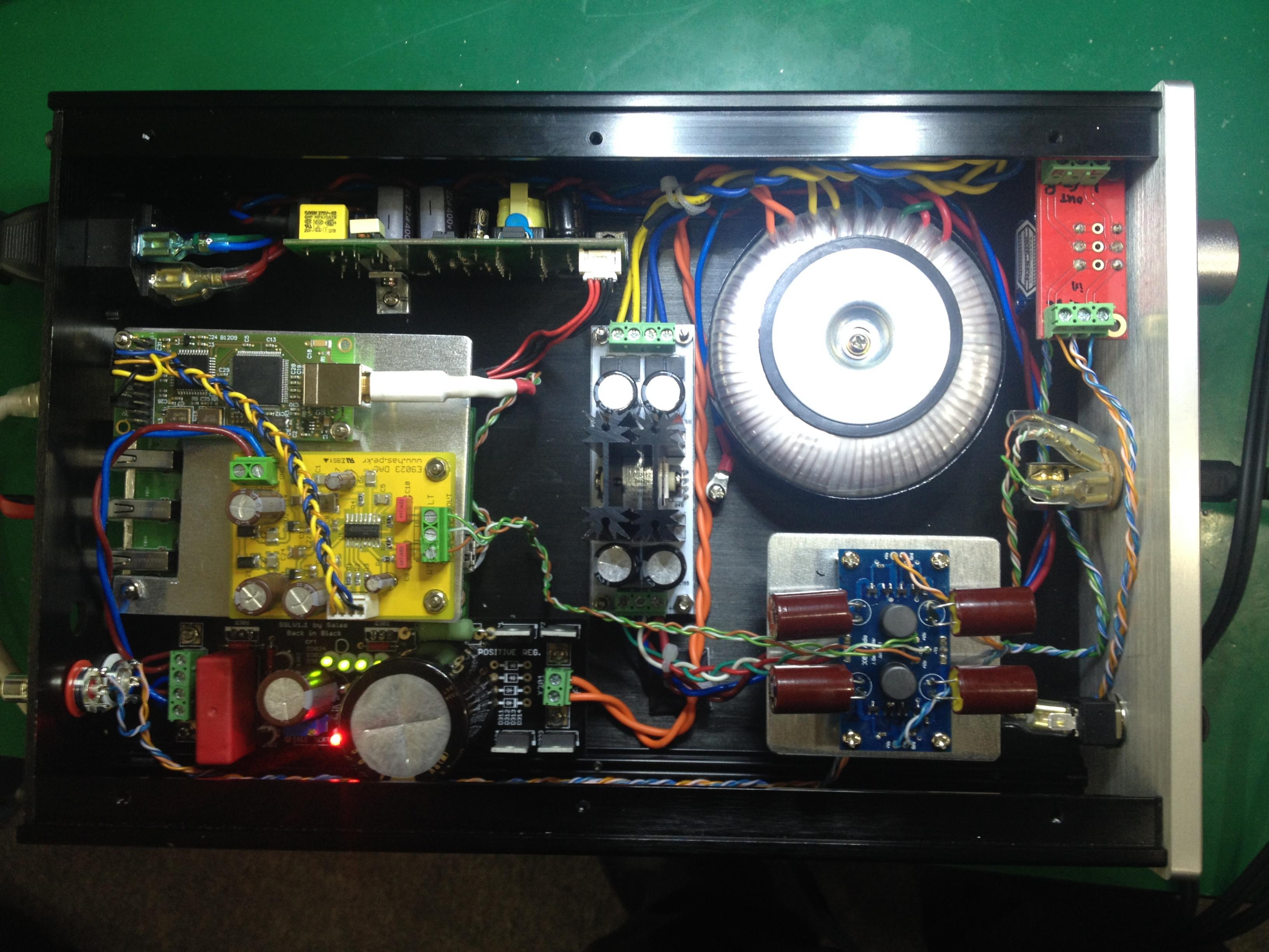

My BAL-BAL arrived today and all parts now soldered in place. Those heat-sinks are a pain in the bum to solder... Enclosure & a few other bits to get before it's ready to rock
They really are a pain, and probably not needed at lower rail voltages, but it's best to have them if you're running above +/-9VDC.
As an alternative, some builders have just sandwiched the whole board between two aluminum plates, which also works.
