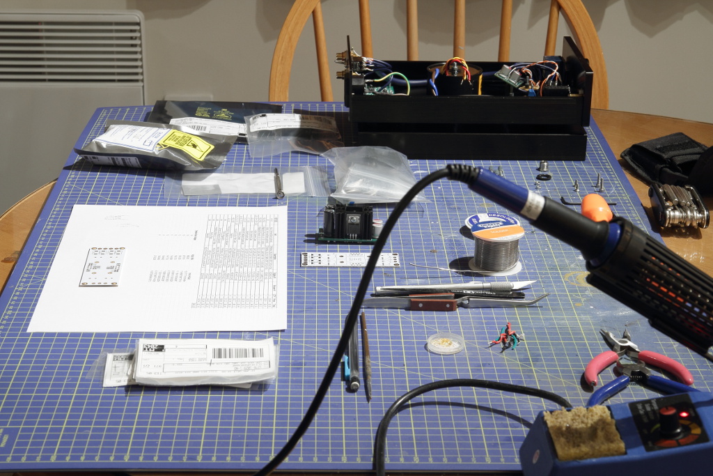

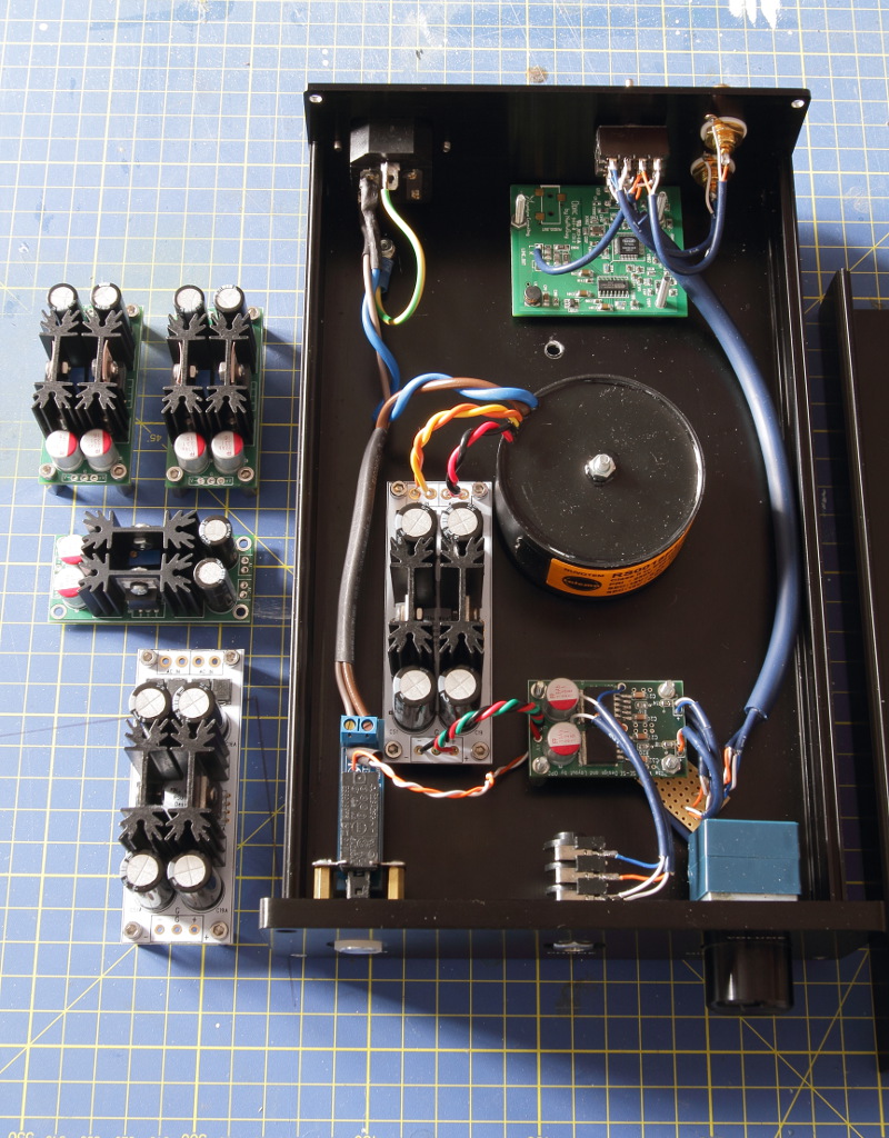

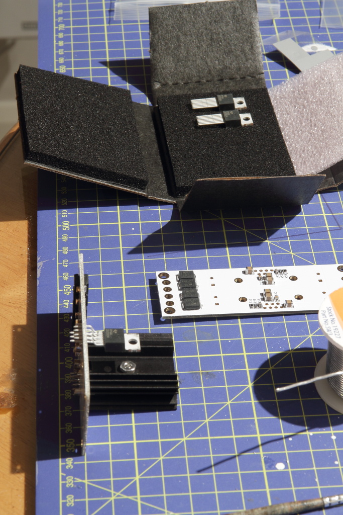

Pic's 1-3; getting ready to build the PSUs. Needed to bend the legs of the regs myself, and just about to fit the new PSU...
Very hard to comment on what changes occurred [if any] on swapping PSUs, maybe a touch cleaner through the bass registers. Without a direct A/B comparison it's a very tough call...

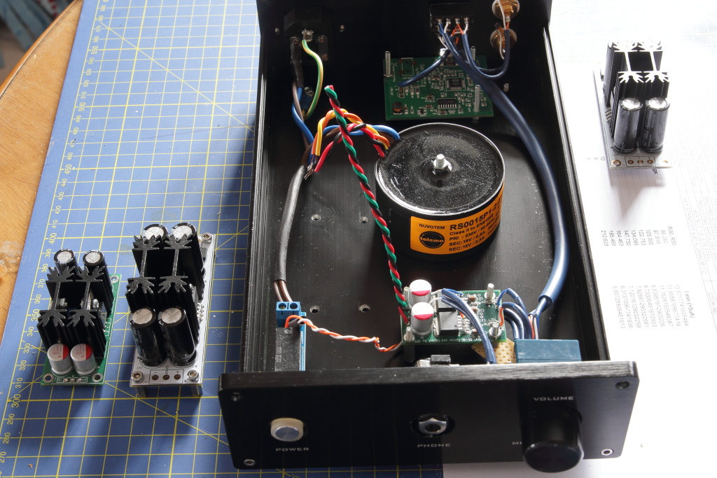

Forgot to add the picture of the fully wired SE-SE with new PSU and a few extras... not my tidiest build but works a treat.
Totally amazed by the clarity of detail and overall performance of this setup, certainly not left wanting for sure... However, am intrigued to find out how the BAL-BAL and a better DAC sound 🙂

You guys have this chassis thing down to an art!
Both builds look great, and really follow the minimalist intentions of the The Wire.
The layouts are excellent, and the finished product looks very professional!
Kudos to both of you 🙂
