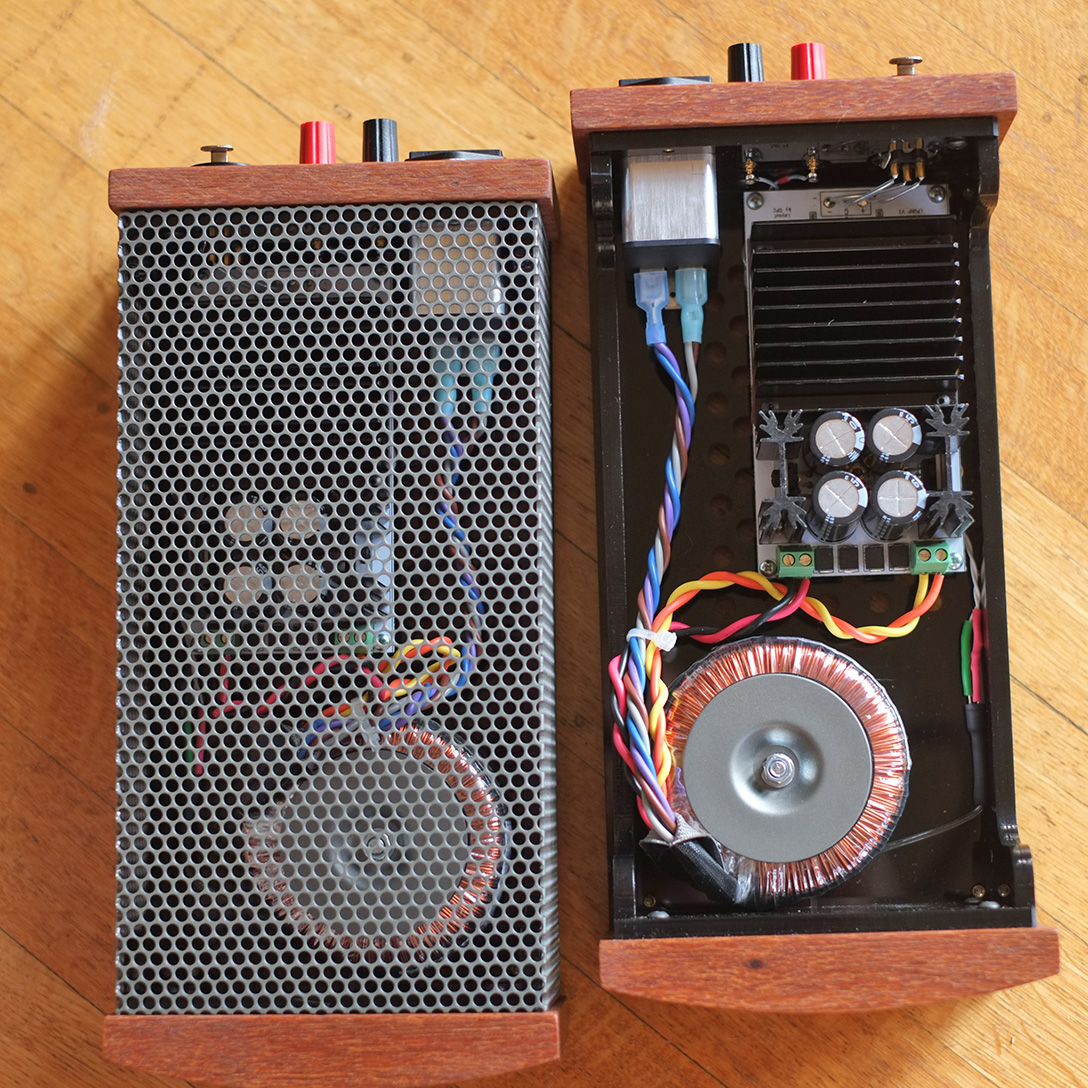

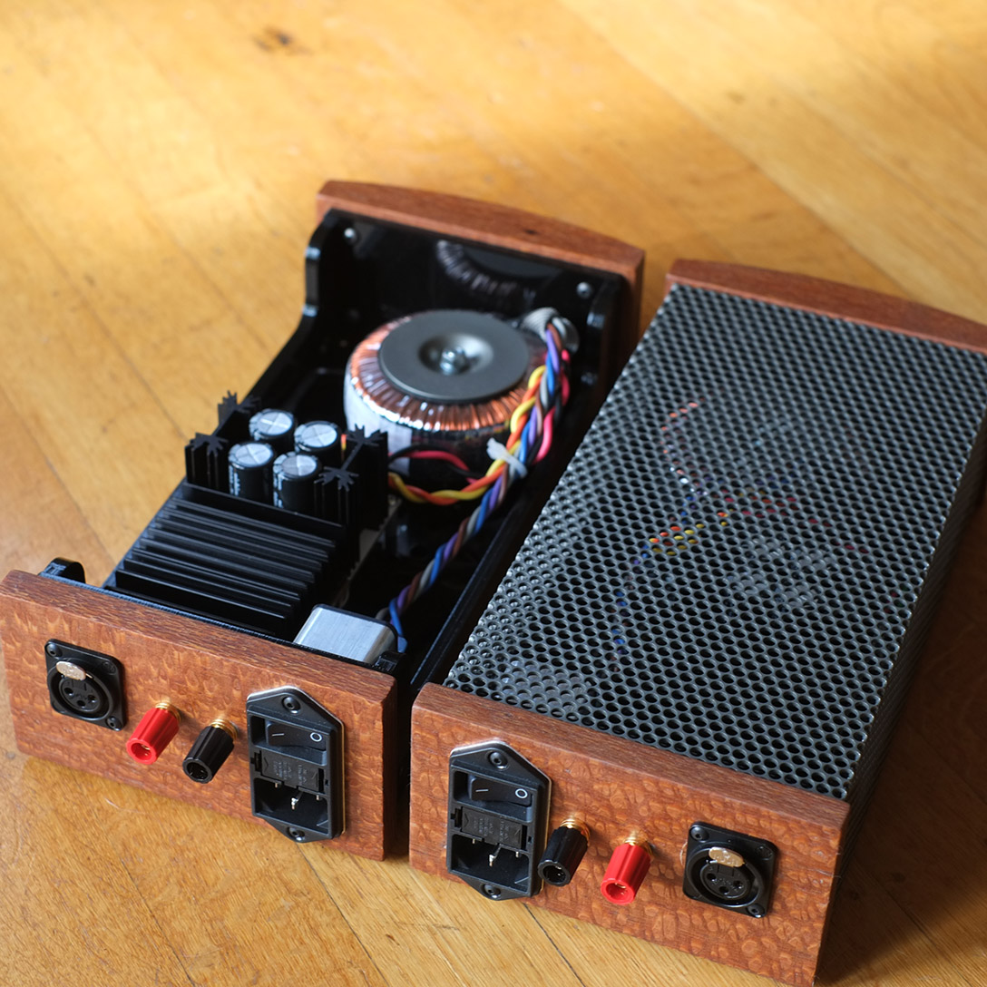

Hey Owen, I've just bought some speakers (KEF LS50's) and after building your HP amps, am keen to checkout your power amps for these bad boys
Am I able to order your MPUHP amp boards (for stereo) with a power supply (or two if it's a dual mono arrangement)?
I'm happy with fully assembled or bare boards for amp, psu or both just let us know what's available - keen to get these as soon as I can to drive these speakers
Thanks as usual Owen.

I had a slow few days at work so I was able to machine the case parts faster than I was expecting to. Fronts and back panels are milled from lacewood. The basic chassis is laser cut black acrylic. The light pipe worked great for the LED. I keep kidding myself that I will eventually get these parts (similar construction on my other projects lately) waterjet cut from aluminum and anodized (less necessary on a small box like these). Same with the perf aluminum—currently its just lacquer rather than anodized.
Pamona makes tellurium copper binding posts; I had never used them before, and while they're not as classy looking as many others, I've come to believe in the "less metal mass" for connectors. I've also been using Schurter AC inputs for a while now and really like their build quality.

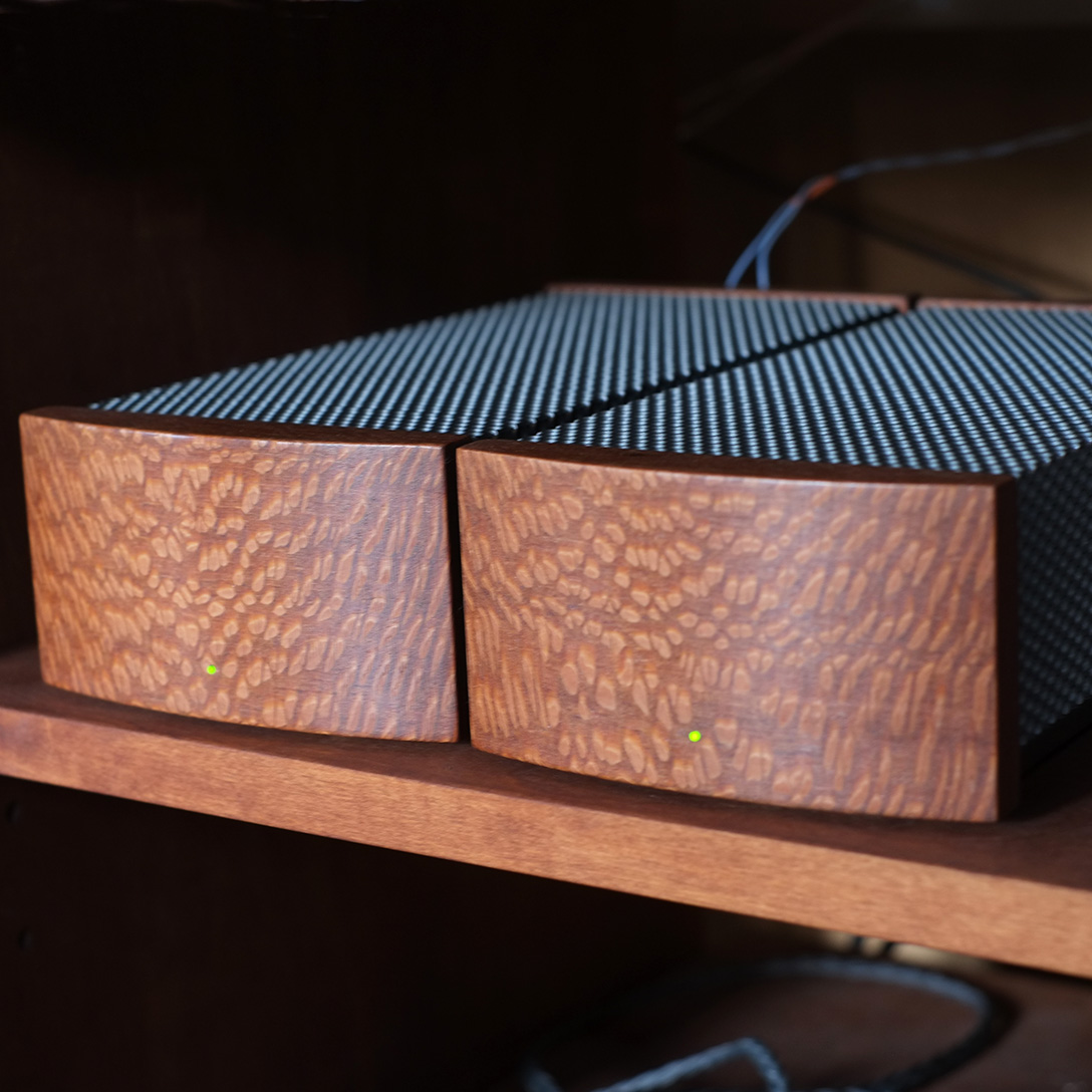

The amps have about 75 hours on them now—I'm really please with the sound.
Wow... picovolt, those are stunning!
I love the curved wood front panels and the Dynaco style cage. Super clean, very modern, but still a little retro.
Excellent internal layout as well. Everything looks pretty much spot on.
You've got a nack for industrial design!
