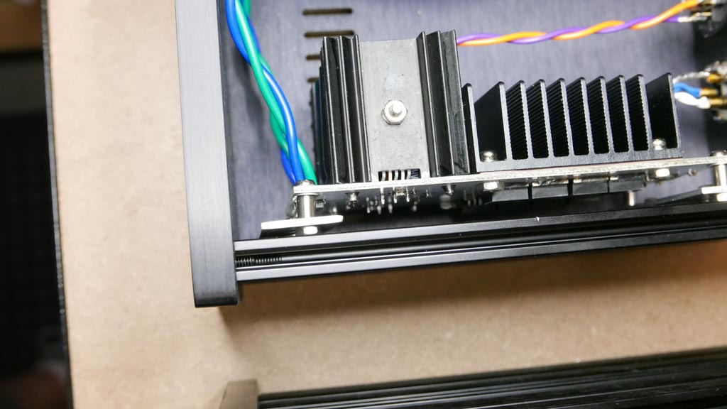

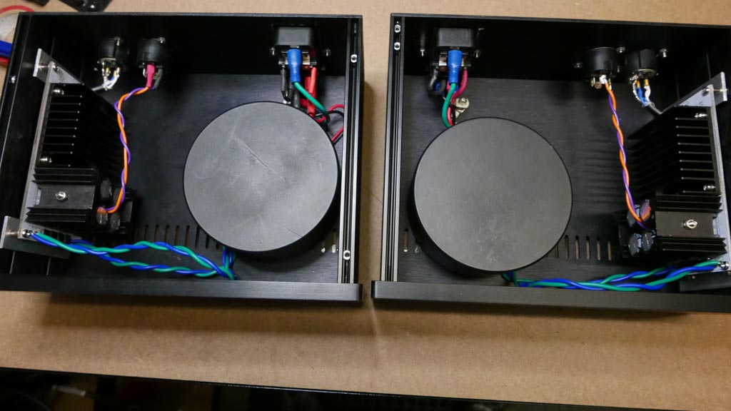

More LPUHPs live - I finally finished the mirror image to the one that I posted a pic of a few months ago.
The transformers are antek 50VA units in their steel cases. Enclosures are from modushop. Aim was for compact case with reasonable separation between mains+transformer and the amp. The mounting for the amps on the walls is fiddly but looks neat in the end, I think.

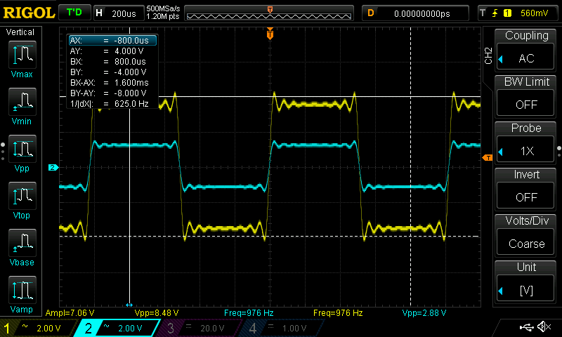

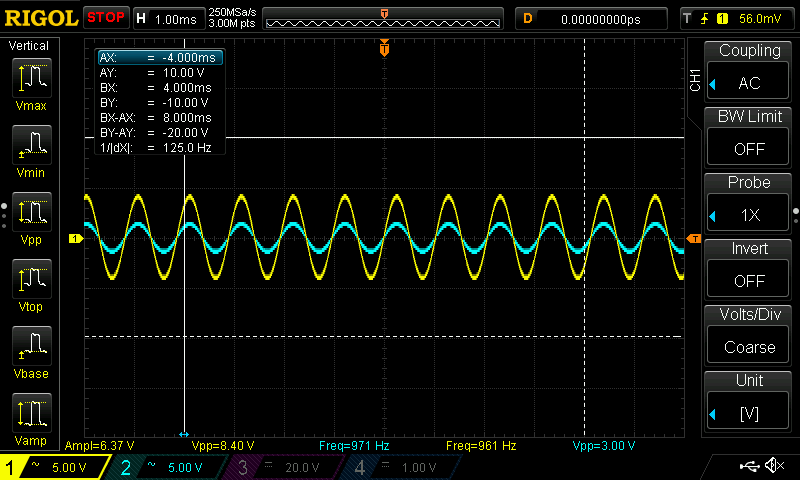

Looking at an SE input to BAL-BAL headphone amp (which feeds LPUHP BAL signal) then the output of LPUHP into a 9R dummy load.
1k sine
1k square
(this wasn't built for standard gain, the gain is correct for this build).
