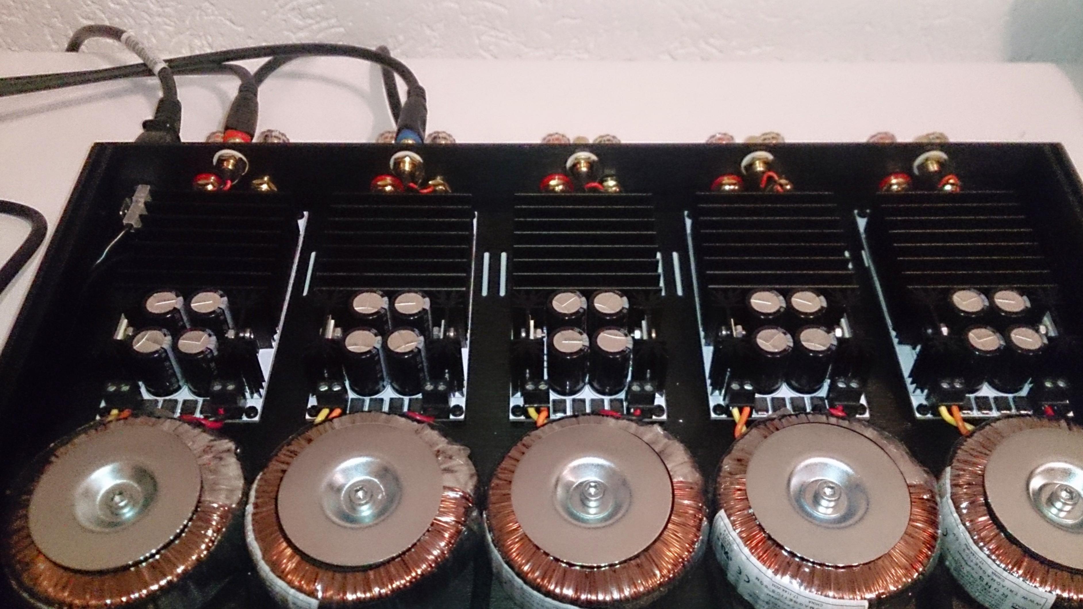

done a pair of those
slightly different from OPC design but I used his board.
added a DC servo s well.
they are the best diy amp I have ever done and few friends immediately asked me to build them a pair as well
those are good.
those are good.

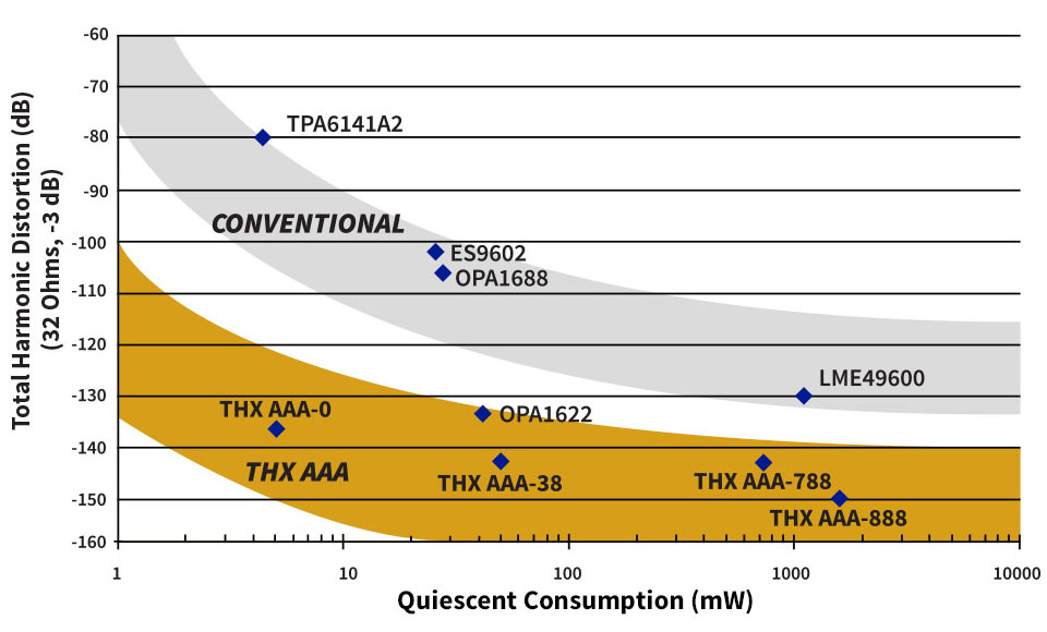

I dont believe you can use the THX chips in the same design as OPC's. The THX spec is a max 5.5Vdc supply voltage, 2 channels per chip. here is a link to the THX chip. I dont see any mention of a THX-AAA888. The big drawback for us old fat fingered half blind diy fellows is the chip is 2.5 x 2.5 mm, 25 bump wafer!
you will need a complete new design
TSTHX88 Amplifier IC - Triad Semiconductor
Hi pos,
Those parts are indeed interesting, and I appreciate the link! As multisync mentioned, they would not be a good candidate for the LPUHP due to the low maximum voltage, and dual channel / integrated design.
I'm also highly skeptical of the claims being made, especially since there are no measurements provided at all, and the "module" shown in the pictures I can find does not at all resemble a 25-bump WCSP. They make no mention of the measurement conditions, and the chart they provided doesn't really make much sense. They are comparing their part to the LME49600 which is a buffer, and fundamentally not the same thing as what they are pitching.
The LME49990 is rated at -140dB THD+N and a measurement is provided on the first page of the datasheet. The chart from THX claims -150dB THD only for the THX AAA-888. I would imagine the actual THD+N would fall well below what the LME49990 is capable of, especially considering the limited output voltage capabilities of the THX parts.
What all this means in the real world is probably moot. If I were to market the LPUHP in the same way THX seems to be marketing these parts, I would print the graph from the datasheet of the LME49990, claim "-140db THD+N!" and be done. Getting datasheet specified performance from a finished product is not so trivial, and it's generally misleading to imply a product has a given level of performance simply because it contains a part that has that performance under lab conditions. It will be interesting to see actual measurements when these products hit the market. If anyone wants to loan me one I'd be happy to measure it 🙂
