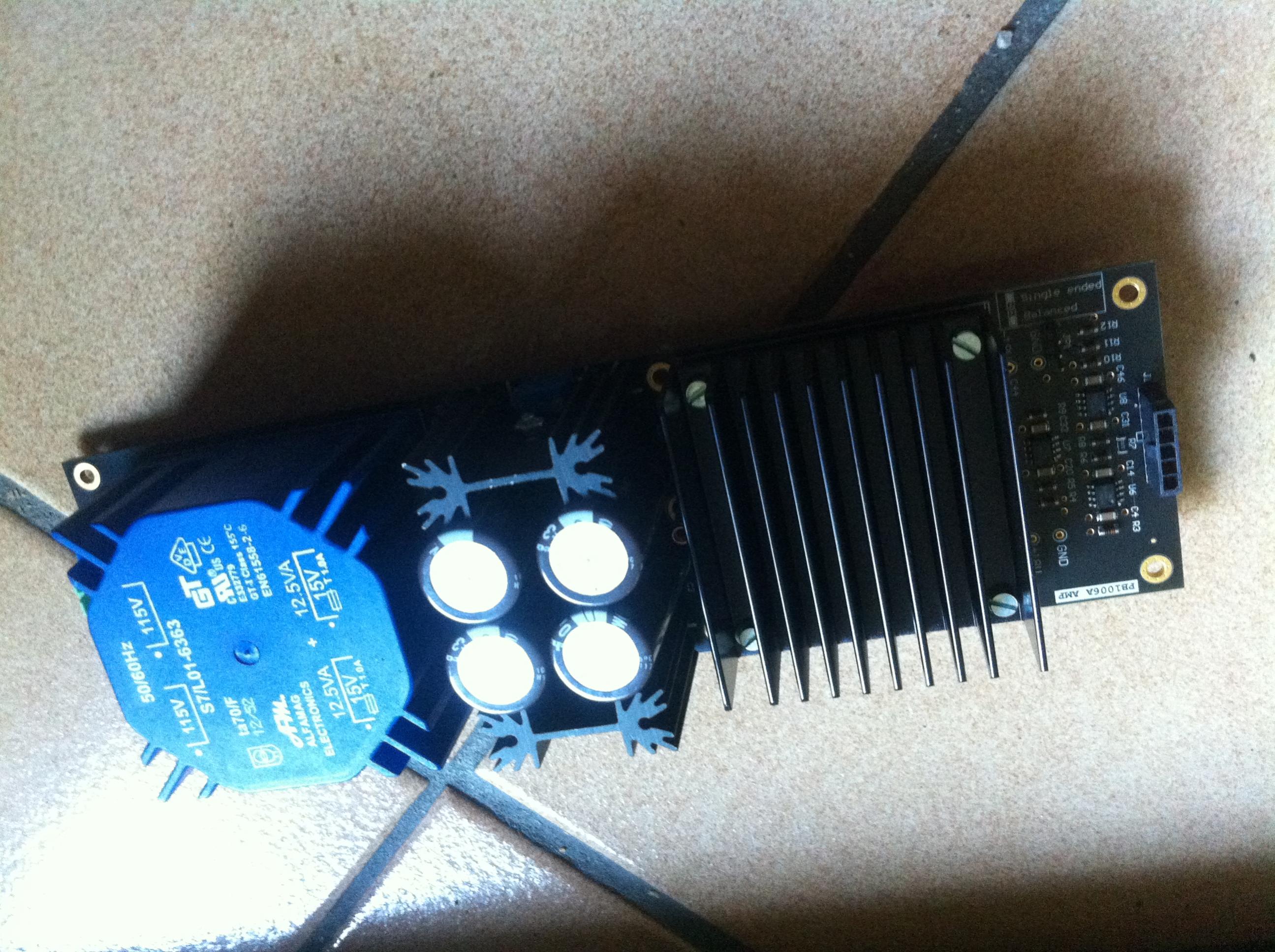

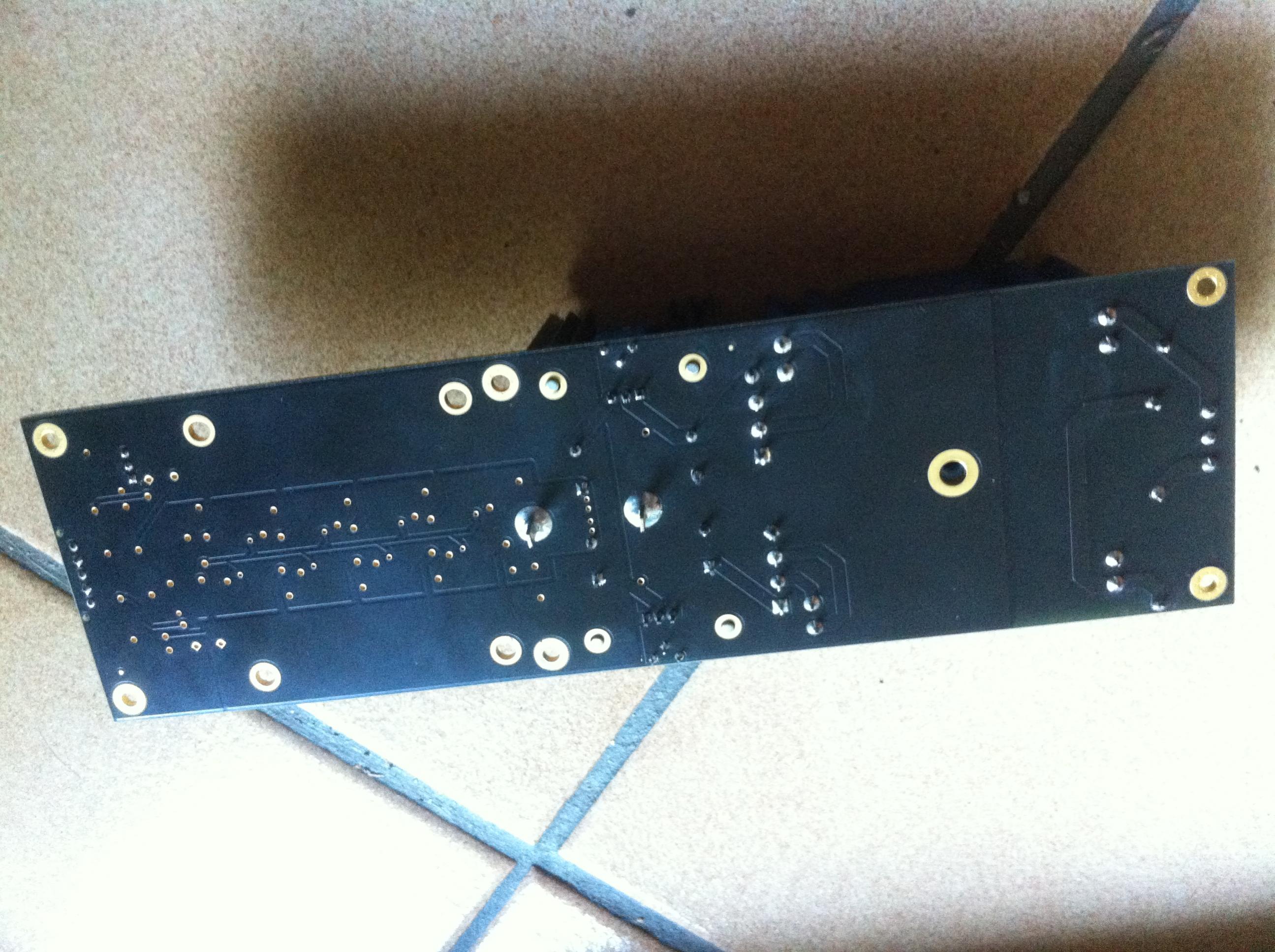

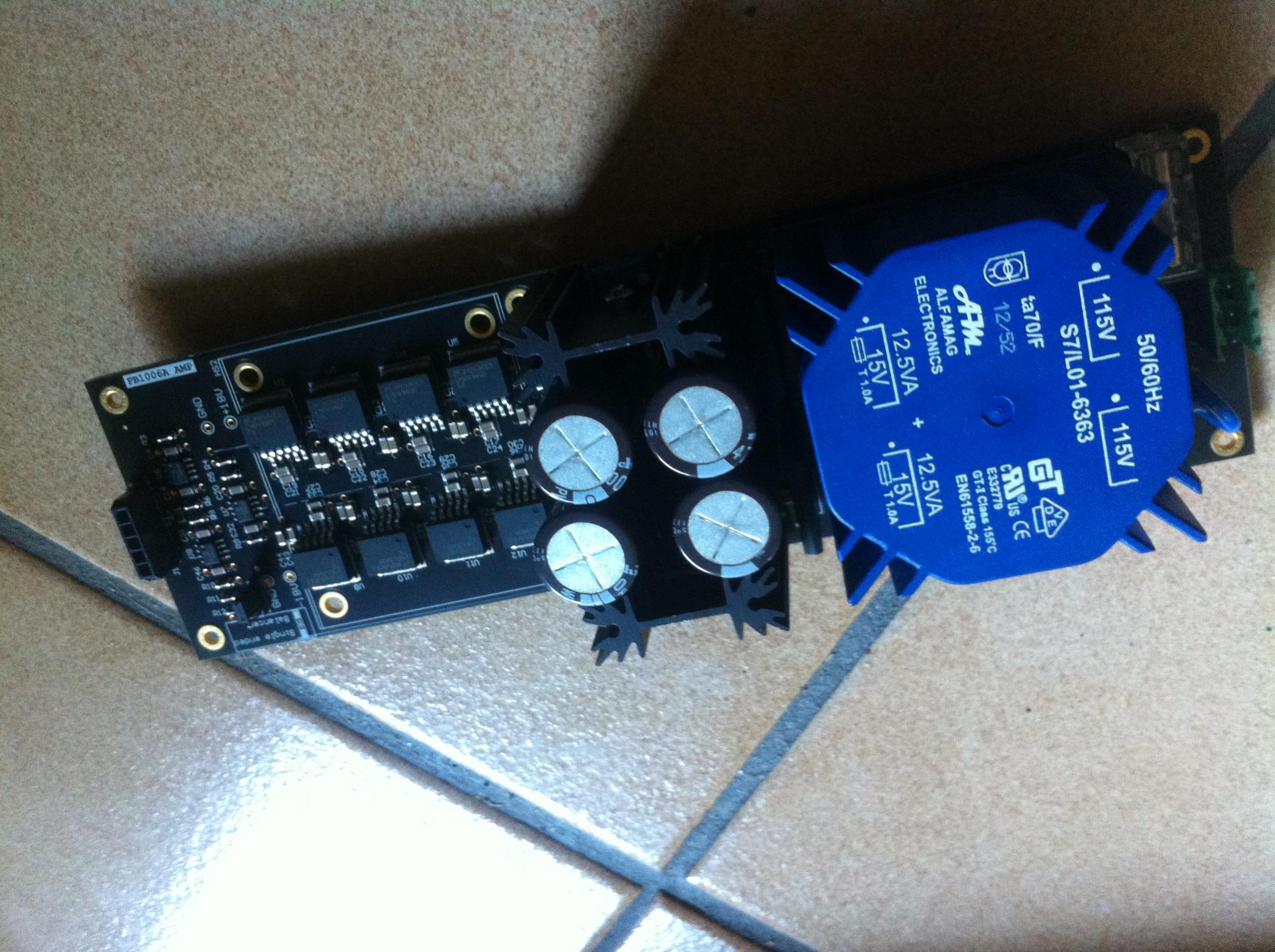

I missed out on the original pcbs (because I was fiddle farting around) so I quickly made a poor man's interpretation.
Fast forward to today and I finally got around to getting to listen to it: the lpuhp sounds wonderful!
The giant caps are there purely because I had them left over and thought it was a waste just to use them to warm my sock drawer.
The heat-sink... well I was vertically challenged and had space on an order to fill out.
Credit where credit is due, thanks Owen for such a cool concept all round 😎

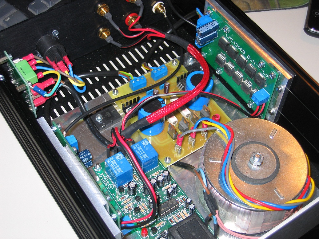

-Thanks, I don't like using single lm317 337s for currents over 1A so I used a "proper" regulator. The 7818/7918-combo takes the forst say 100mA and from that, the transistors help out on the current.
Nice to see I wasn't the only nut job trying to massively over sink little headphone buffers
-I read about the heat "issue" so I figured out a way of spreading the heat to the side panels. The IC's stay around 40 degrees Celsius.

-I was to late too. There are only small changes. Just a SE input so it's an opamp with 10 LME49600 followers for current. Feedback gain around is around 17.

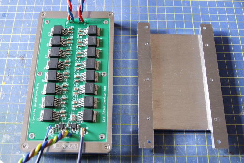

Cool, nice to see I'm not the only one having a go at making their own version of the LPUHP amp...
@ nattonrice & super: loving your builds, both look amazing & tidy.
Paul
Paul

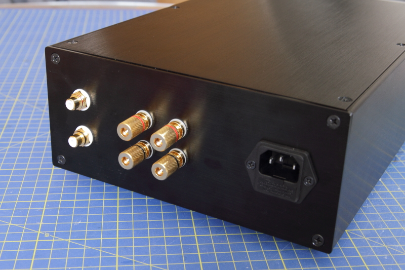

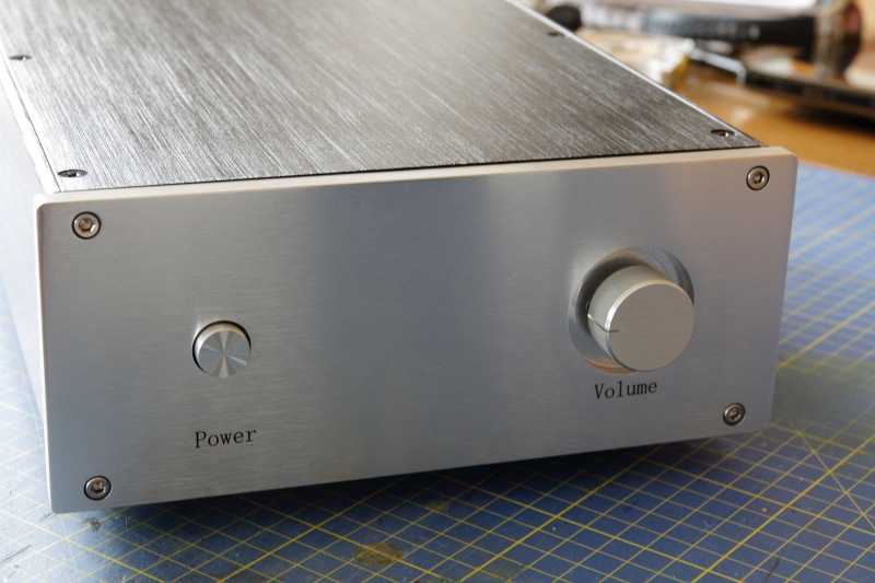

LPUHP; Variation on a Theme
Finally finished my variation on the LPUHP, a Low Power Desktop Amp [LPDA - acronyms are good 🙂 ]. This was my first attempt at designing a PCB and running through the whole fabrication process. A few basic mistakes along the way, however, I'm very happy to report it all works & sounds fantastic.
The final version is a se-se duel mono layout, kind of like a big "The Wire" se-se but based on the LPUHP schematic. Gain is set at x4 [12dB]. Offset as measured in situ <1mV on both channels 🙂
10hrs of listening so far using some home made Foam Board 3" FR speakers [which sound better than my Mission 750 LE's], and it all sounds fantastic.
Paul
