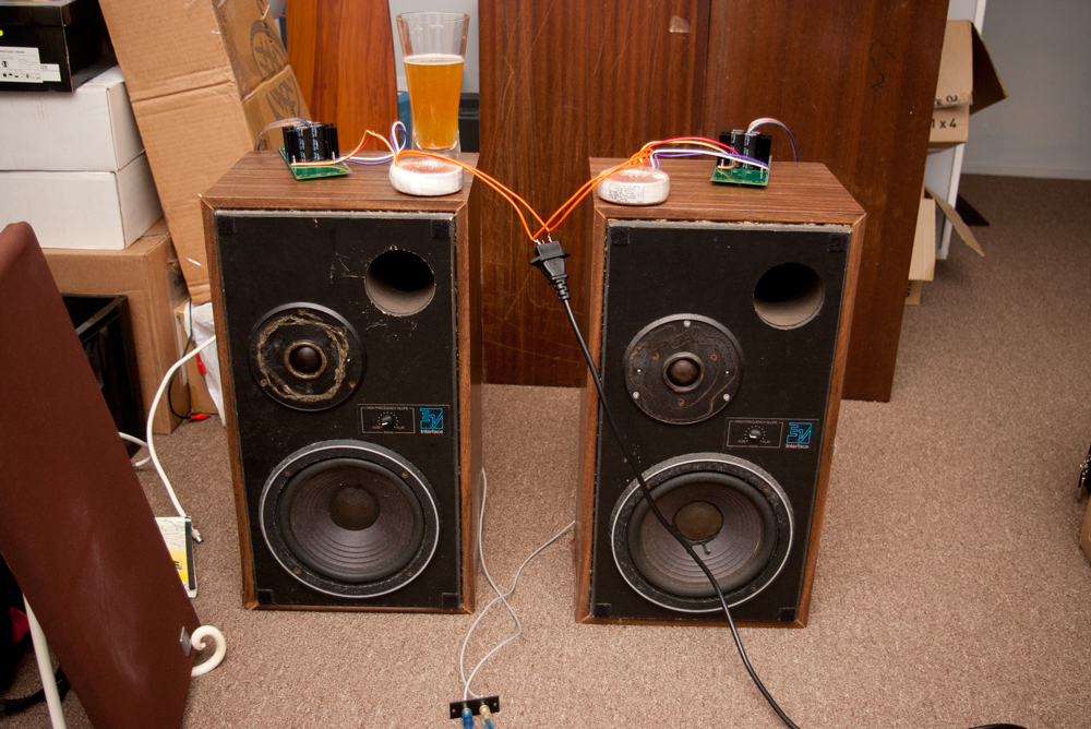

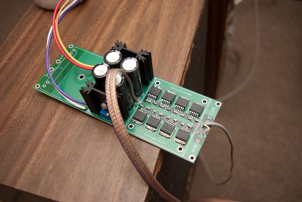

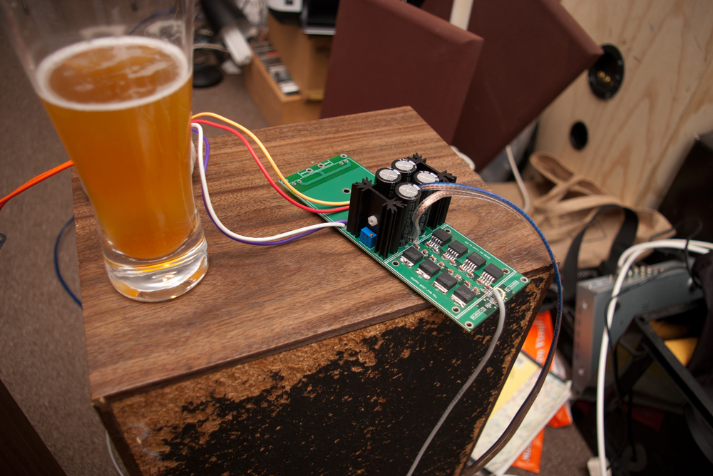

I now have the amps all together and connected to my highest sensitivity speakers for testing. 😀

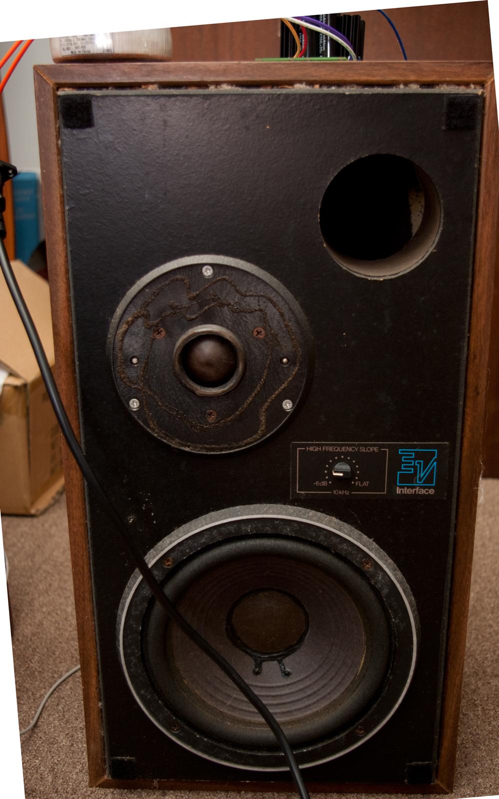

I forgot how beautiful these speakers sound 🙂 These little amps have no problems bringing the EVs up to decent levels.
I'm not the best at describing equipment but so far I can not fault these amps.
Time to sit back, have a glass of beer and listen to some good music
Thanks OPC for making the amps available! I am very happy with my pair.
