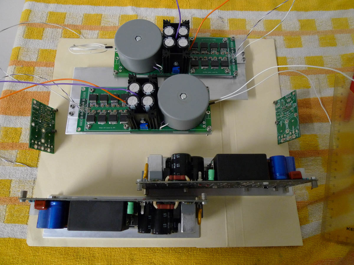

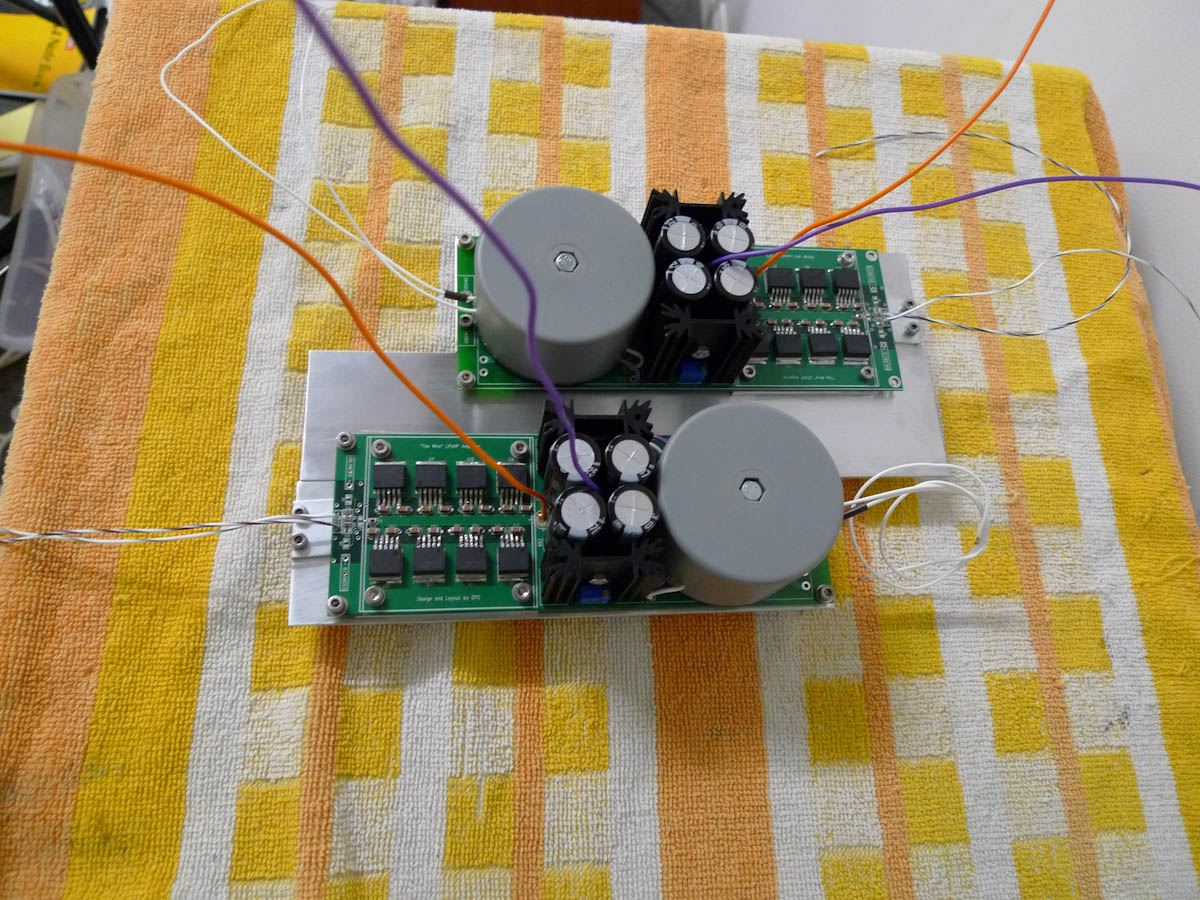

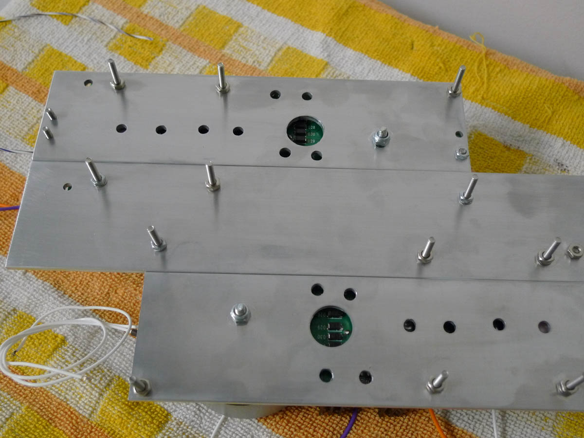

LPUHP underneath heat spreader complete ...
See attached pics 🙂
25mm wide, 3mm thick alu bars under each row of buffers. An extra 3mm bar under the sumr tx and a 1.6mm thick alu bar to draw heat from the opamp. Keratherm Red between alu and pcb/opamps and thermal paste between small alu bars and the 3 x 50mm wide, 3mm thick alu sheets that tie it all together.
For good measure I've included a gratuitous photo of my planned 4ch case layout with DPS600+lateral fet LME49830 Class AB The Wire amps. The manila folder is the same size as the available floor space.

Crikey! Those are some pimped out heatsinks!
Speed holes and all 😉
You'll definitely have the happiest buffers of the group.
Overall it's a very elegant solution to the heatsinking problem, which was something that took a lot of effort with the "production" version.
Keep up the good work!
