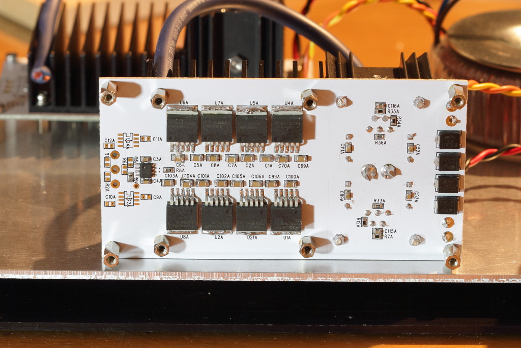

The results of th LPUHP amps look promising. I am using 4 of them in a bia-amping configuration to run a pair of elsinores. The 15 db version is about the perfect gain for these speakers with the DAC I am using.I will be comparing them to 4 My Ref C amps.
When they were initially turned on the LPUHP amps lacked presence in the treble and sounded muddy with not a lot of detail. Don't be dismayed though because just after a couple hours of burn in all that has changed. I think the LPUHP are going to be contenders for some excellent amps if they are paired with the right speakers. I am going to give them some more time to run in, then will be doing some a&b comparisons with the My Ref C.

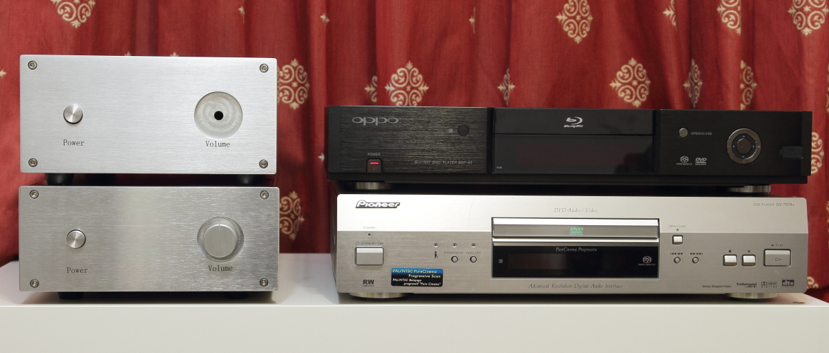

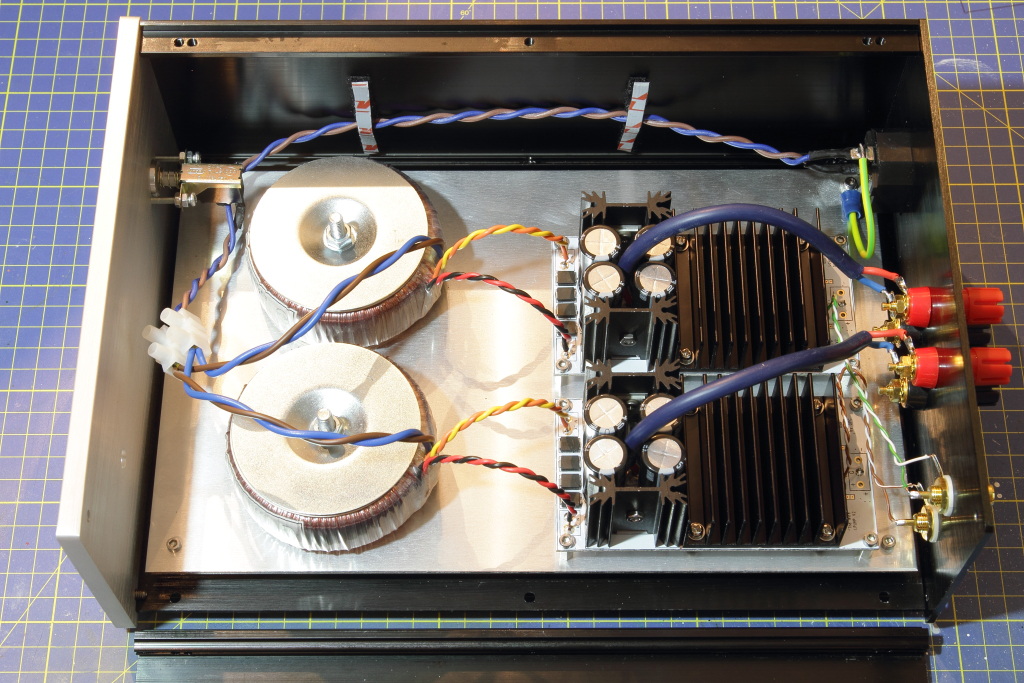

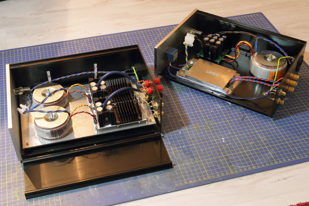

Build, Phase One
Phase one of my DSP/DAC > Amp > Speaker build is complete and has had its inaugural 3hr play 🙂
Used 2x15Vac 50VA transformers, gain set to 2.1 [~ 4Watt] for powering FH3 speakers fitted with Mark Audio Alpair 7.3 [6 Ohm] .
Pictures:
1... Good enough for me, just ignore the bit of tissue paper 😉
2... LPUHP along side a variation I built early last year... Will be using that to power the helper woofers I'm currently building.
3... Pretty tidy layout for me...
4... Clockwise. Oppo, Pioneer, Variation & LPUHP... Once the 2-way active front end is complete, I'll need to get some kind of insert for where the volume control should be on the two amp enclosures.

That is an absolutely fantastic build!
I wish mine were as nicely cased up 🙂
Chassis layout is fantastic, not too big, but plenty of room to breathe. Fully dual mono, AC power wires kept well away, and it's all neat and tidy!
I plan to do something just like this but with balanced inputs and a chassis that probably won't look that nice 😉
Let us know how it sounds once you've got some hours on it!

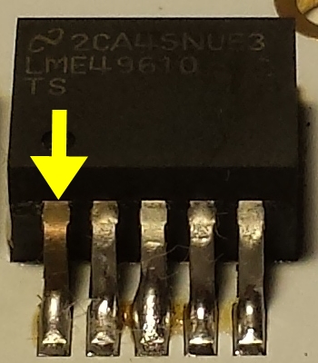

I have a question about the LME49610TS. I have soldered a bunch of these with a hot air station at approx. 350c temperature. I have noticed a couple have a copper color on the very first pin. Does this mean I overheated them and burned something? Is there a way to tell without powering up? Here is a picture of one in question. Thanks.
Looks to have melted the plating off, to the base metal, Cu perhaps.
Suggest to use the fine tipped nozzle and focus on the land area.

Looks like a little bit of solder wick required for pin 3 🙂
Have to be cautious of de-lamination when you see this.

My hot air station is a 858D, and I used the fine tip nozzle. I think it started to happen when I started heating up the ground plane, ensuring all of the solder was melted underneath and watching the flux come out and flow freely.
Do you think it's ok? Should I use a lower temp than 350c?
If it is working, it must be okay, I guess ? 🙂Do you think it's ok?
Depends on solder type, temp and airflow.Should I use a lower temp than 350c?
In my SMT soldering technique, I hand solder everything, under 10x mag using 15 mil no-clean glow core eutectic solder. Very little pkg stress. I only use the hot air machine to remove comp's or re-flow very small areas.
