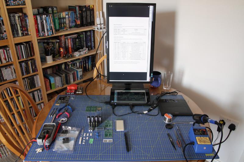

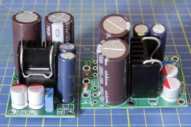

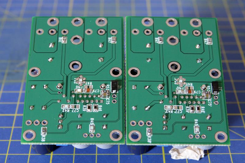

Well I was going to wait until next weeks bank holiday but I couldn't resist putting the two boards together.
Due to putting my apartment up for sale, just about all building and buying bits is on hold. Could be 1 month or 1 year before I get to start on the amp again 🙁
1 - ready to go with the schematic and build guid on display.
2 - base, the LME isn't fully soldered.
3 - top, going with SE AC coupled input.
