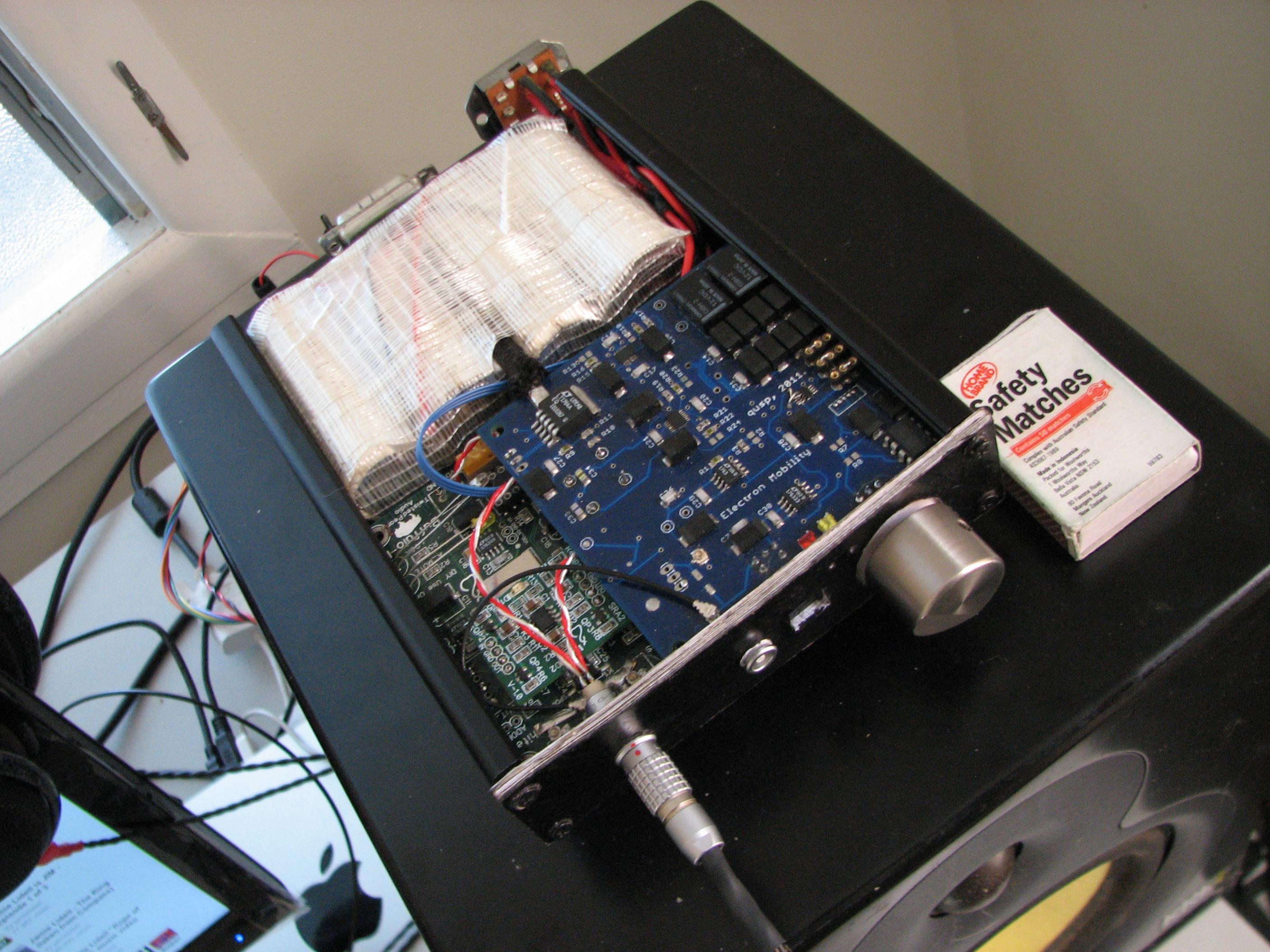

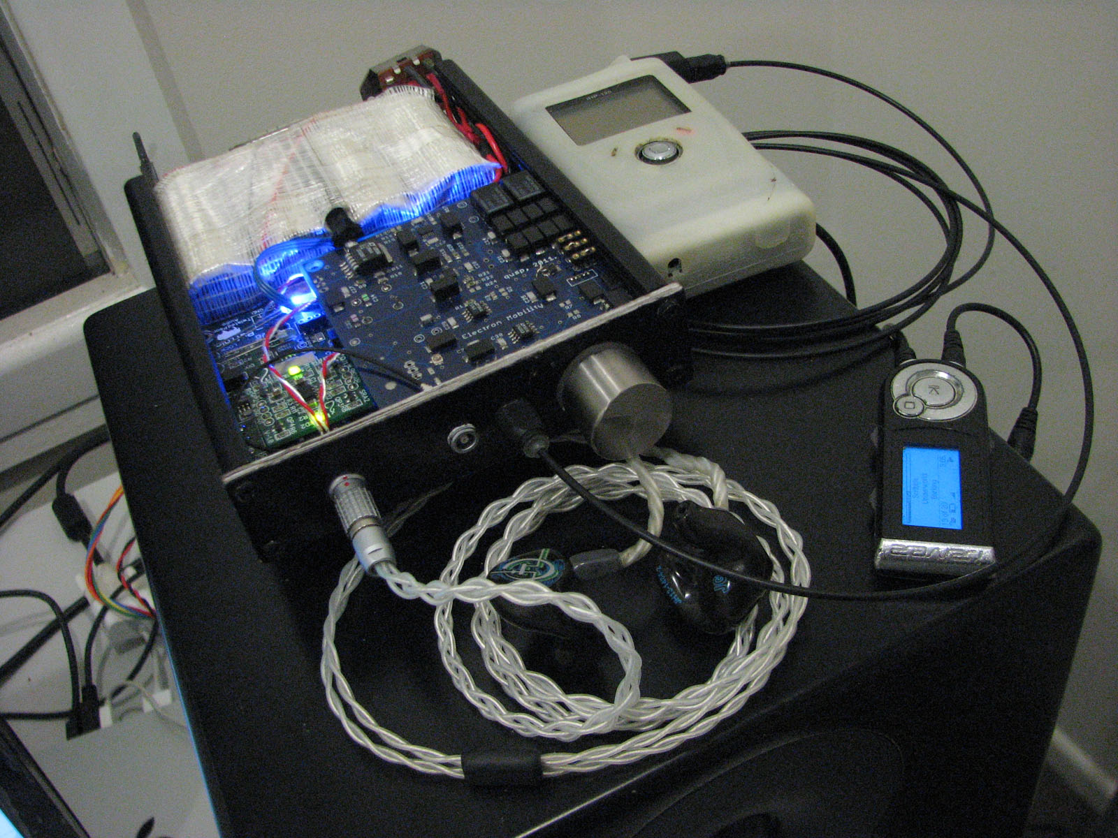

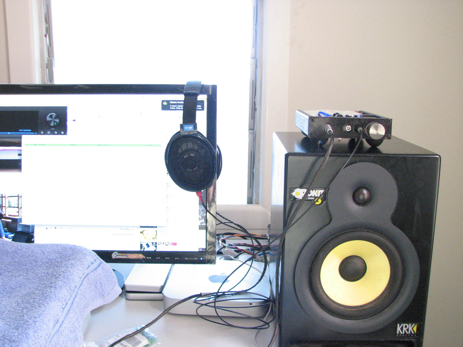

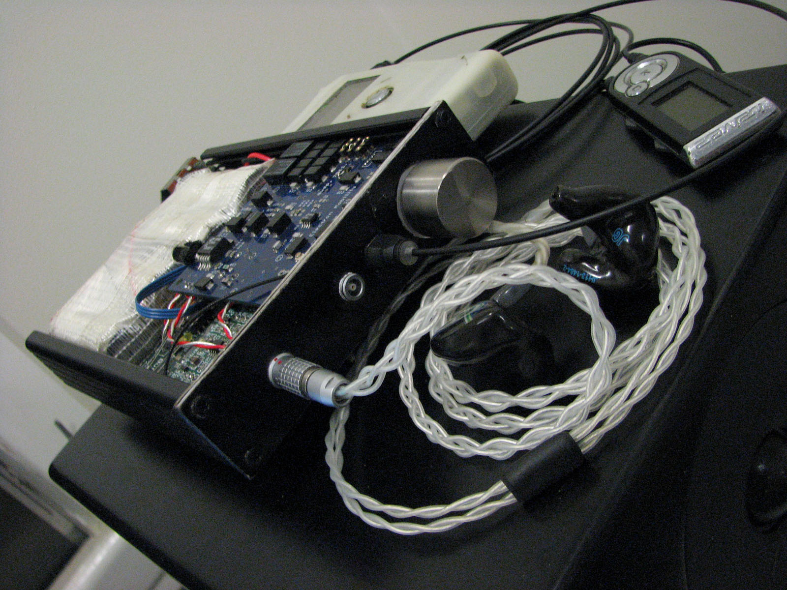

not complete, but the electronics are. the bal-bal the wire is hiding under the 4 layer regulator/batt monitor/digi volume control/toslink board.
thanks nattonrice! for the layout

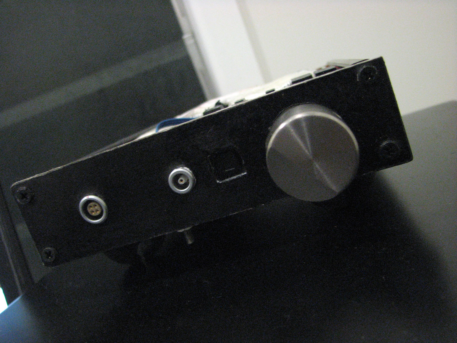

as you can see the buff II has been modified for low profile as well, solid titanium volume knob, lemo connectors, amphenol multicore battery balance/charge cable (will get some pics for that, looks sweet) dual bipolar low noise regulators for the bal-bal front end, direct power for the buffers from the 4 x A123 LiFePO4 2300mAh battery and soon i'll add a converted SE-SE the wire fed with low noise reference as the regulator for the clock
transformer coupled spdif underneath, lt1963A for prereg for the BII, a couple more regs for good measure...
