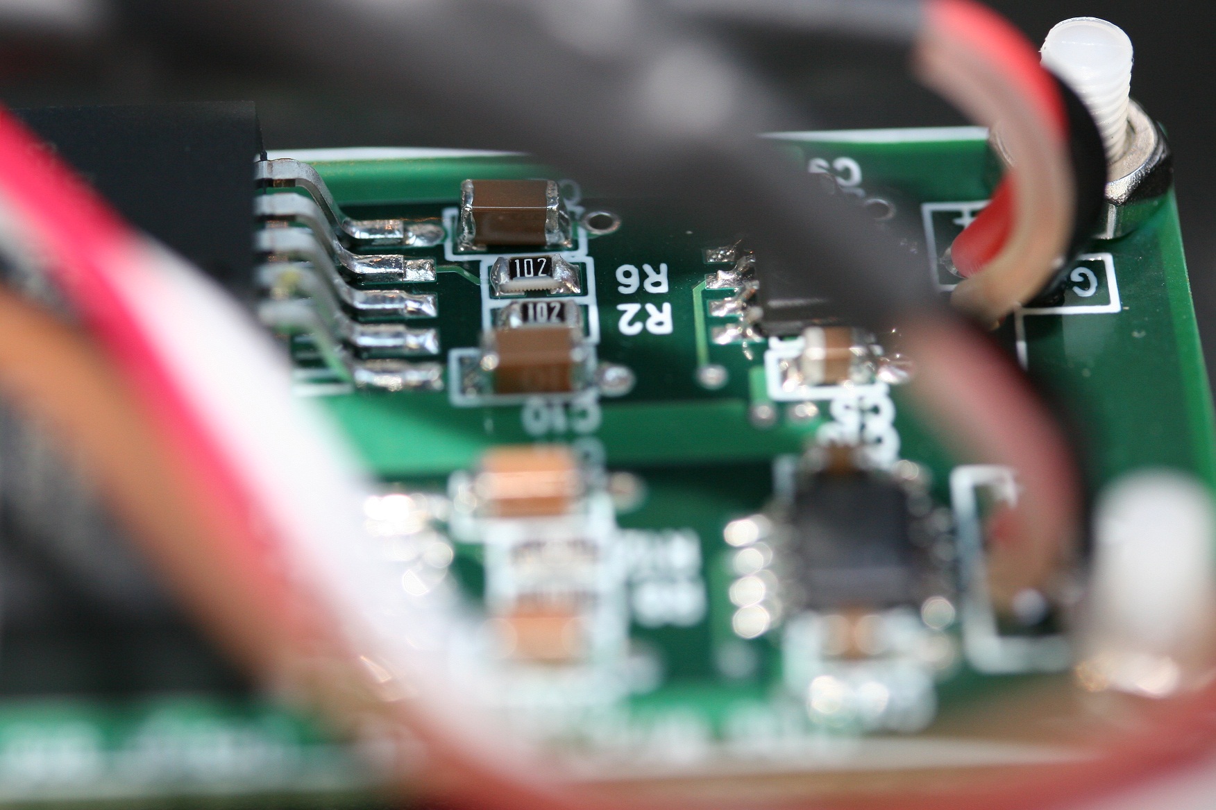

The boards look great, and soldering is top notch. Thanks for posting the pictures, and you'll have to keep up to date on the rest of the build when it materializes.

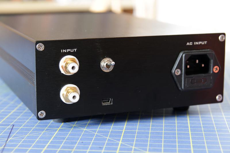

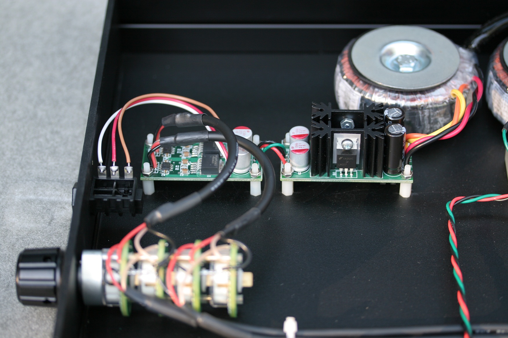

Odac and The Wire

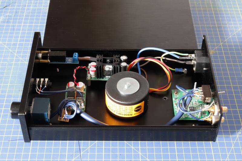

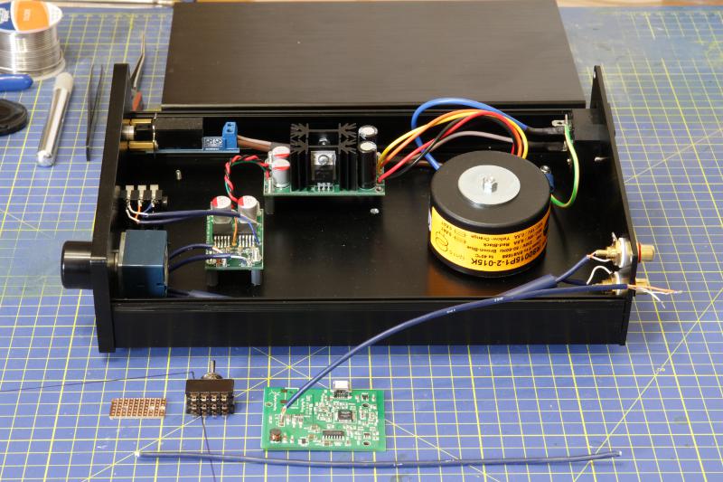

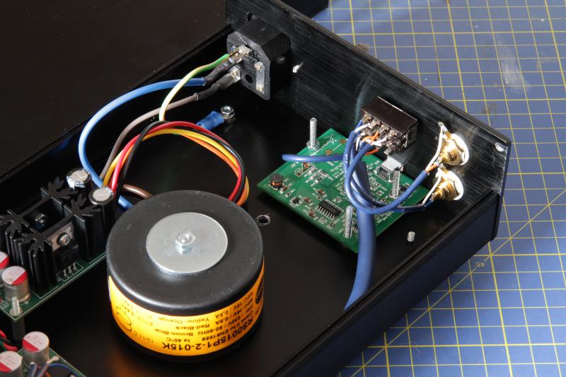

Well I spent yesterday [Sunday] afternoon fitting the Odac into the chassis and hooking up switched inputs.
The toroidal transformer needed to be moved more centrally to allow room at the rear of the case for the dac. A 4PDT [on-on] switch was used as an input selector and allows A/B switching between sources.
A small piece of pref-board was used to try and make the job of wiring the input to potentiometer to amp a little easier.
The very small difference in noticed between the Odac and Pioneer [better], apears to have gone now it's fully connected. I'm sure if I try hard enough I can find some subjective difference between the two 🙂
Paul

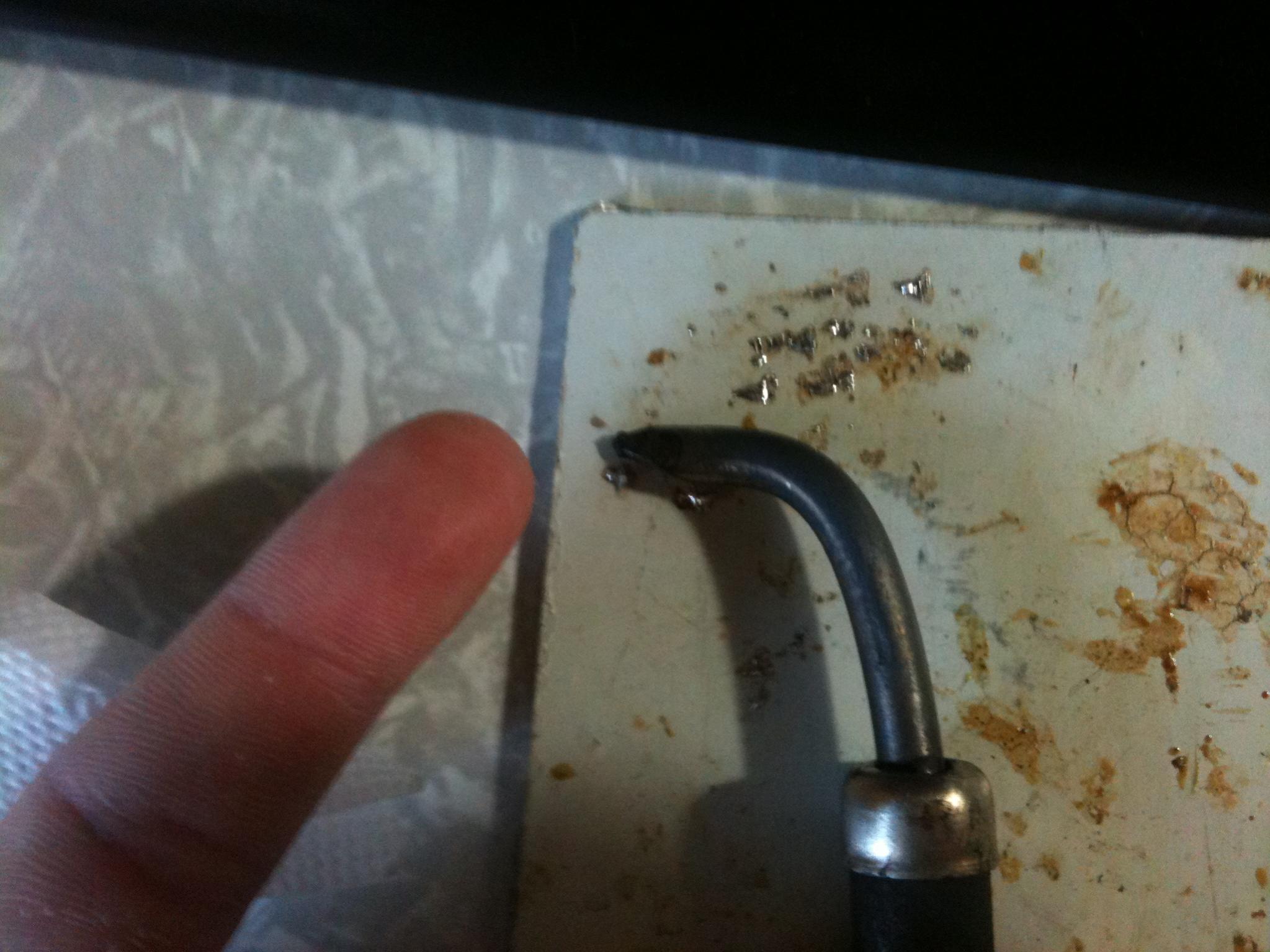

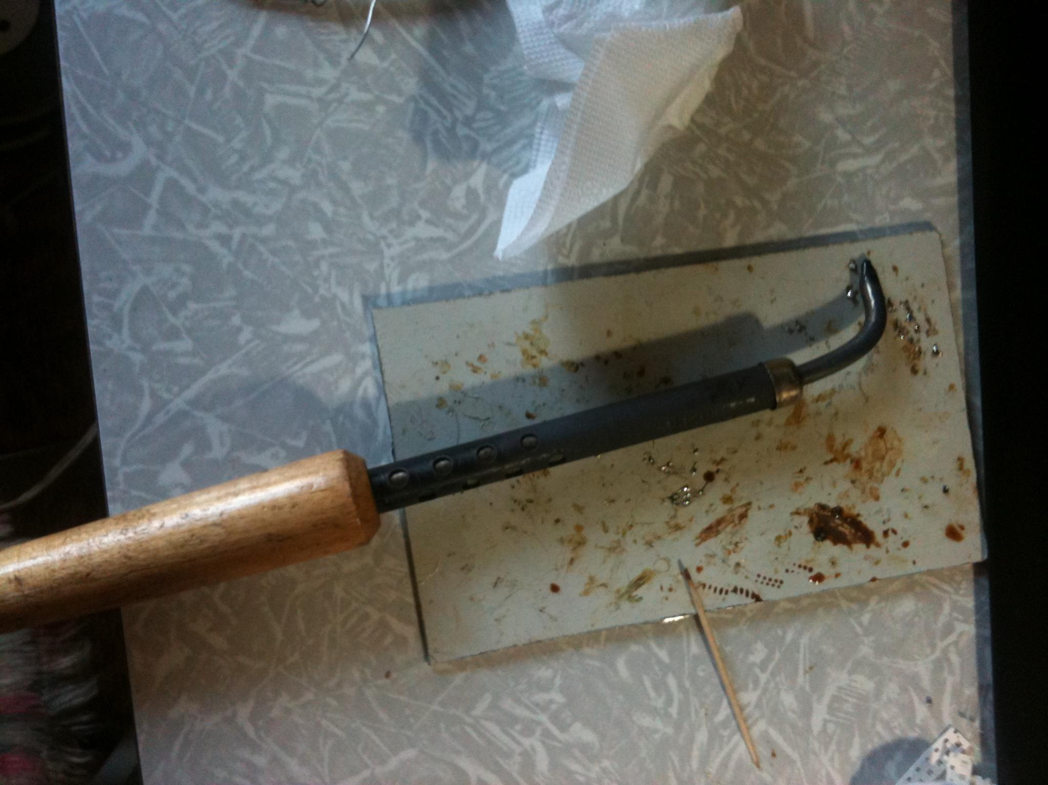

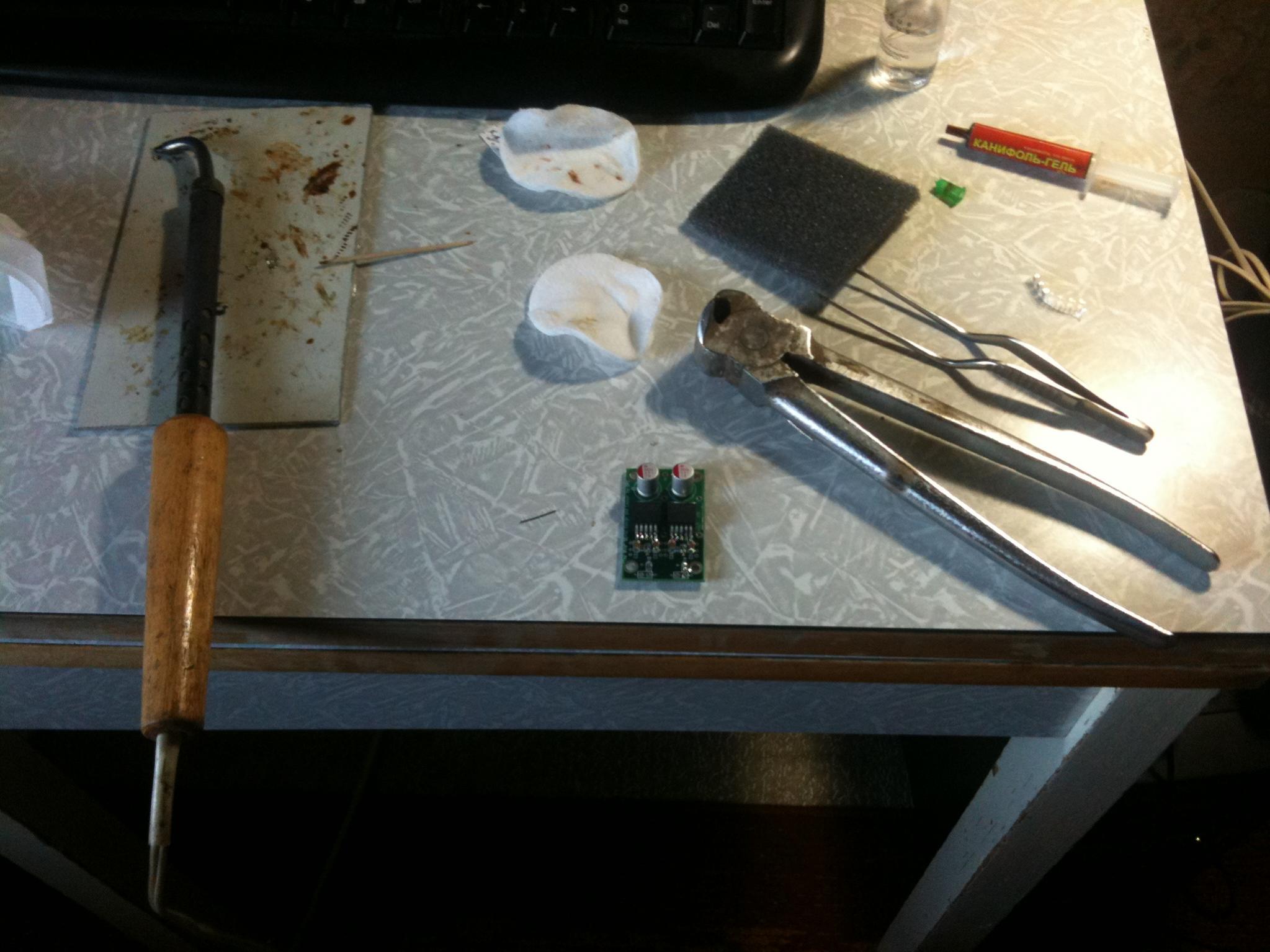

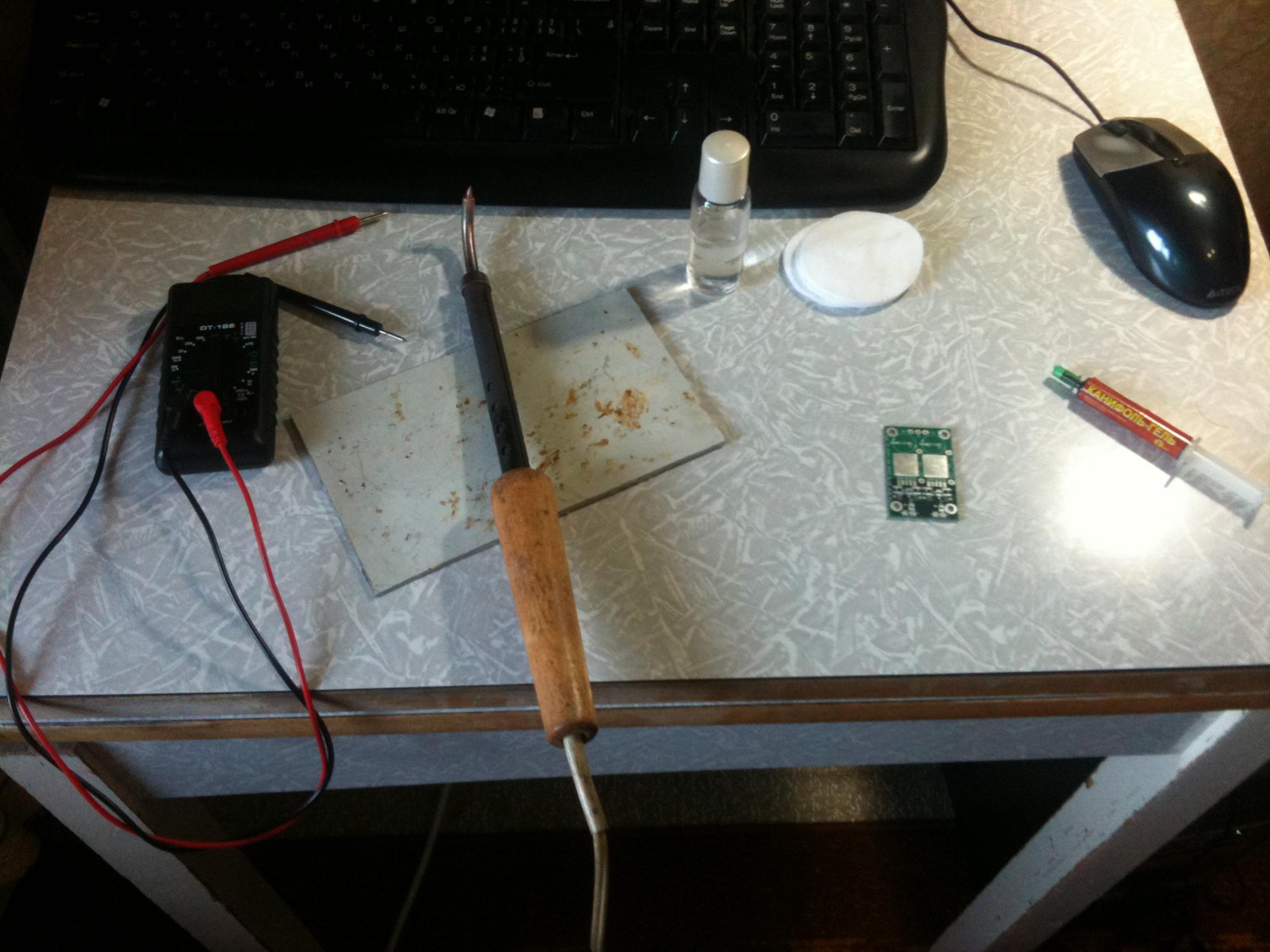

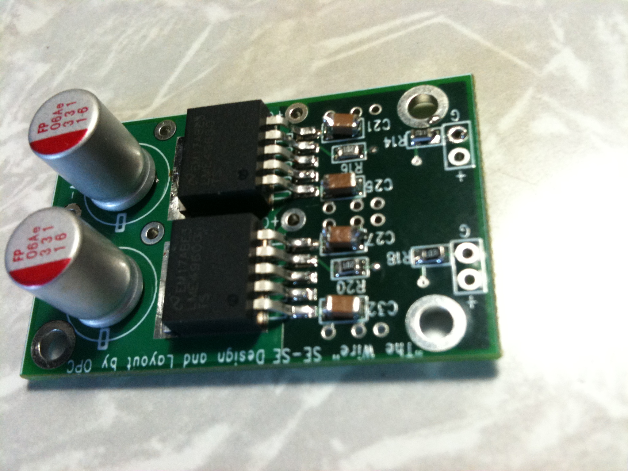

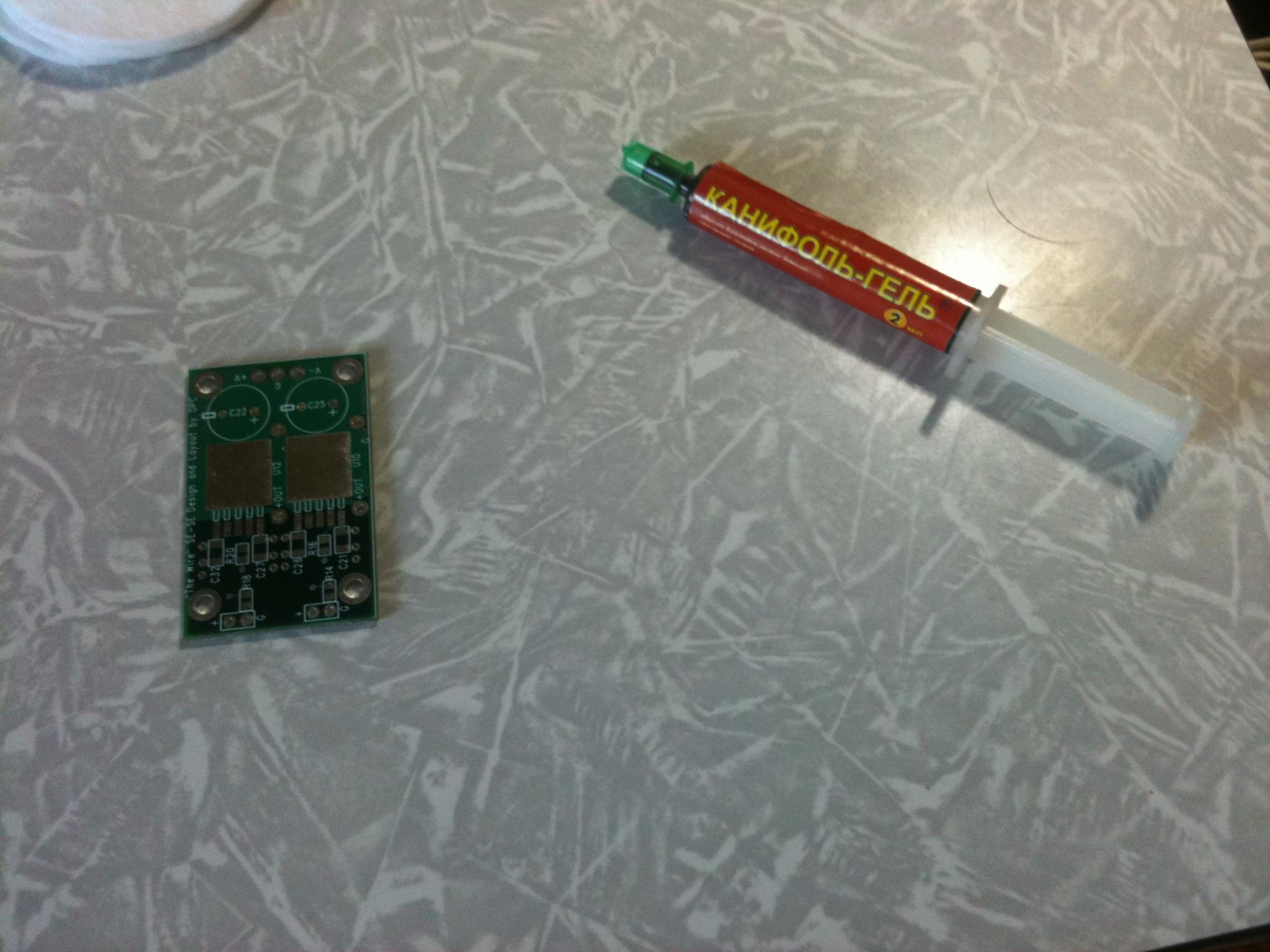

Today soldered The Wire Se-Se! It was a tough job with thick soldering iron I have at hand. It took me 3 hours to finish the process. Tested finished PCB with DM, and all seems fine. Probably will do real testing little bit later this week.

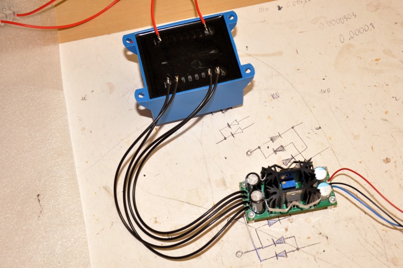

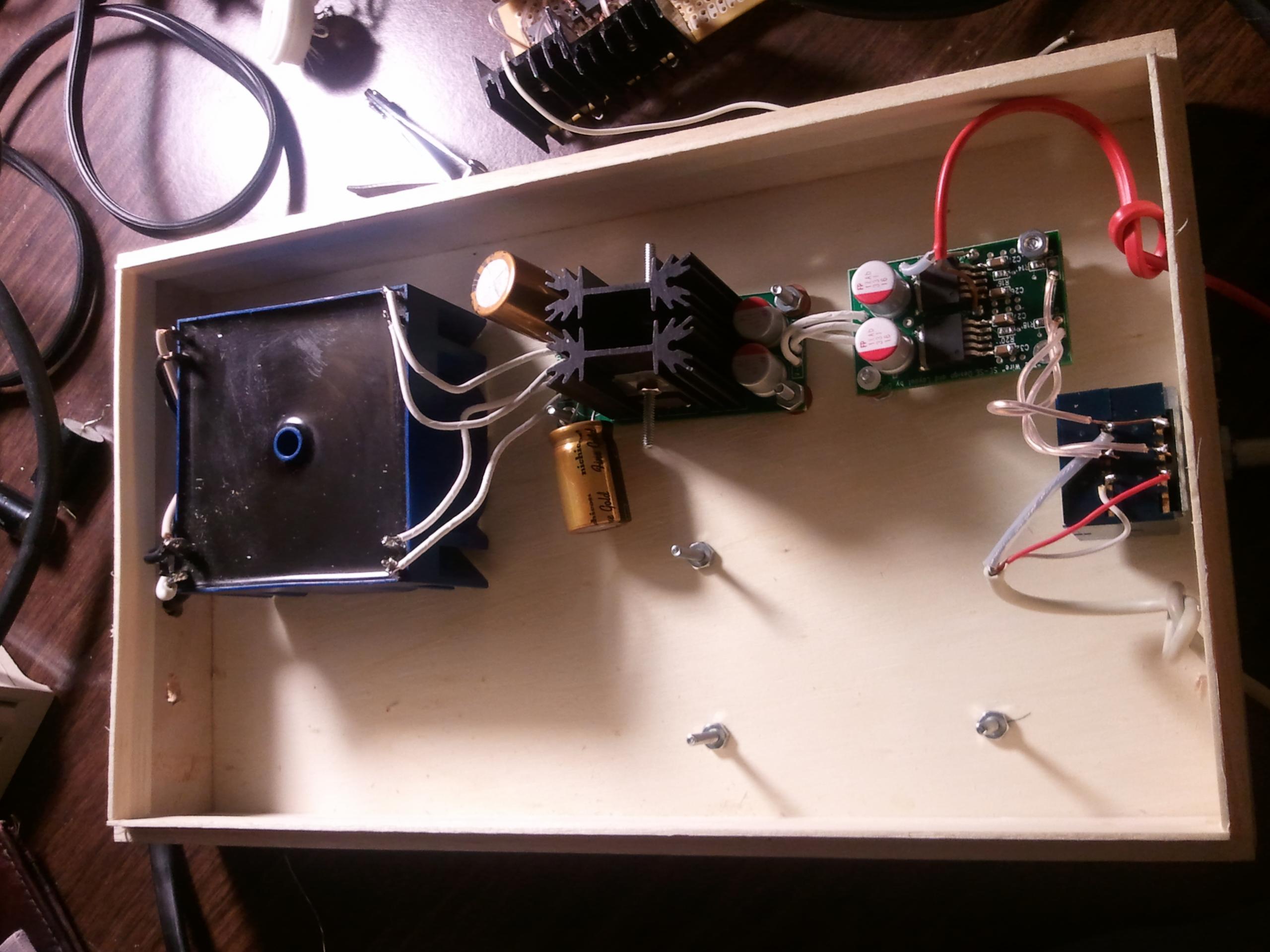

To keep this thread going I want to tell you guys that my (assembled) SE-SE board that I got in the 'Clean Out Everything Sale' now has a working psu to go with it.
The rest will take a little while more since I couldn't resist to create a fine case or housing for a fine amplifier (and I haven't even heard it 😀😀). PSU will be in a separate case connected by short umbilical... a few weeks from now 😉.

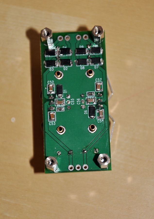

Finally managed to pull the thumb out of the famous darknes, so now is my Bal-Se finally singing.😀
So now I just need to get it into some nice chassi, and give it a considerable amount of burn in.😉

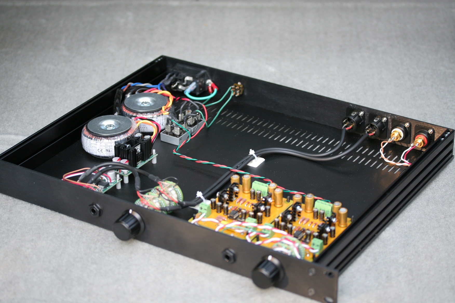

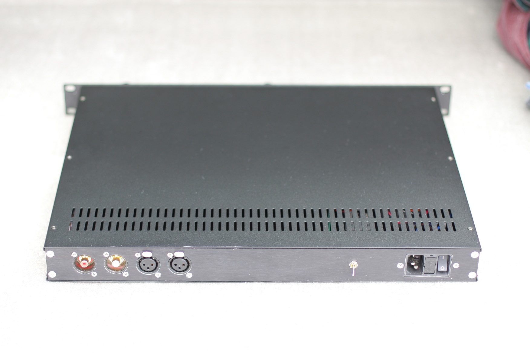

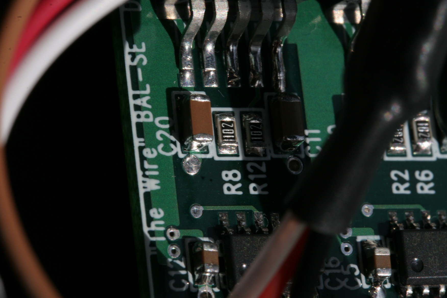

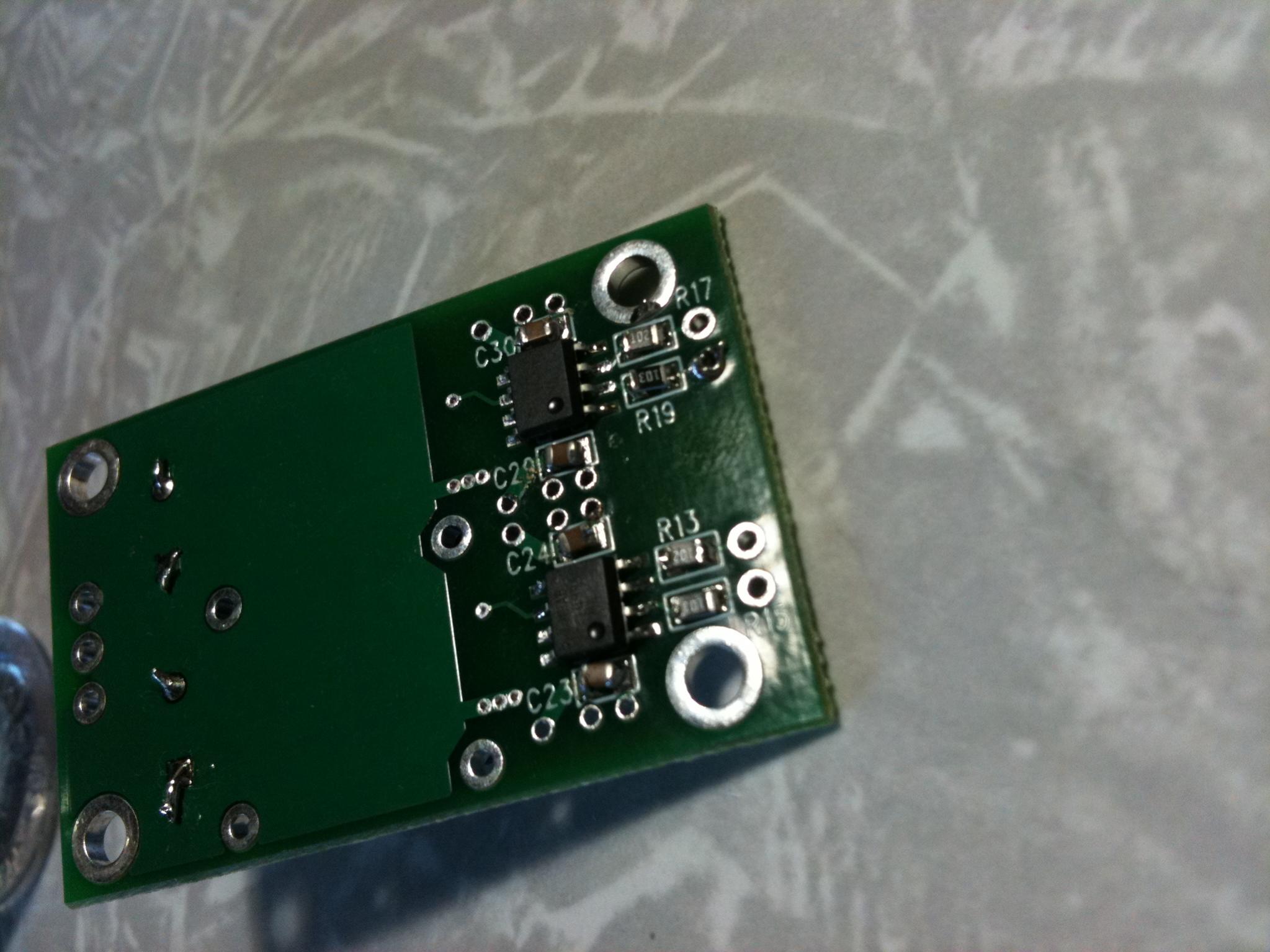

My first attempt working with SMDs. A Bal-SE version of The Wire with a PSU and a Sapphire in a 19" rackmount case. Pots are 10k.
RR
RR
Absolutely stunning! Now that's a finished project to be proud of 🙂
I honestly can't see a single thing that could be improved. You managed a great layout, that looks like an excellent balanced stepped attenuator, and you kept the output run nice and short with the transformer a decent distance from the board itself.
Kudos on the great work
You'll have to report back with listening impressions when you get around to it.

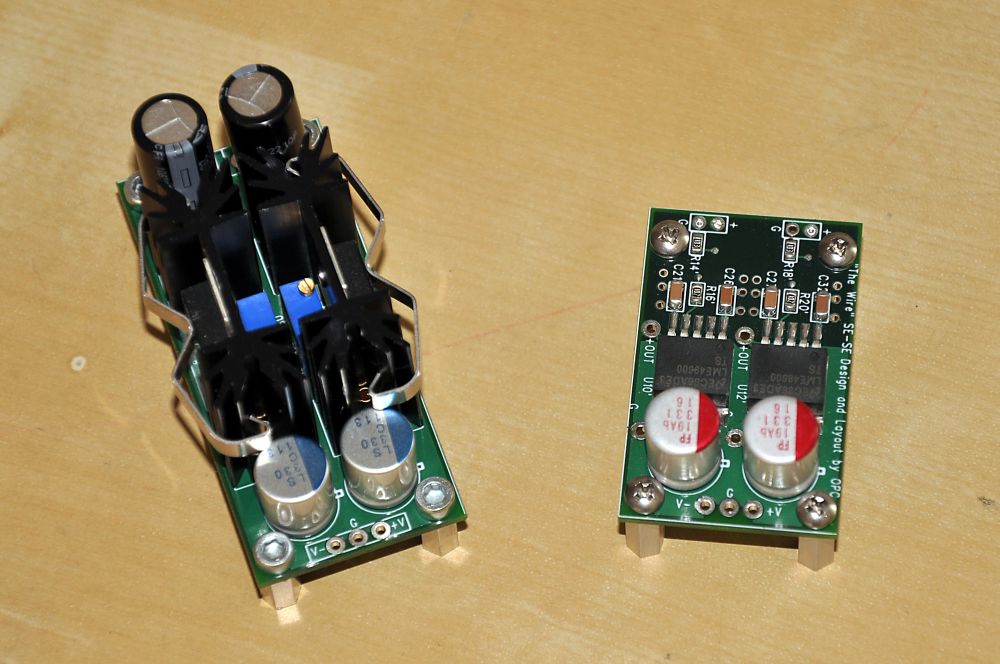

Built up a second Wire & psu's last week, so while the iron was hot I replaced the 1K input resistors on my original build with 0R jumpers [used with an Alps RK27 10K pot]... Overall volume has increased slightly and it appears to have opened up the dynamic range of recordings a little more.
This last month I've been using The Wire for listening duties with movies also... the DD & DTS high-def tracks are amazing, shame I don't get this level of detailing from my AV amp. The fan on the projector probably doesn't help here either...
Over all am super happy with The Wire

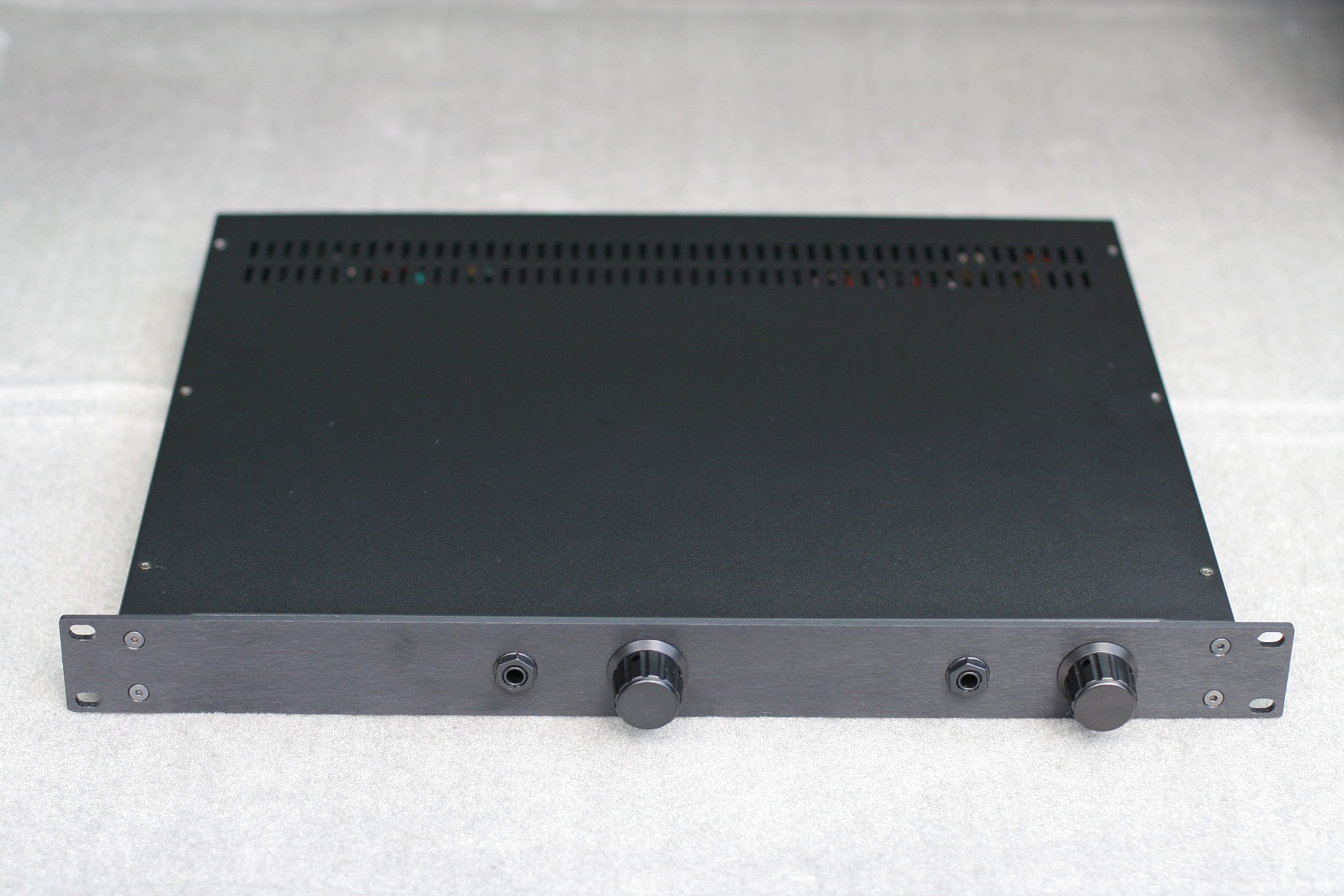

Finally finished my SE-SE. Bought a custom case from eBay and I'm quite happy. My only wish was that the amp was smaller but my choice for a power supply dictated a slightly larger case. Anyhow, things are going quite swimmingly with the amp. Here's some pics...
