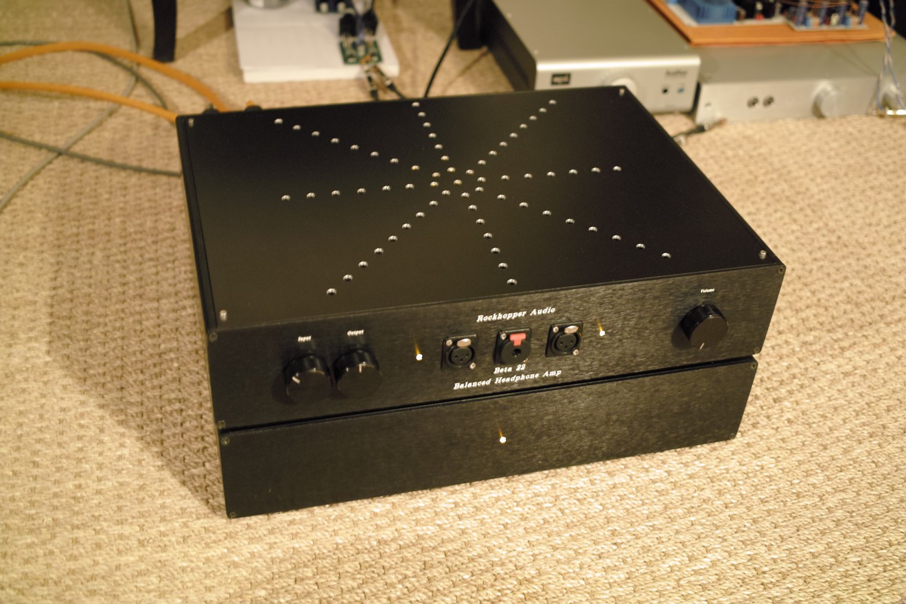

Comparing the Wire to the Beta22 was interesting, as they have a very similar character, trending towards strength and boldness rather than suppleness and delicacy. The wire is a bit more energetic in the treble, which I think is truer to the source since the Beta22 has a tendency to sound a bit warm and soft in this particular area. But the Beta22 takes the lead on other departments; it has better soundstage, separation, smoothness, and the ability to "disappear" - meaning you don't have the feeling to listen to an amplifier anymore.
Comparison with the Hypa-300SE yielded similar findings: the fluidity, clarity, and life-like character of the discrete preamplifier won over the slightly more rigorous but also more constricted reproduction of the Wire.
Overall, the difference is subtle and only noticed on the long-run. This difference, if I had to sum up, is the ability to hear deeper in the recording.
It is surprising that I have not found this quality to be directly related to neutrality; I would say that the Wire is probably the most neutral (in terms of subjective frequency balance) compared to the Beta22 (warmer), the Dispre2 (cooler), or the Hypa-300SE (livelier), but those latter, despite their slight deviation from neutrality, do provide to various degrees this inner resolution I am looking for.

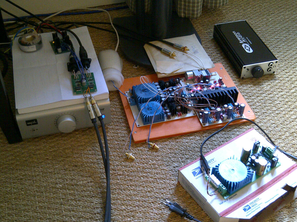

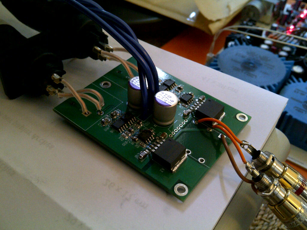

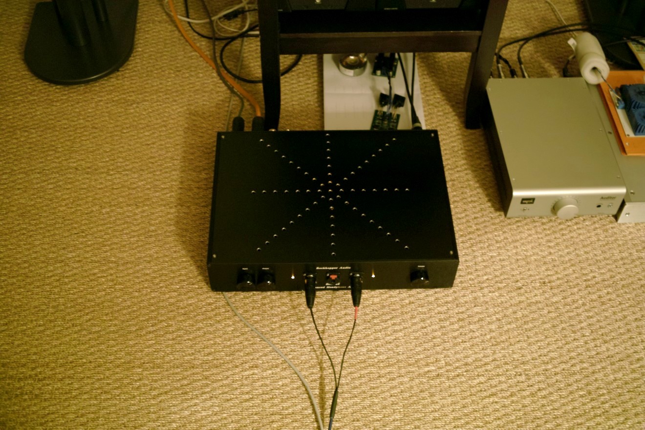

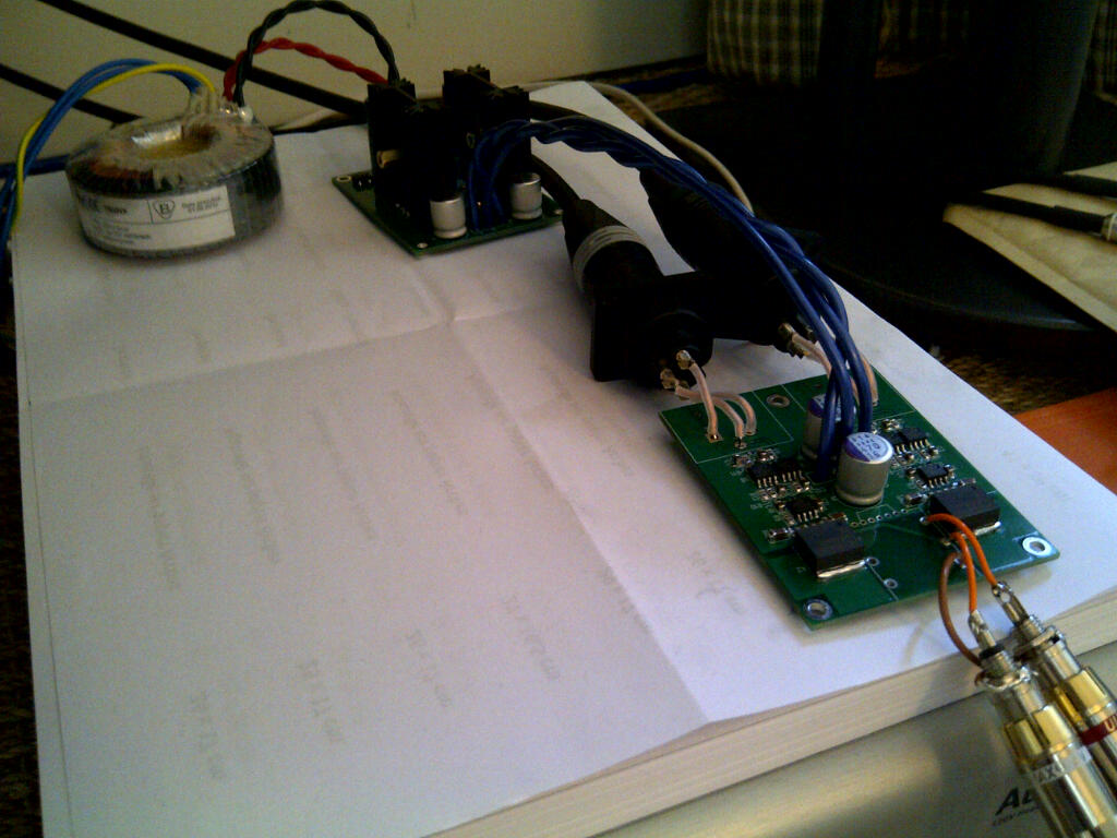

First impressions - part 2
IanAs, I used the Bal-SE version of the first batch of the Wire (see pictures below).
Sek, the power is provided by one PSU board, configured to output +/- 14VDC. I use a 20VA shielded transformer made by Toroidy according to my specifications, which provides 2x15VAC to the psu board.
The SPL Auditor performs very well. It is quite neutral, but a bit muscular sounding, with a typical v-shaped frequency balanced, with strong bass and a slightly lively treble. The soundstage is absolutely spectacluar with high impedance phones. Midrange, especially voices, can sound a bit astringent. Very impressive overall, if not a little too demonstrative. I would say the Wire is probably even more neutral (without this V-shaped frequency balance), tighter, less expansive, and overall a bit more true to the source, although a bit flatter and perhaps not as delicate in the treble.
I have listened to a fair amont of headphone amplifiers, and the Wire definitely belongs to the best. It only proves its limitations in comparison with more complex and expensive designs. Furthermore, my impressions could very well vary over time, as I will continue to listen to the Wire with pleasure. I have no hesitation to recommend it as an excellent pre/HP-amp.
Below, some pictures of the bunch, including the Wire, Dispre2, Hypa-300SE, SPL Auditor, Avenson headamp, Beta22.
