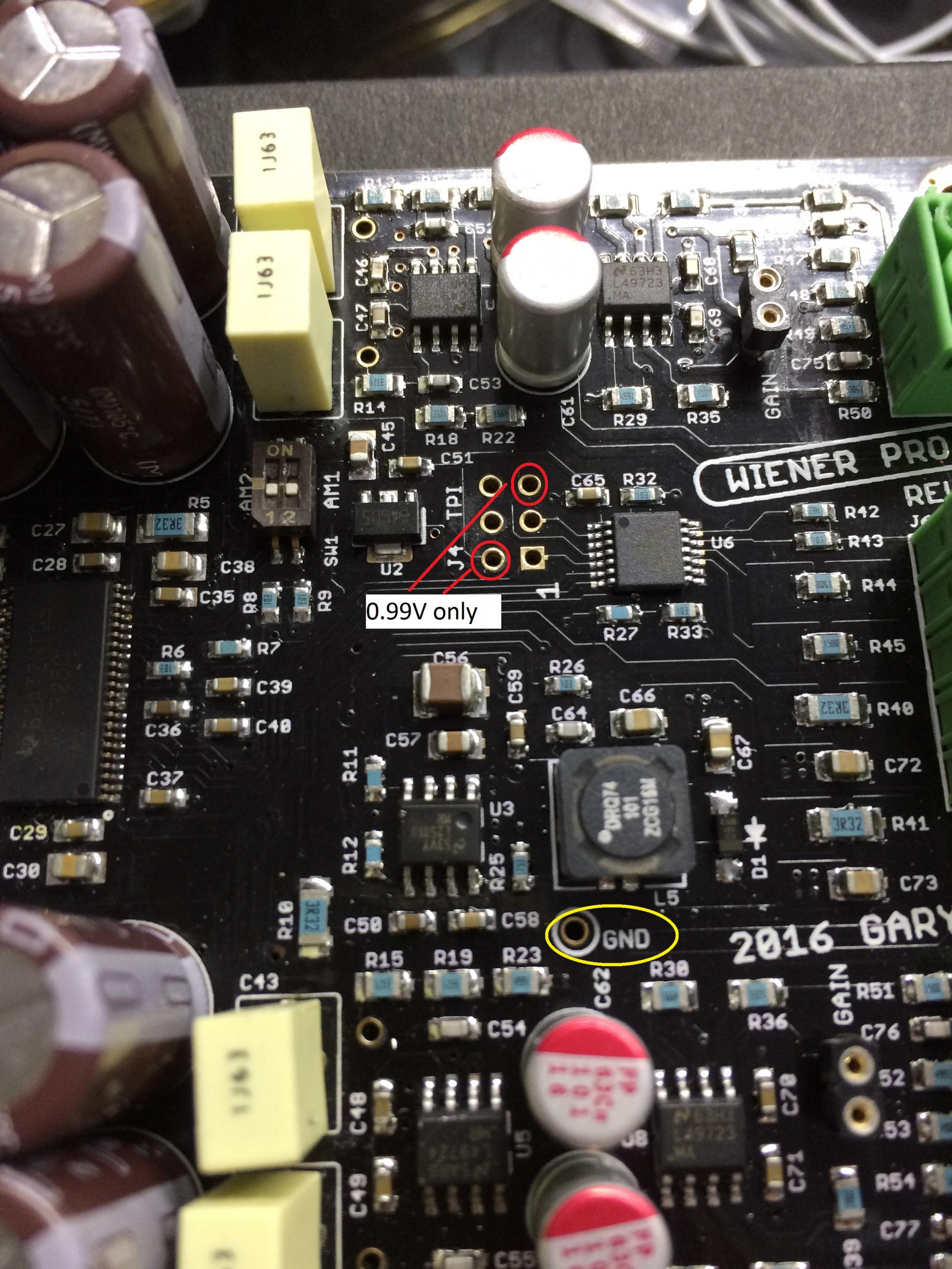

I use sigma11, 25V AC primary, 24V DC secondary
The board now not showing any LED... Don't know what's happened.
I use the s11 in lots of things and it works especially great with these Class D amps. Just know that it's a high-performance design with no compromises and it's easy fry those fat resistors with a momentary short or unfortunate power-up sequence. Have you checked the s11 recently for proper output with/without load? Doesn't really sound like your problem, but maybe worth verifying.

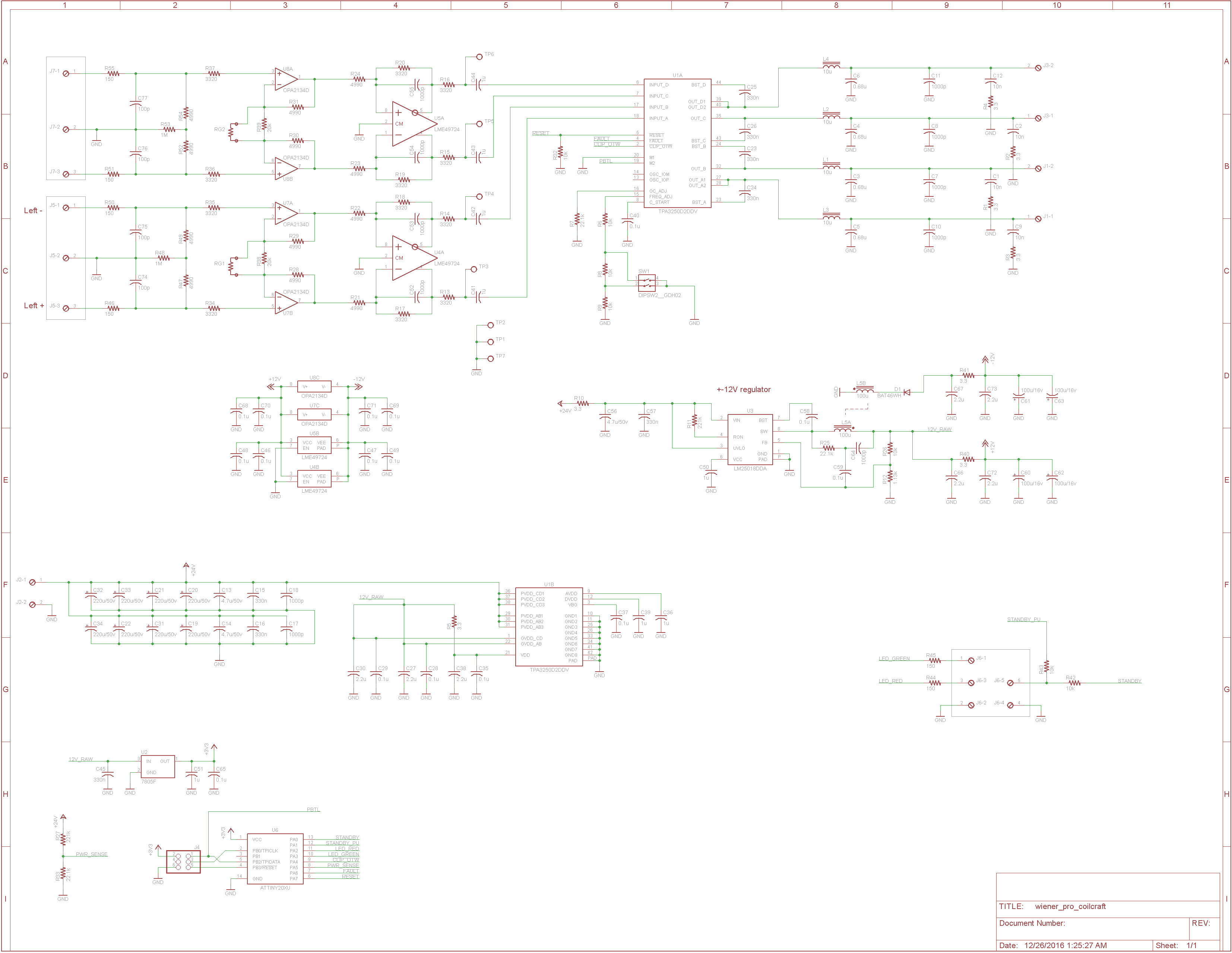

Is there any manual or schematic of wiener pro?
thx
I second this request. I'm looking at finally starting a 6 channel build and would like to dig into what configuration options I can play with (selectable PBTL, selectable SE / BAL input, adjustable gain, etc).
Looking at the silkscreened documentation, it appears that gain adjustments could easily be made off board by selecting between gain resistors. Would it be possible to make PBTL selectable by switching the documented PBTL connections offboard? Could C33 / C34 be moved externally and switched in when not PBTL?

I can't find there is a manual or schematic of the PRO version.
Hey, sorry for falling off the face of the earth 🙂 Too many other projects going on.
I'll put together the Pro schematic/firmware/etc tonight and release it.

Schematic and microcontroller source files are attached. Between the two of them, if the board is doing something odd/unexpected you should be able to use these to diagnose the problem and fix it.
Unfortunately, to reprogram the microcontroller you have to remove it from the board. The ATTiny20 requires +5V to program, and the digital control lines for the TPA can't handle that voltage.
