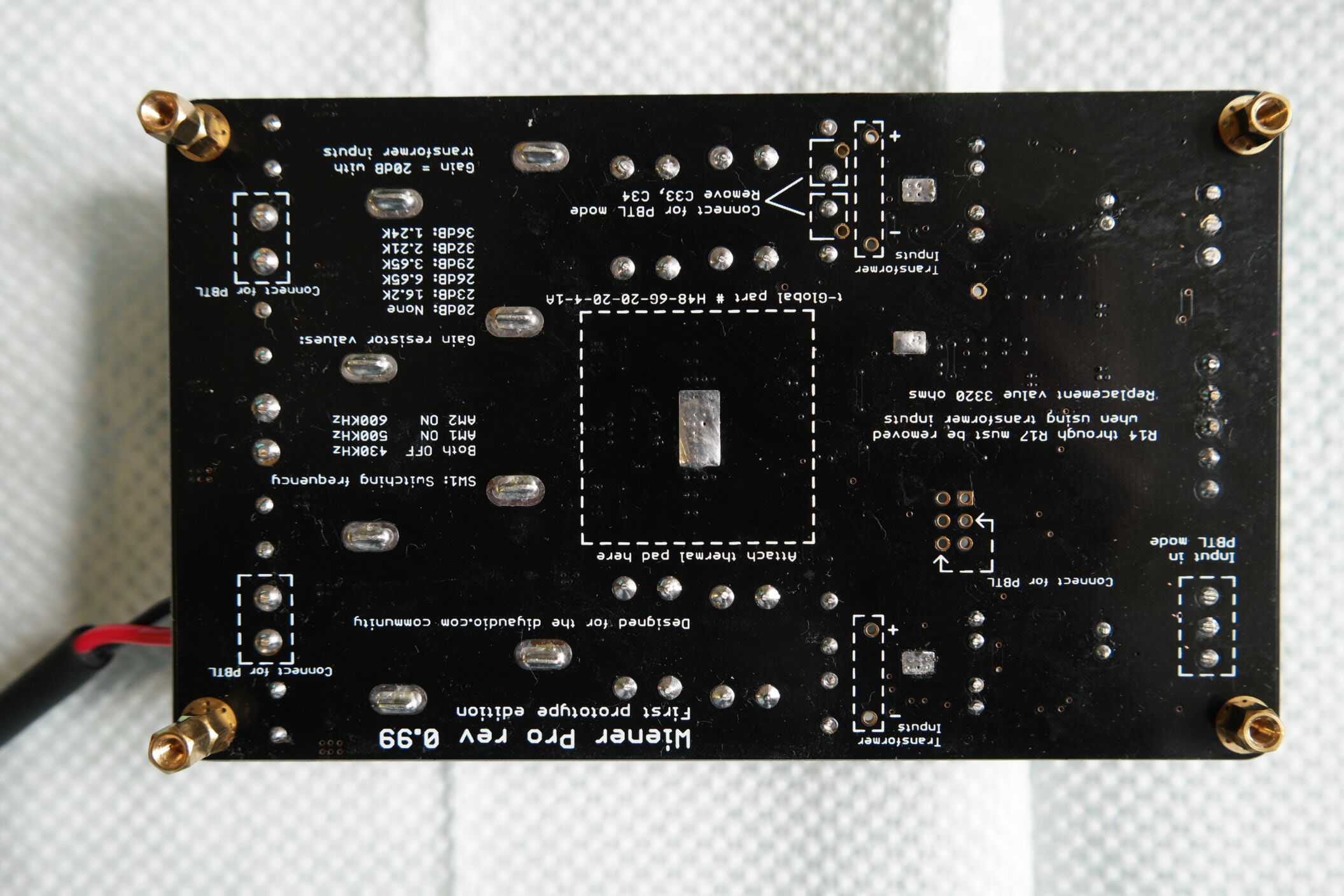

The resistors are for gain setting on the Pro's. There's a table on the back of the Pro PCB describing what resistor values to use for each gain setting. Default gain is 20dB, there's resistors for 23/26/29/32/36dB gain if I remember correctly.

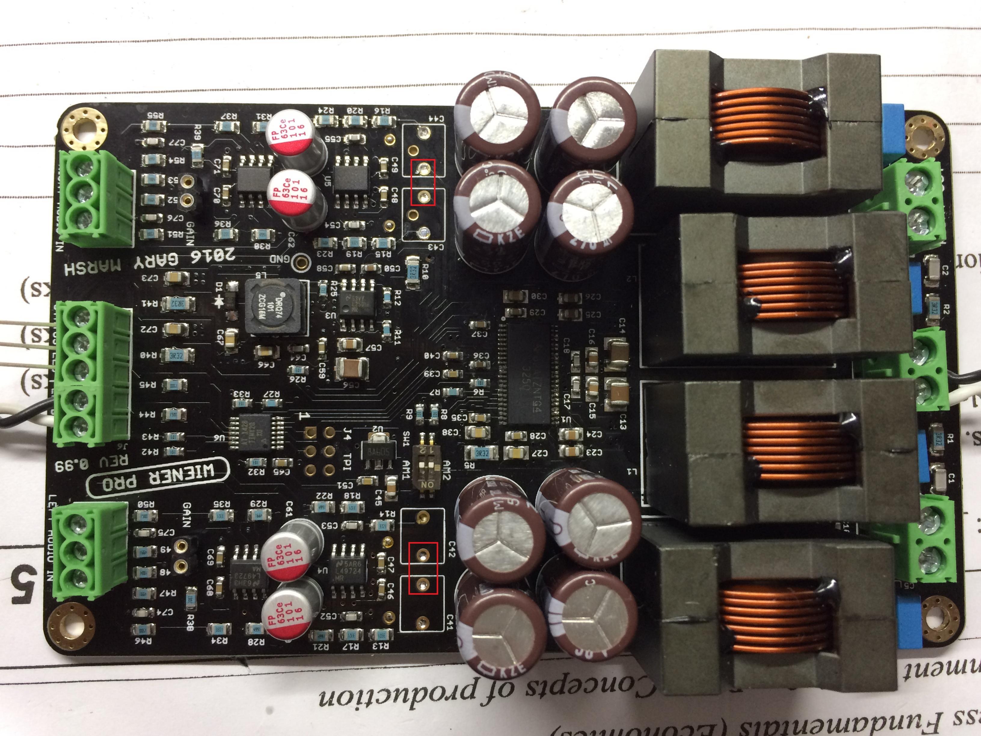

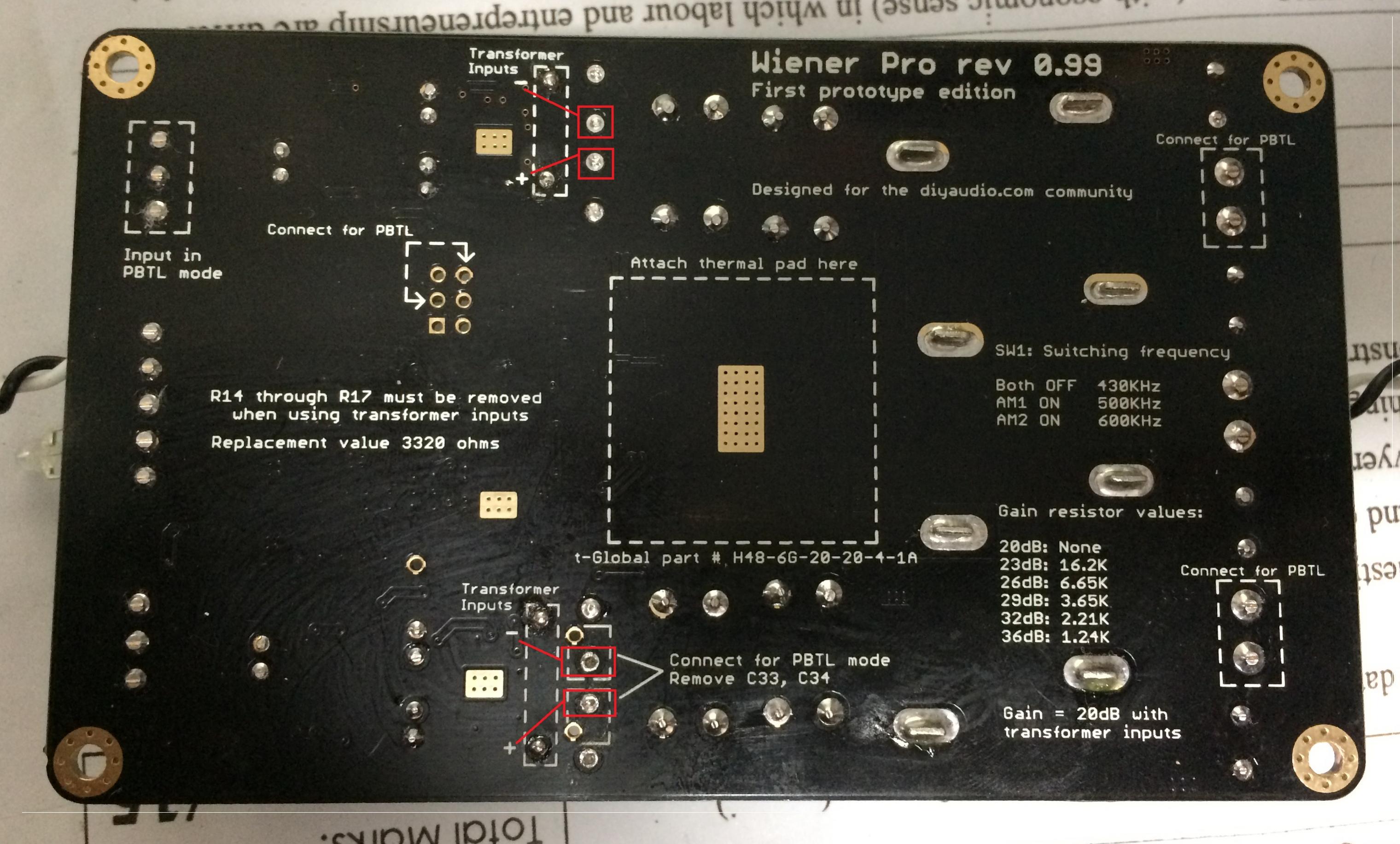

Also, I'd like to confirm that, if I connect transformer to "transformer inputs", do I need to remove the capacitors C41 - C44? (mentioned in post #121)?
The capacitors you have to remove are labelled incorrectly on the board silkscreen, but it's the four 1uF, yellow film capacitors. Transformers then attach to the TPA facing side of the capacitor footprint. I'll have a look at a board when I get home.
So it means to remove the four caps, then connect the transformer outputs to the pins of capacitors that connects to 3250? (red squared pins)
Correct.So it means to remove the four caps, then connect the transformer outputs to the pins of capacitors that connects to 3250? (red squared pins)
The alternative, and originally intended method would be to remove R13 through R16 on the card (not R14 through R17 as the silkscreen says, whoops)... leave the caps in place, and use the specified transformer inputs. But doing that's harder, I'd say do the cap method exactly as you've shown.
It's a version 0.99 prototype, a few design mistakes were made, at least I got the audio and power stuff right 🙂
Thanks.Correct.

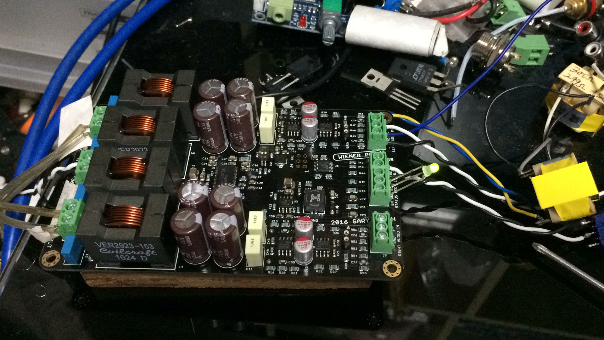

Hi gmarsh,
A parcel arrived for me today containing
my Wiener amp, Thanks so much for
building this little amplifier for me, i'm
very much looking forward to the weekend
when i'll have my first listen! Thanks again,
very much appreciate your time and effort.
Dave

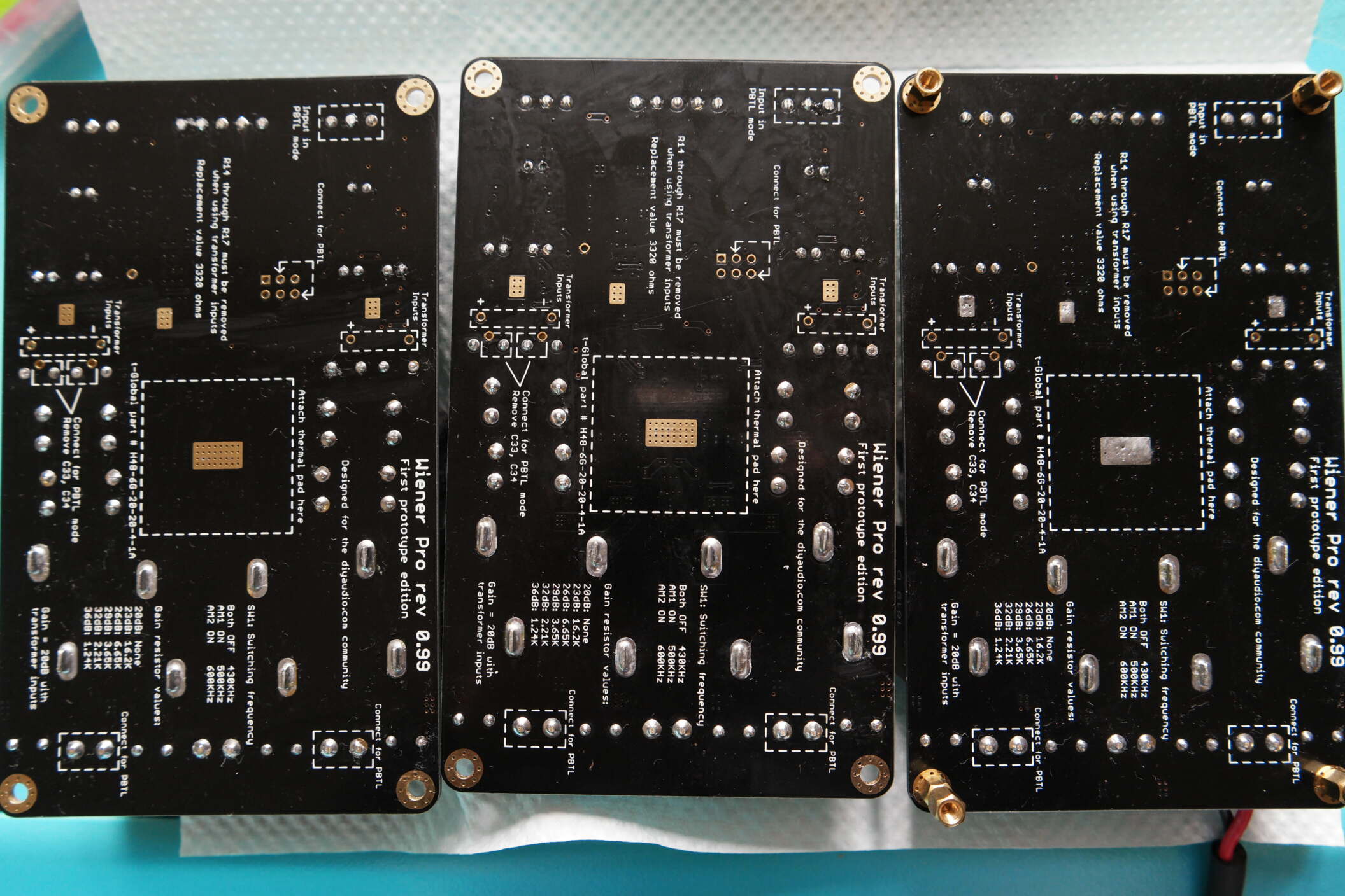

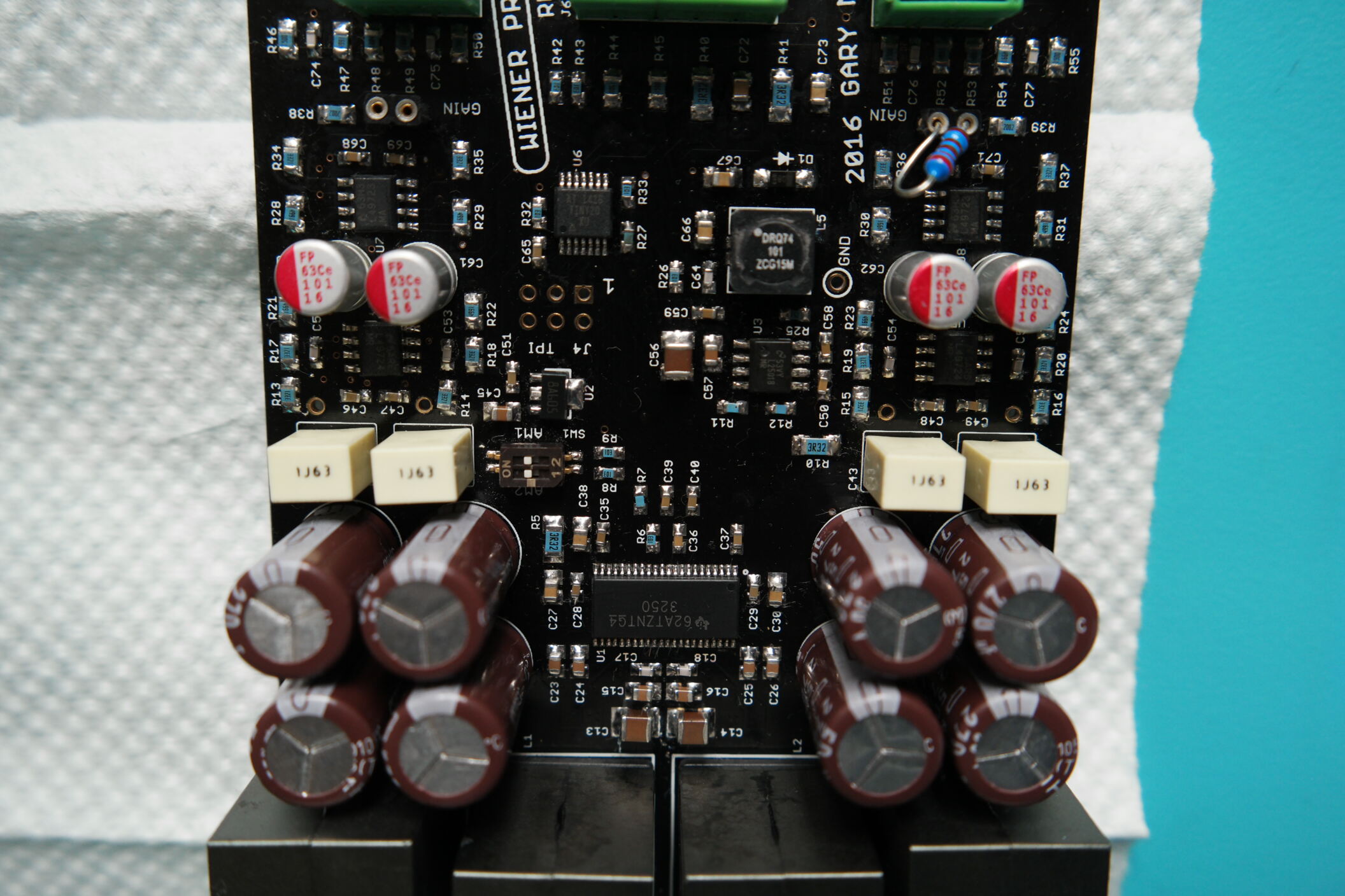

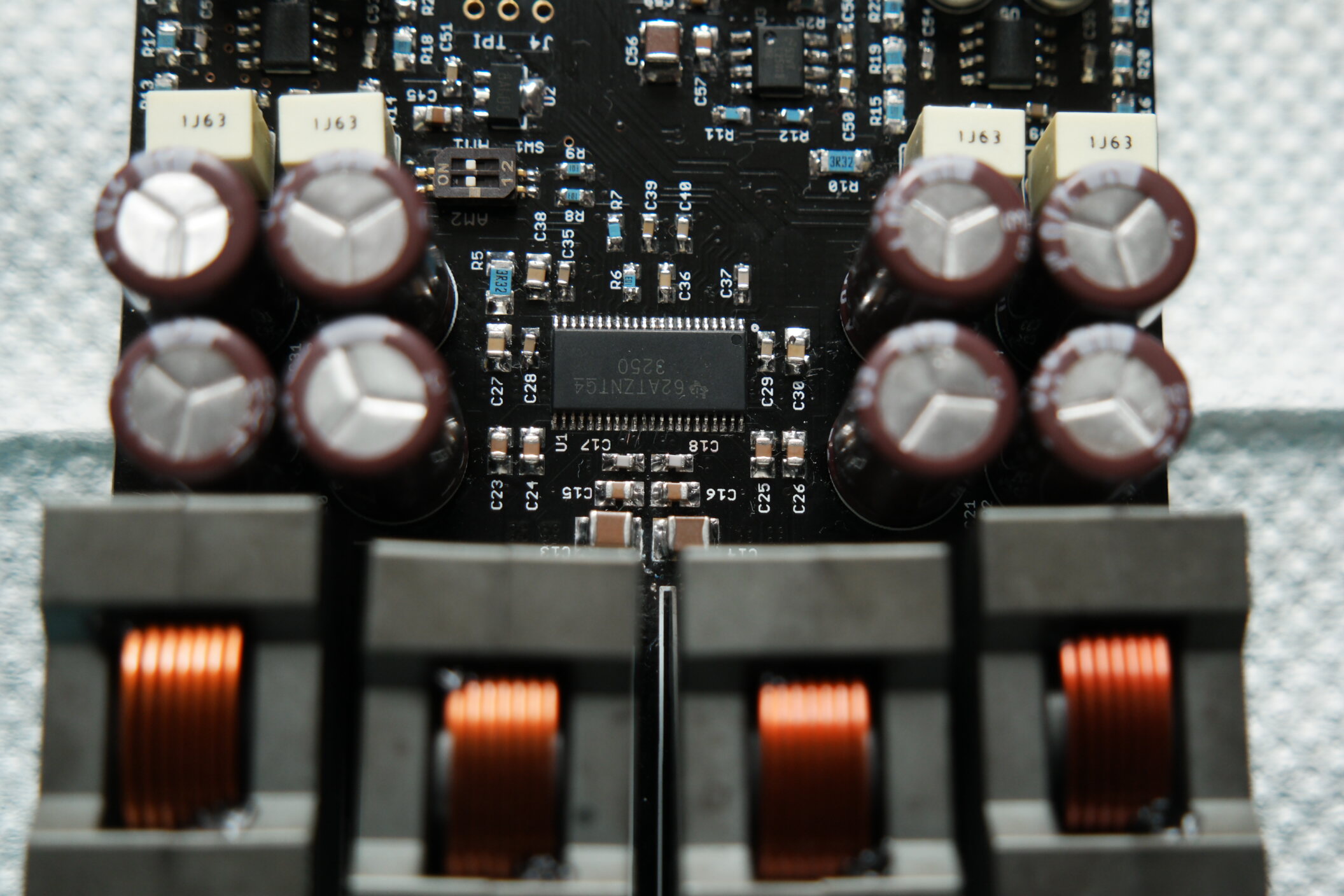

In ref to a softer Right channel (as label) for the Wiener Pro.
The one that had problem looks different from the underside, there is solder on all of the exposed copper for the heatsink.
I also attached close up of the IC and underside of the problem board.
