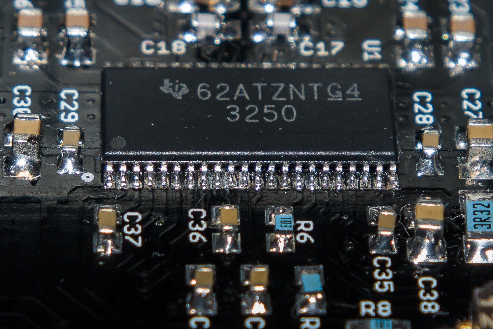

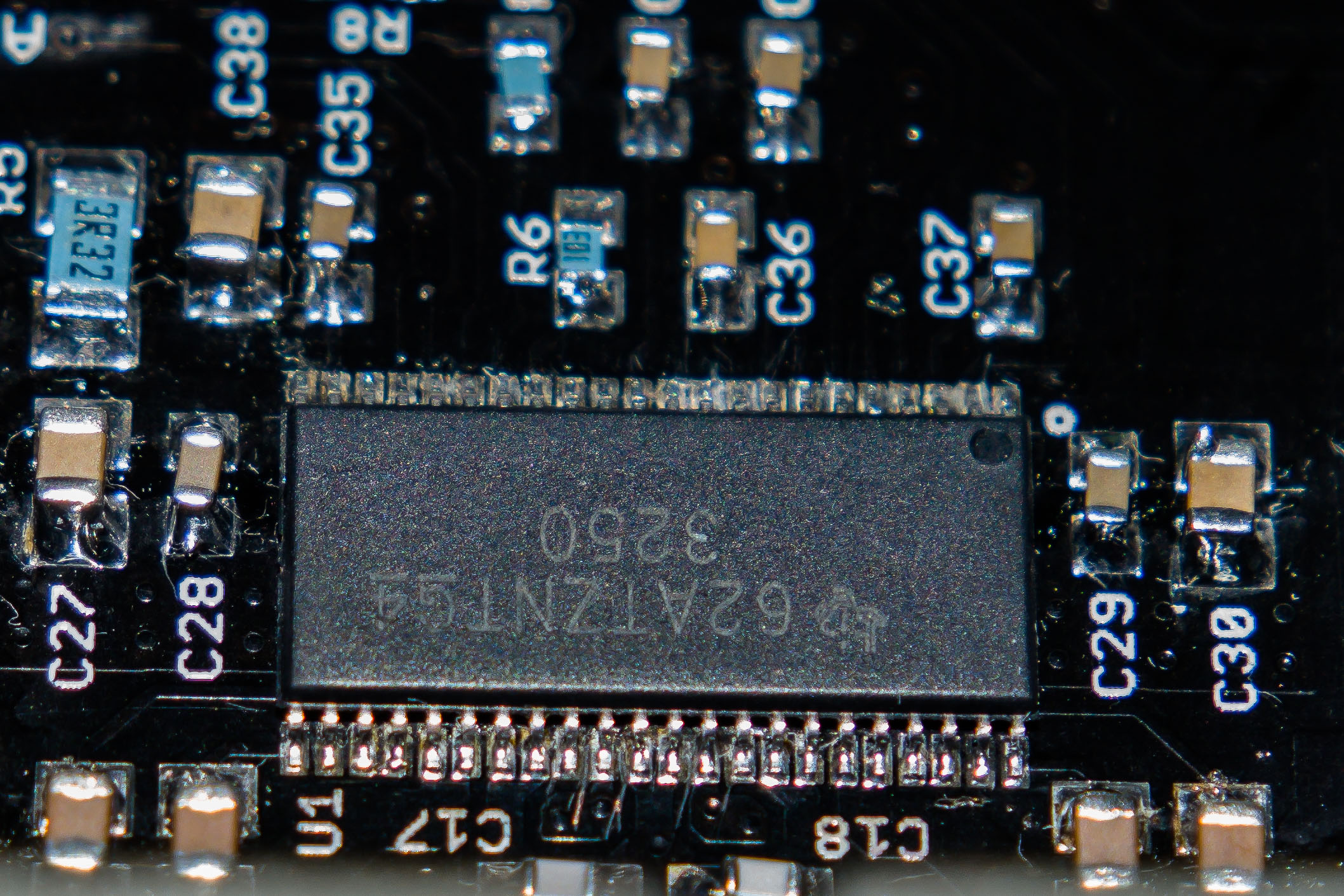

That's the single hand-soldered Pro that I made, the thermal pads were soldered from underneath with an iron hence the solder being present. No surprise that's the board with the problem.
Looks like one end of R14 isn't soldered properly, are you able to touch that up and retest?

R14 is soldered on, just not pretty. I also test with a meter. Anyways the problem is the with other channel.
The joints look OK. Pins 6/7 of the TPA3250 are the input pins for the flaky channel, try poking on them with a toothpick or something else non-conductive and see if it changes the gain of the amp.
