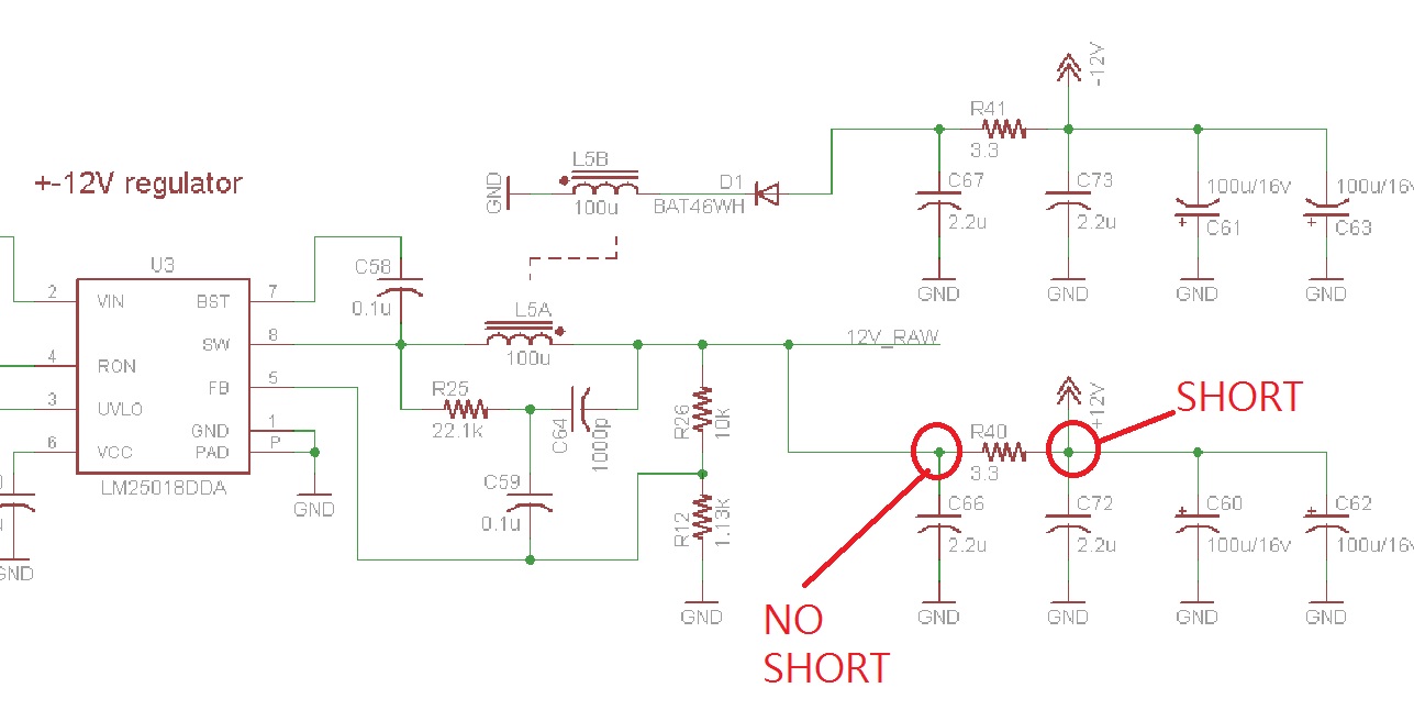

Trying to troubleshoot.
I've de-soldered the op-amps, the voltage still not correct.
Then I de-soldered the +/- 12v switching regulator and R40 and feed +12v to R40 at the "raw12v".
Now the amp can be powered on, but it shows solid red led.
I switch it off, check the +12v and raw12v to ground. the +12v is shorted to ground, raw12v doesn't shorted.
I checked the schematic, it seems that +12v is used by opamps only, and the raw12v is used by 3250. That's why I can power on the 3250, with 3.3v at the regulator, with red led and pop sound on right side of speaker.However, I still have not found the root cause of problem:
1. Where is the point that +12v is shorted to ground? I can see any issue on the PCB top and bottom yet...
2. Why is the amp turns to red led? If I connects the outputs to speakers, the right side speaker will make pop sound.
3. Why is it only the right speaker making pop sound but not both speakers?

It seems that the switching regulator was unable to output correct voltage because of the shorting at +12v. Now I separated the +12v and raw12v, the led can be lit, which means the microprocessor is working (with 3.3v). The 3250 is able to work as well. However, there's solid red led, which means something is wrong at the 3250, may be the output is shorted. I still can't find what makes it shows red light.
If the +12V (non-raw) net is shorted to ground, options are the LME49724's (the 49723's on the input don't have a direct connection to ground) or perhaps one of the decoupling capacitors on the 12V rail.
If you've got a current limited bench supply and a multimeter that has a millivolt setting, feed some current into the shorted rail (say 50-100mA) and measure the voltage across the decoupling caps by each of the op-amps. Wherever you measure the lowest voltage is probably where the short is. Also inspect the solder joints.
Removing the 49724's is a pain as they have a thermal pad underneath, ideally you'll need a hot air station to do it.

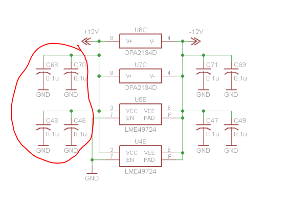

Finally found that one of the de-coupling caps is shorted...
Now all the caps in the +12v rail are removed, op-amps gone, only the microcontroller, 3250 and 3.3v ldo are kept.

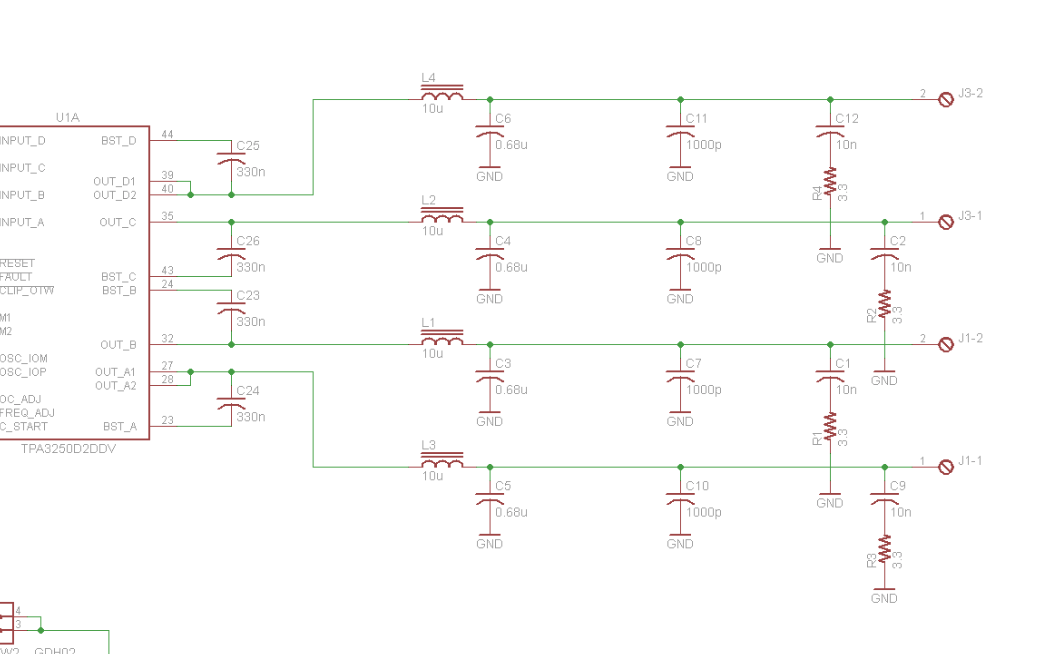

However, the 3250 amp still showing red led.
It seems that there's something short at output of 3250, because it gets warm without any input and output attached. After turning on for 1 minute, the 3250 gets warm. I think this is not normal. Do you have any idea what should I check?

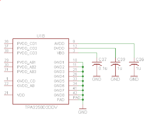

Power up the amp, measure the voltage at the INPUT_x pins of the TPA - they should all float up to a few volts (AVDD/2, I think).
Also measure the voltage on the AVDD pin, DVDD pins and Vbg pin.
If any of these things are zero, or not right, power off the amp and measure for shorts at any of these pins to ground. Could be a blown TPA chip, or it could be something external.
Thanks Gmarsh.Power up the amp, measure the voltage at the INPUT_x pins of the TPA - they should all float up to a few volts (AVDD/2, I think).

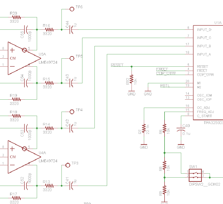

I found a problem here: INPUT_D is just few mV, all other INPUTs are 3.xV
avdd=7.7v
dvdd=3.3v
vbg=1.2v
I just replaced the 3250, the red led is gone. Unfortunately, it doesn't make sound.
I checked the voltage at input A to D. Input A to C are all 3.9V, however, input D is just 2.5V. When I turn off the power (open the ENABLE pins). Input A to C are 0v, Input D is -1.2V. Moreover, the +12v regulator gets warmer than before the 3250 is replaced. So it seems there's something wrong, may be the pcb trace?
Input D shouldn't be capable of going to -1.2V, there's no negative voltage applied to the TPA. Unless something's screwed up in the front end op-amp stage making it drive negative voltage into the amp, and the film cap for that input is shorted.
Remove the four film caps and measure their resistance, which should be well up into the megohms. Leave them off the board, power the board up and measure voltage on both the analog-stage and TPA sides of the footprint.
