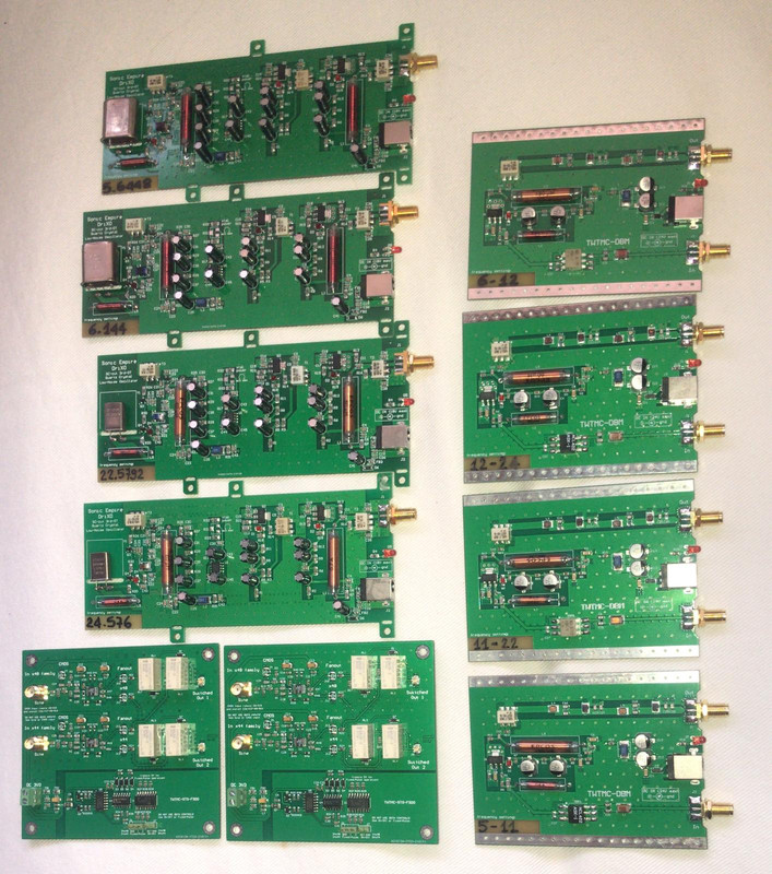

My current design has no feedback through the FET stage; it has nevertheless no
thermal problems by using the positive vs. the negative TC of the 2 JFET TCs.
I won't go to 64 FETs, It is more like 2*8 or even 2*4, given the cross correlation
results of my Agilent 89441A. It averages out any noise contribution of the two
preamplifiers, keeping only what's in both channels at a time.
Averaging 1000 times is much cheaper than averaging over 1000 FETs
and much less of a load. It just takes some patience.
And regarding royalties, my implementation of the Wenzel design is (c) 2005,
which makes it predate yours by 5 years, as seen in the notice in the layout
of the right picture (top right).
