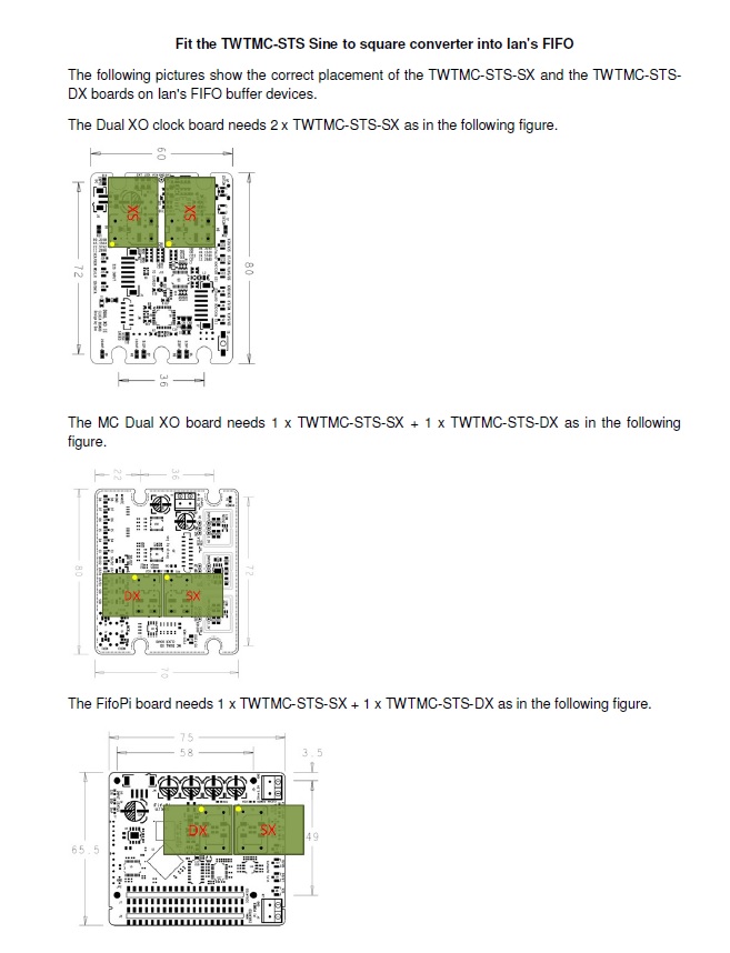

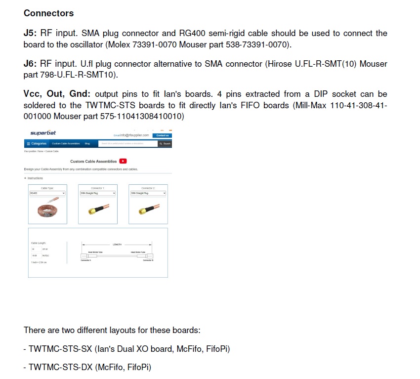

I attach a few pictures extracted from the user's manuals.
I suggest RF assembled coaxial cables from RfSupplier or from eBay like the following
RG400 SMA Male to SMA Male Double Shield Coaxial Cable PICK LENGTH RF USA Lot | eBay
I suggest RfSupplier
SMA Male to U.FL Jack Cable Using 1.37mm Coax, RoHS
One can also use adapters, such as: https://www.mouser.com/ProductDetail/Linx-Technologies/ADP-SMAM-UFLF?qs=1sbE9T7hb3YYN6C6S11nMQ==

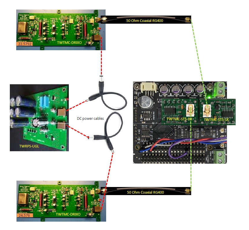

I added another document (part VII) that explains how to connect oscillators, frequency doublers and sine to square converters to Ian's FifoPi.
There are 2 options to feed the FifoPi with 22.5792 and 24.576 MHz.
The first is:
- TWTMC-DRIXO 22.5792 MHz
- TWTMC-DRIXO 24.576 MHz
- TWTMC-STS-SX
- TWTMC-STS-DX
- TWRPS-UGL
The second is:
- TWTMC-DRIXO 5.6448 MHz
- TWTMC-DBM 5.6448 Mhz to 11.2896 MHz
- TWTMC-DBM 11.2896 Mhz to 22.5792 MHz
- TWTMC-DRIXO 6.144 MHz
- TWTMC-DBM 6.144 Mhz to 12.288 MHz
- TWTMC-DBM 12.288 Mhz to 24.576 MHz
- TWTMC-STS-SX
- TWTMC-STS-DX
- 2 x TWRPS-UGL

you can run the FifoPi with a single TWTMC-DRIXO 5.6448 MHz but you need at least the sine to square converter board (TWTMC-STS- SX or TWTMC-STS-DX).
Finally you need a clean power supply 12 to 18 VDC (16-17 VDC recommended).
