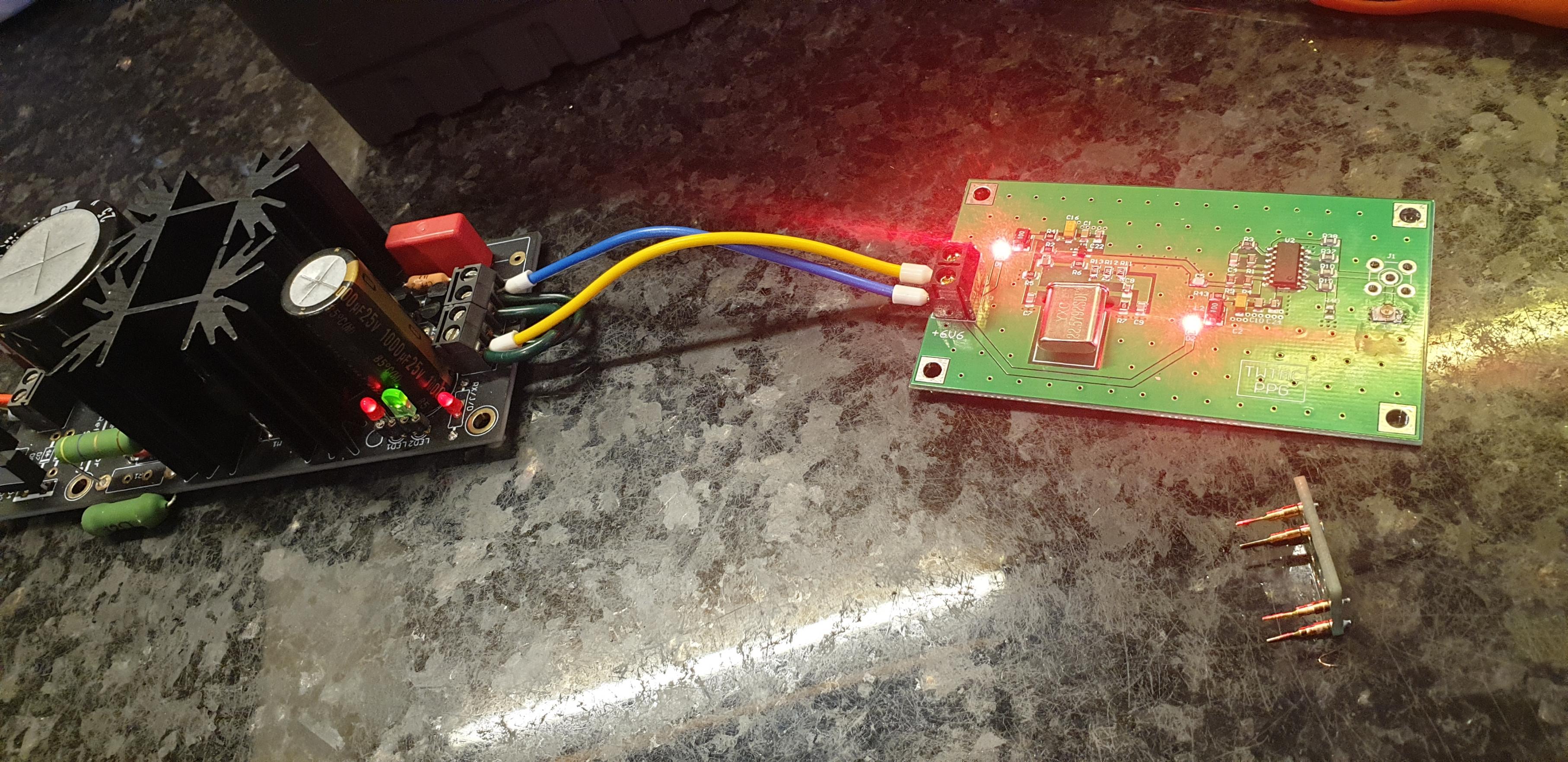

This is what I have so far on the order form for a FiFoPi Q3:
5.6448 MHz SC-cut
TWTMC-DIL
TWTMC-DRIXO-F 5.6448 MHz
TWTMC-STS-DX
Are these four items enough for a Q3? I have a LiFePO4 power supply that I can use.
Just testing my PPG board with my Ref D set for 6.6v and plenty of spare CCS. Maybe overkill?
However. Do I need to populate 100R r40 for Ians Fifo?
And I need do nothing with J5,6, 9 and 10 on the small adaptor boards?
Thanks in advance.

I don't know if Ian's FIFO external oscillators inputs are 5V tolerant, if not so you have to add the 100R resistor.
Please, ask Ian.
On the small adaptor board you have to mount the u.fl connector, then you can use a u.fl cable to connect the DIL board to the PPG board.
The DIL small board fits Ian's FIFO, pay attention to the polarity.

I finished the 5,6448 MHz board in the morning, the frequency is 5,6447 MHz measured, but there is measuring error, so I thinks its ok.
So I have just 10MHz oscilloscope, the shape of the sine is hardly seen, seems a little unsymmetric, but its not shure.
I will listen to music with this board in the weekend.
Just a clarification.
About the frequency:
- first of all you need a very precise tool with GPS sync to measure the exact frequency of the oscillator, otherwise the measured frequency is an approximation
- the DRIXO oscillator uses SC-Cut crystals without a oven, so the frequency is not exactly the nominal one since it operates at room temperature instead of at the target temperature. Due to the inflection curve of the SC-Cut crystal vs teperature the operating frequency without a oven will be a little different against the nominal one.
- the operating frequency of the DRIXO oscillator drifts over the time because there isn't an oven
- in digital audio we don't care about precise frequency and long term stability, unless you have to sync several devices with separate clocks. In this case the DRIXO oscillator is not suitable unless you build and install your own oven
About the sine wave:
- the output of the DRIXO oscillator is AC coupled, so you should not see any asymmetry
- to view correctly the waveform the oscillator has to be correctly terminated with a 50 ohm load.
