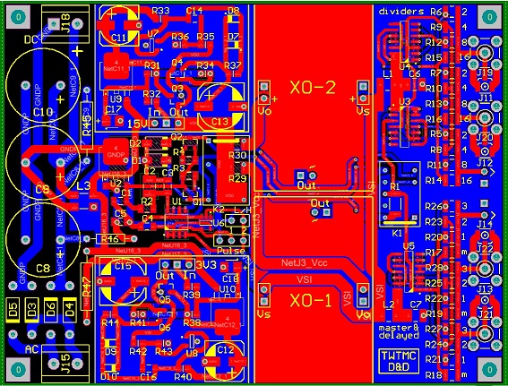

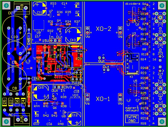

Daughter board PCB
Attached the daughter board PCB layout.
I have checked several times the PCB, but if you find any errors please let me know (Demian please take a look).
Board size is 3.25" x 4.25", it accommodates 2 XOs.
Attached the daughter board final schematic and the part list.
The daughter board is fully configurable.
It accommodates 2 Xos, but you can use it for a single XO.
It implements some dividers (optionally): 2/4/8/16.
It outputs master clock directly, but there are also 3 delayed clock.
It provides rectification and filtering from AC, but one can use an external DC supply.
There are 2 low noise regulators on board (15V and 3V3), but it's also possible to use external regulators.
Optionally, you can power off the oscillator not used at a time by fitting a second relay.
Two switching mode between the 2 XOs are provided: pulse mode and fixed mode.
U.fl. sockets, SMA sockets and pin strips are provided as output connection.
