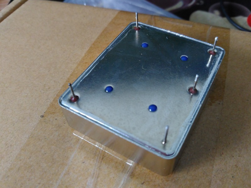

Happy new year to all.
If you have implemented the TWTMC-D&D to supply the oscillator you can use rubber O-ring as in the attached picture (I used O-ring supplied by Ian).
Without the TWTMC-D&D, you can anyway solder the oscillator board to a simple stripboard (prototyping PCB) and then use the same tecnique.
Thanks Andrea, the photo explains a lot. I'm just about to order the parts for the TWTMC-D, so a while off mounting anyhow...
I'm going to try out those LT3042 regs that canvas is using. I might try feeding the 6V reg with a few lithium cells I have here and do a comparison with a mains fed supply.
Really looking forward to trying this one out. I'll let you know how I go.
