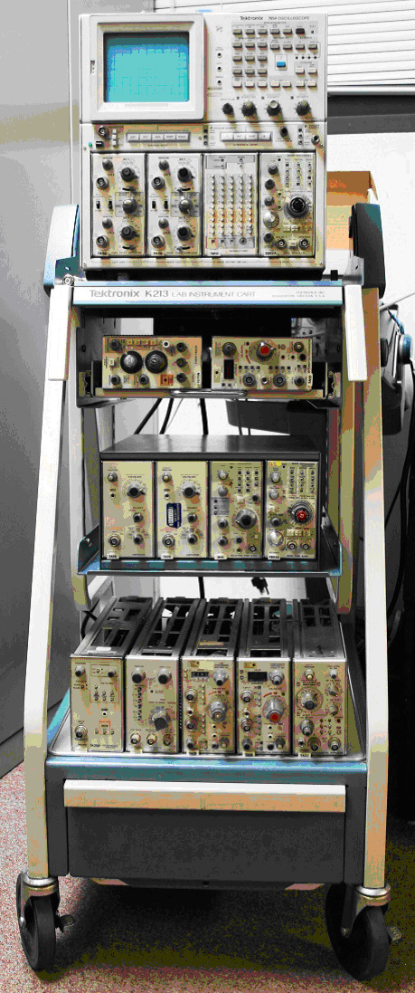

Hmmm... I've been looking at the CSA-803 from tektronix to get a better view into what happens in the high frequencies with digital transmission, decoupling, ground bounce etc. But I don't really have any experience with such equipment ... Maybe I can ask you for a slightly off-topic advice: Would you say that the CSA-803 is a "good/the best" device for RF/TDR measurements (and if so "A" or "C" or no suffix version) or is there a better one at a reasonable price (reasonable price should apply to this device's accessories)?I should repeat that now with the 18 GHz TDR.
Jesper
I have access to a DSA8200 with the 20 GHz TDR modules. I would advise against owning this stuff unless its really cheap (under $300) since its essentially unrepairable. We had to get a TDR module repaired and the quote was $5K. It got over 5V on its input. The whole setup is now obsolete (5 years an $150K down the tubes) because HDMI moved to using a VNA for validating cables. The VNA for this is another $150K. Not good for the bottom line.
However I have a 7854 + 7S12 + S52 pulse generator and S6 TDR sampler modules good for 12 GHz. You could put together similar in the $600 range pretty easily. What you will learn is that even a short in microwaveland is not a short. And that its probably not important for audio.
Access to a VNA can do the same. (I have an 8753E in my garage right now but its too big and clumsy to set up for a few measurements.) It takes way more time to calibrate and de-imbed the fixtures etc. than to make a measurement.
I would focus on the best layout practices and use components that are up to the task: Leads bad. Ground plane good. Vias are to be avoided if possible, high inductance. Look to the chip vendors reference designs and layouts. use the smallest footprint parts that are good. Many ceramics change their values a lot with voltage, not good. The better cap's datasheets have self-resonant plots on them. I think Gerhard's paper validates those datasheets.

The CSA803 is bigger than the 7854 and far less flexible. There are better instruments for jitter or phase noise measurement. You could look at my trick w an fm tuner.
I think I have as many plugins or more. They were cheap at the end of the '90s.

I don't have much experience with TEK samplers, but the gurus on usenet group
sci.electronics.design use them as a standard tool (Larkin, Hobbs..) and I value their
opinion. Tek has the advantage that you can get new old sampling heads at a
relatively low price, the market for used stuff seems to be bigger for Tek than HP.
At Infineon Fiber Optics (RIP) we used HP for daily work and a TEK CSA8000 (?)
for the data sheet pictures, that order gave the nicest eye diagrams. 🙂
I use a 54750 mainframe; started with 20 GHz plugins, later 50 GHz and a 54754A
differential TDR. Adding another scope family won't add capabilities to that
what I already have. Maybe a newer mainframe for comfort if I can get it cheaply,
but the RF specs are determined by the plug ins, apart of triggering.
There used to be an app note from Picosecond Pulse Labs in Boulder, Co
that compared the different models. The "best" thing they found was Agilent
TDR + 50 GHz plug in + pulse former from, you guess, PSPL.
PSPL has been bought by TEK; if you cannot find the app note I can search
it in the data pile on my disks.
I don't think that this all is of much use for audio; for me it is more important
for FPGA gigabit links.
Cheers, Gerhard
