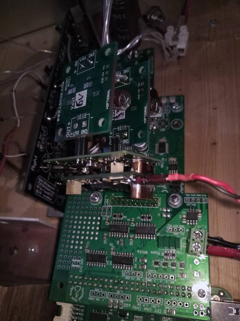

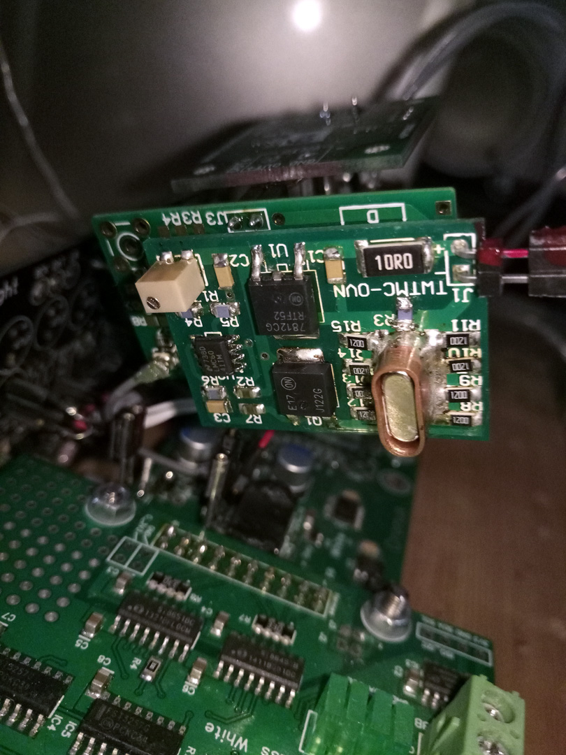

over the weekend i managed to build the oven. the oven is very quick reaching the temperature and seems to be very stable.
i have set the temperature at 82°c with my dmm using its temperature probe (pt100 ? ) and the sc-cut with the oven sounds very nice as expected 🙂 .
the oven pcb itself gets also relatively hot (Q1 becomes almost 120°c as reported before 🙂 ) but everything seems to be very stable and trustable.
next week i am going to check if i can hear any differences varying the temperature between 75°c-100°c and if so set the temperature at a level which sounds most pleasant for my taste.
big thank again to andrea for his great work!

yes , your point is valid. however, it seems that the oven (copper tube) provide a sufficient thermal capacity. i have already did a test out of curiosity. even if you blow the oven for a short time the temperature changes just max. 2°c and the circuit can regulate it very quickly back to the set temperature. ... andrea did a very nice job with this simple and effective board! many thanks again!
i am not aware how is exactly the temperature dependency of our special sc-cut quartz. maybe andrea have more information about that and will share. however, as you mentioned an additional simple thermal isolation around the oven should be easy and does not harm ;-) . i will try that too.

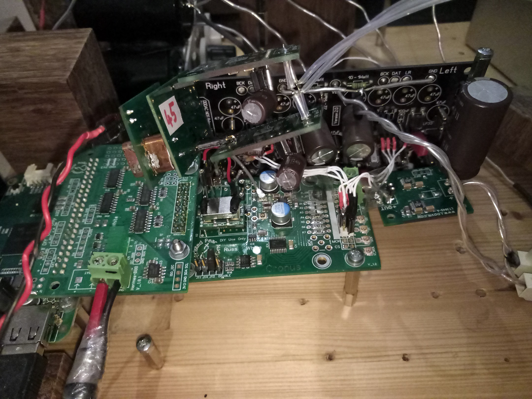

Today I finished putting together a TWTMC-D with 11.2896 AT cut crystal using LT3042 regs for both 3.3V and 6V supplies, raw supply coming from a regulated lead acid battery.
After first impression of hooking it up to my DAC I did not notice any improvement compared to Antons clock (Discrete Low Jitter Clock GB )
I let the system play while I was having dinner and after I came back after about 2 hours later and I noticed a small improvement (no beers or wine with dinner).
Is it likely that the crystal requires a long burn in time? I read a post a few pages back saying +100hrs of burn in is needed. What's other peoples experience?

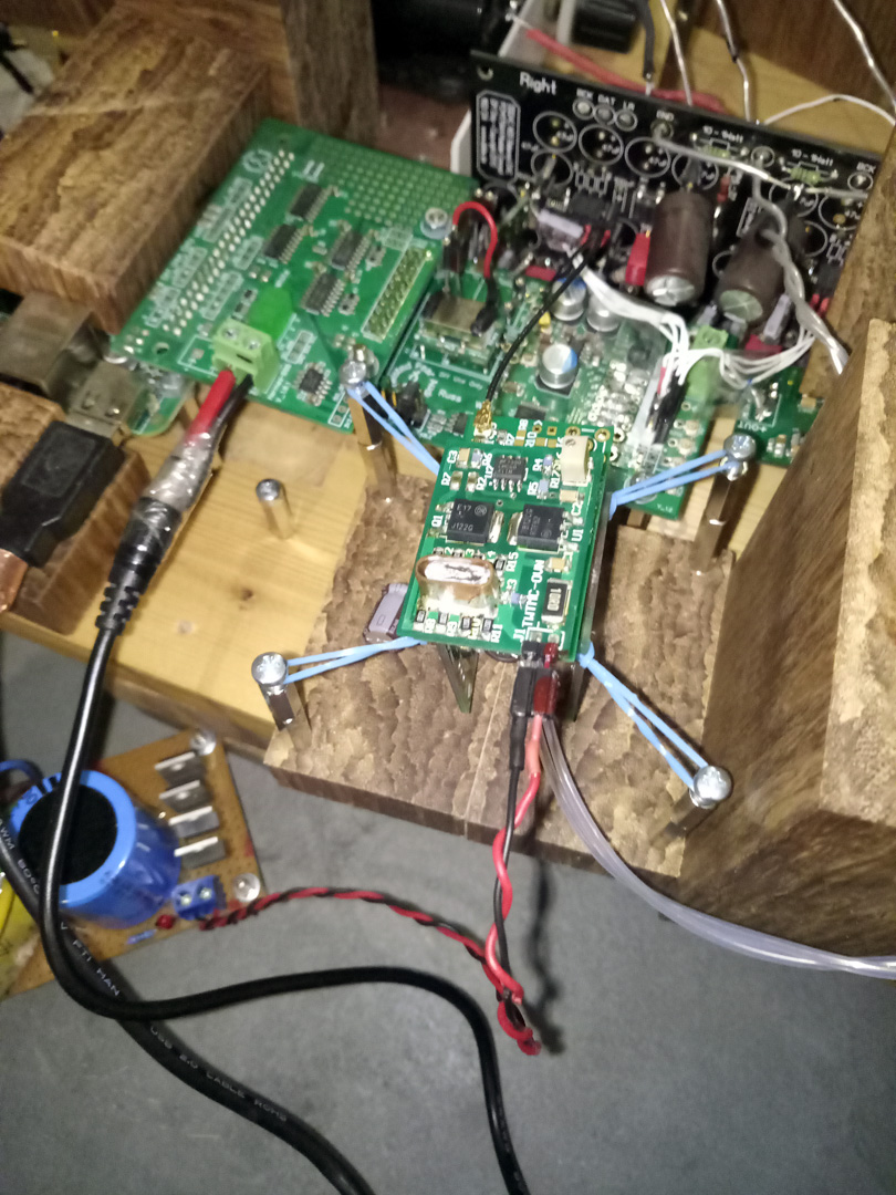

following the approach isolating the xo i tried today a 4point-suspension with rubber cords . in this quick&dirty test i isolated the whole set of twtmc-d, oven and 2x regulators.
the result is, indeed, very promising; everything sounds more relaxed and natural ! 🙂
i will report more as soon as i have the chance to listen longer with this set-up.
regards

Very good concept,a platform in Panzerholtz would be even better.
