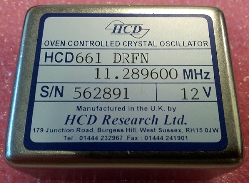

I own a good reference OCXO at 11.2896 MHz (see HCD attachment). As an alternative one can get a Morion double oven OCXO on eBay, but it's a 10 MHz oscillator Morion Double Oven Ultra Precision OCXO 2x10 12 MV89A | eBay

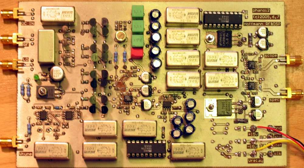

I have done that already some years ago but never finished it to the point
that it was really usable. Without software integration etc.... Also I don't
stand with some design decisions I did at that time: non-bistable relays that
heat everything until the bias runs away, too much effort into the input stage
(many FETs in parallel) while a simpler dual version would bring much more.
Now with a E5052B in the next room at work there is no real need to
continue that...
With the 89441A in my own lab that can do the cross correlation that could
change, but not very soon.
That was also with a different CAD system than I use now.
regards, Gerhard.

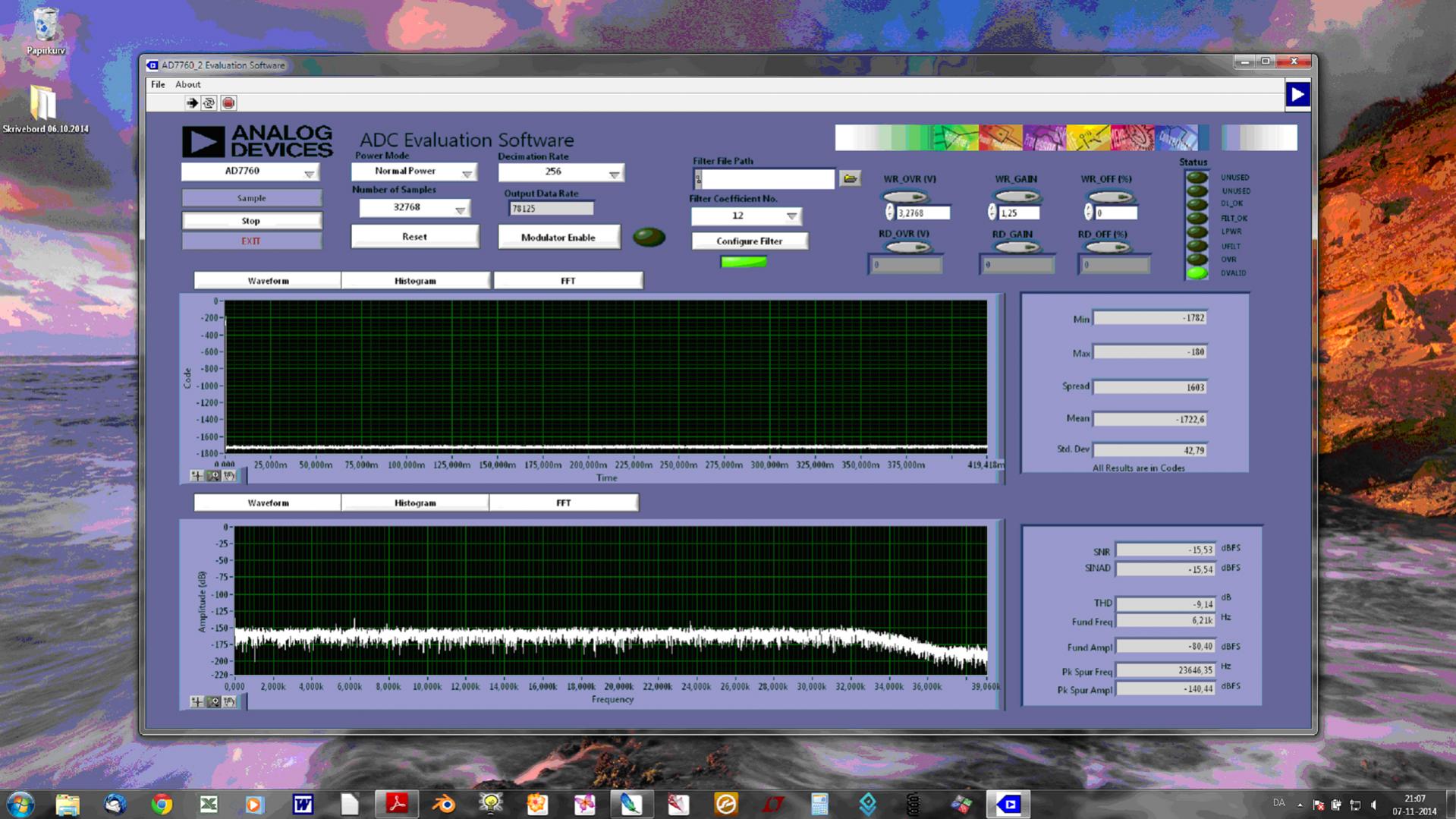

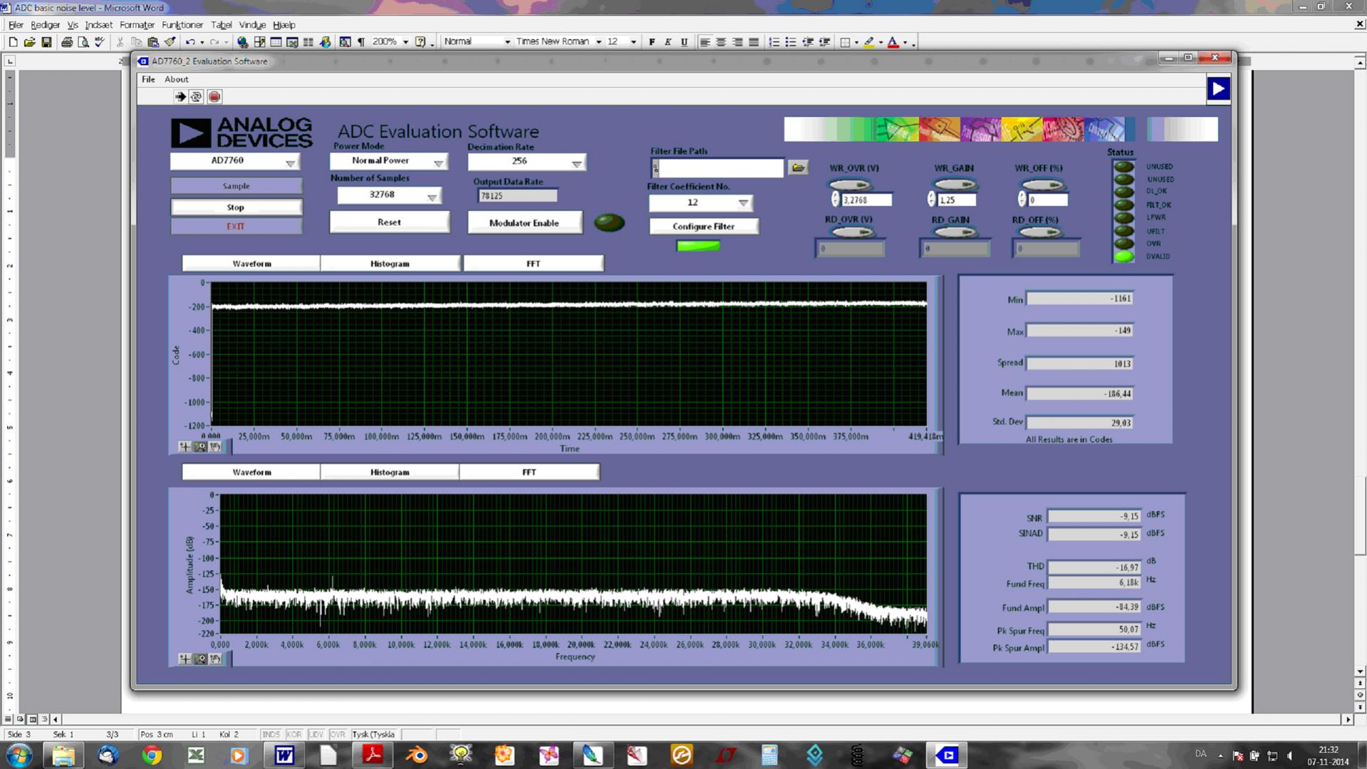

I have some unused A123Systems batteries (ANR26650M1A) and got curious about their noise level from reading here in the forums that batteries apparently were noisy.
So I connected them to my AD7760 evaluation board through a capacitor and compared the noise level with the basic noise level of the ADC with inputs shorted at different currents. FYI I've attached two screendumps - one of the ADC's intrinsic noise level (first one), and one of the A123 battery at 0.48 amps. I tried other lower currents but the differences basically were unmeasurable in this setup.
A couple of remarks on my measurement setup:
- It seems there's always a spike at ~6.4 kHz and the very low frequencies in general are influenced by noise except to a lesser degree when the ADC's inputs are shorted. I know - not perfect - but sufficiently informative for my uses (and wallet 😱).
- The setup is not capable of indicating - 200 dB noise levels so it can't ultimately show the actual noise of the battery.

@GOR3:
Build an ad797, ada4898-2 or LT1028 based preamp; that is cheap, delivers 1nV/sqrt Hz
and you can see the noise of a 60 Ohm resistor, another 1nV/sqrt Hz; that adds
geometrically and gives you a calibration line at 1.414 nV/sqrt Hz. No matter what your
ADC does, as long as the preamp noise dominates (enough gain). That is ultra-
convenient, I cannot repeat it often enough.
The 6.4KHz is probably a battery charger, energy saving lamp or some other
switching power supply. Hard to get rid of.
If your supplies are down to 1nV/sqrt Hz, they are extra class already. Most regulators
will be 40 dB above that, or even worse.
Gerhard- I'm a little confused by all the stuff going on on your board. I was thinking of laying out one myself but simpler- with the supplies, mixer, simple PLL (although it might work just to manually tune with a trimpot) and a low noise amp (probably LM49990 since its still the cheapest while we can get them). Your board has a lot of stuff on it for other tasks? I do not want to reinvent the wheel so borrowing or stealing good solutions where I can beats making lots of mistakes myself. I would make it for dip packaged DUT's just to be practical.
There is not that much on the board. Just look into Wenzel's paper. There are many switches
and they all have been replaced by relays with protective gas. They are also shielded.
Small loop areas mean small induced interference. One could shield the entire board.
The two fat black chips from Micrel are pin drivers with serial shift registers that allow setting
all the relays with just 3 signals: clock, serial data in and transfer to parallel register.
On the top left is a relay that switches the input between the dc in SMA and the ring mixer.
That is the box below, probably MiniCircuits SRA3-h because I had them. To the right of the
ring mixer is a RF low pass.
I wanted a differential amplifier for stability and to avoid selecting parts. The BD138 (?) transistor
and the green LED on the left is the tail current source. The differential input doubled the number
of JFETs, it took another doubling to make up for the two noise sources now in series, and then
I got only noisier FETs, so their population increased fast. There was a Cu bar between the
2 rows of FETs to force them somehow to a common temperature.
The small cermet trimmer is for balance. Cermet is bad, noise-wise, but was only a small
part of the drain resistors. The red and green foil capacitors as well as the 5 black bipolar
electrolytics implement the LF corners, below is an opamp to provide the loop gain with
the FETs.
On the bottom left is the tune output for the VCXO, there is an optional inverting stage
since the tuning direction is not standard among the VCXO types. Costs another relay.
Just right of the middle is another gain stage. The output coupling Cs are 5*22uF bipolar IIRC.
On the right are + and - 5V regulators and 2 output amplifiers for scope and spectrum analyzer.
That's all.
Probably everything would work just as well without all that JFET mess. But Enrico Rubiola
writes that he lost a costly microwave mixer when a supply voltage failed and his preamp
developed a lot of bias current. Should be checked, but then the MCL mixers are more
robust than the microwave stuff.
