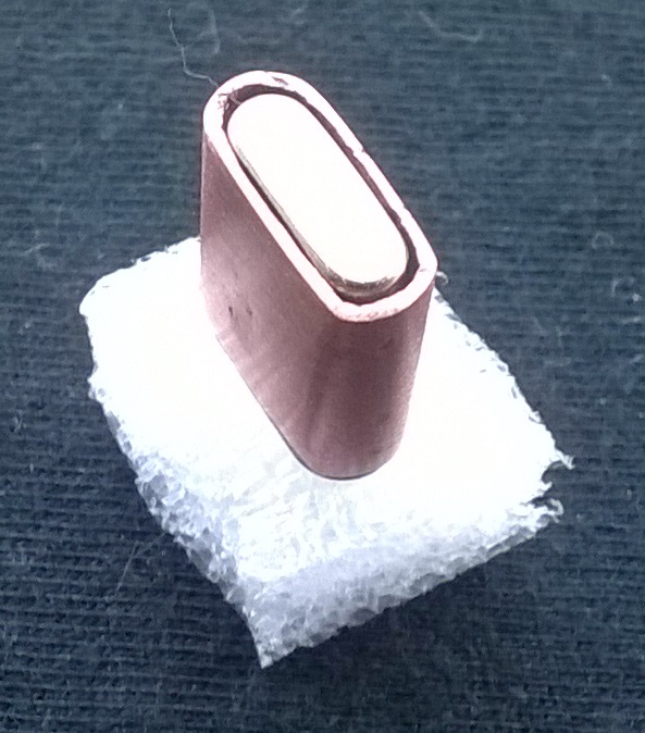

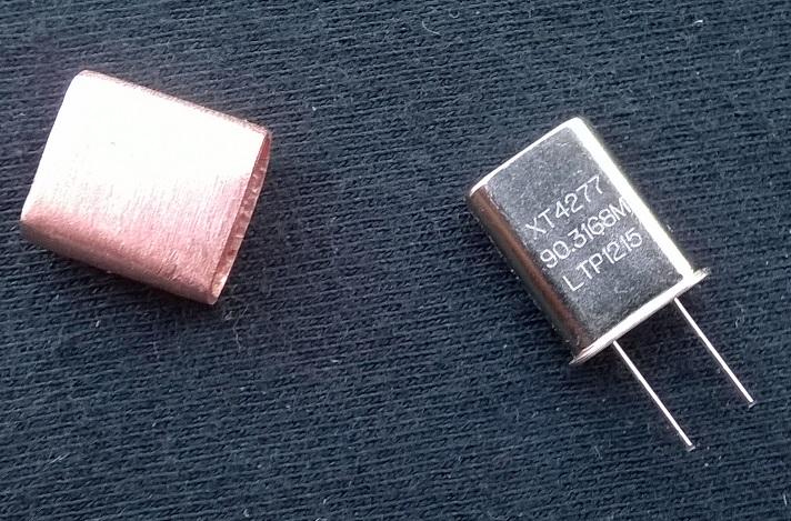

This is the copper tube, pressed by a vise, to thermally coupling the crystal with the heater PCB.
Not a simple job, and the result is not optimal.
I will ask for a quote to manufacture these items by a milling machine.
