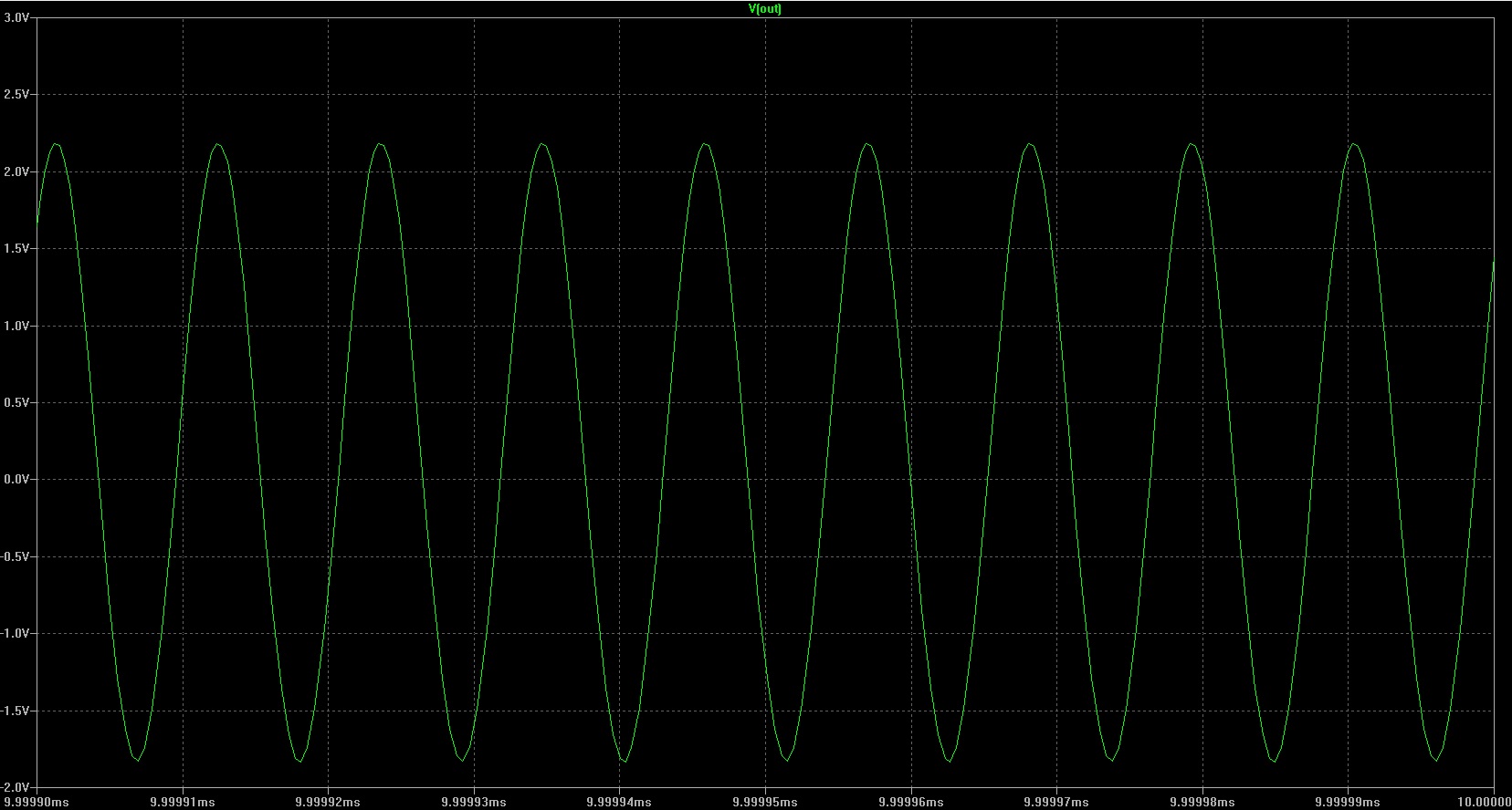

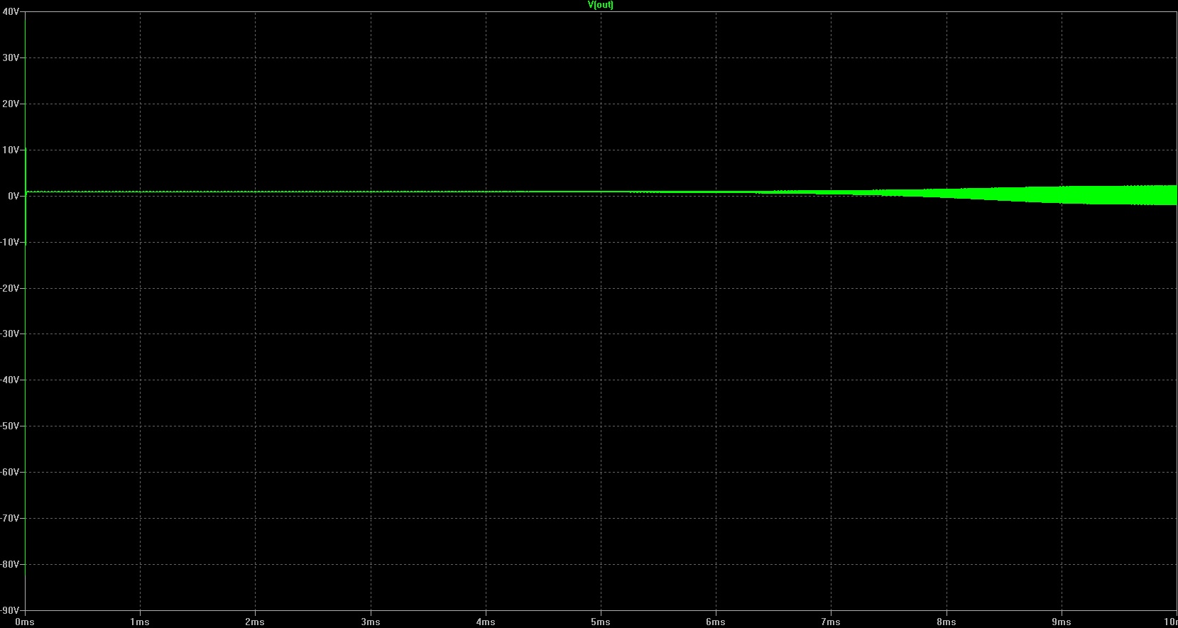

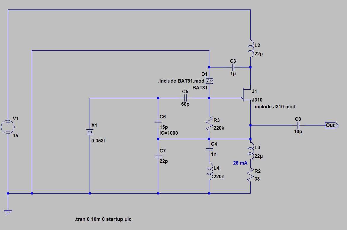

I'm still working around 90/98 MHz oscillators, I have not yet fixed the starting issue.
I've done several simulations: seems the fet based Clapp oscillator should start and sustain the oscillation, but when I test it on the PCB it doesn't start. As I said previously there could be a problem with the low transconductance of the fet to overcome the ESR of the crystal.
Tomorrow I leave for vacation, so I'll continue experimenting when I'll come back on May 18th.
Simulation results attached.

Is the hot carrier diode a limiter? is it necessary? its capacitance is non-linear and may be eating some of the available high frequency gain. At 100 MHz and higher Spice is not the best tool and you do need good modeling of the parasitics for simulation. Harmonic balance - Wikipedia, the free encyclopedia
Usually there would be some AGC circuit to regulate the output, especially at these frequencies since the device parameters change a lot with temperature etc. You do not want to overdrive the crystal since you could break it.
28 mA is a lot for a JFET in that family. The power dissipation alone will be .25 W, right at the limit for the package. If you turn down the current it may work better. I usually keep to around 5 mA.
An ideal system would use an SC crystal around 5-6 MHz for the primary frequency reference (lowest overall phase noise) and then lock (injection lock or PLL) a separate oscillator at the target frequency (lower phase noise away from the carrier) (e.g. 24.576 MHz) which will get the best of both. It would be a major undertaking to get it all running.
The lowest phase noise oscillator circuits I have seen (Wenzel and Oscilloquartz have not shared their best circuits) take the output through the crystal using it as a bandpass filter in the process.
I have already tried removing the diode, but the oscillator doesn't start anyway. The 220K resistor acts as an AGC, thanks to the leakage current flowing through. Removing the diode the amplitude grows till Vcc (15V) and the oscillator becomes instable.
28 mA is probably the upper limit for the fet, I simulated the circuit with high bias current because the fet reaches its maximum transconductance. With lower current it doesn't start either in simulation.
I believe there is not enough gain to overcome the losses in the network and the ESR of the crystal (around 37 ohm).
I'll give a try replacing the fet with a bjt such as BFS20 or BFR92.
Look for low cap RF schottky diodes with <1pF cap. It depends on required voltage but there are some super low cap RF diodes available.
Also WRT low capacitance and in particular low modulated capacitance, there
are better possible Jfet alternatives. J305 is a lower C candidate.
Another option is to try a bootstrapped cascode with mixed jfets. The lower jfet could be higher gm / lower noise, the upper jfet lower capacitance.
There are many combinations depending on specific requirements.
If you have a stable signal generator and a scope with lo-cap. probes then you can
feed some RF into the output and watch with the scope where the loop gain fails.
The generator must be close enough to the crystal frequency, of course.
