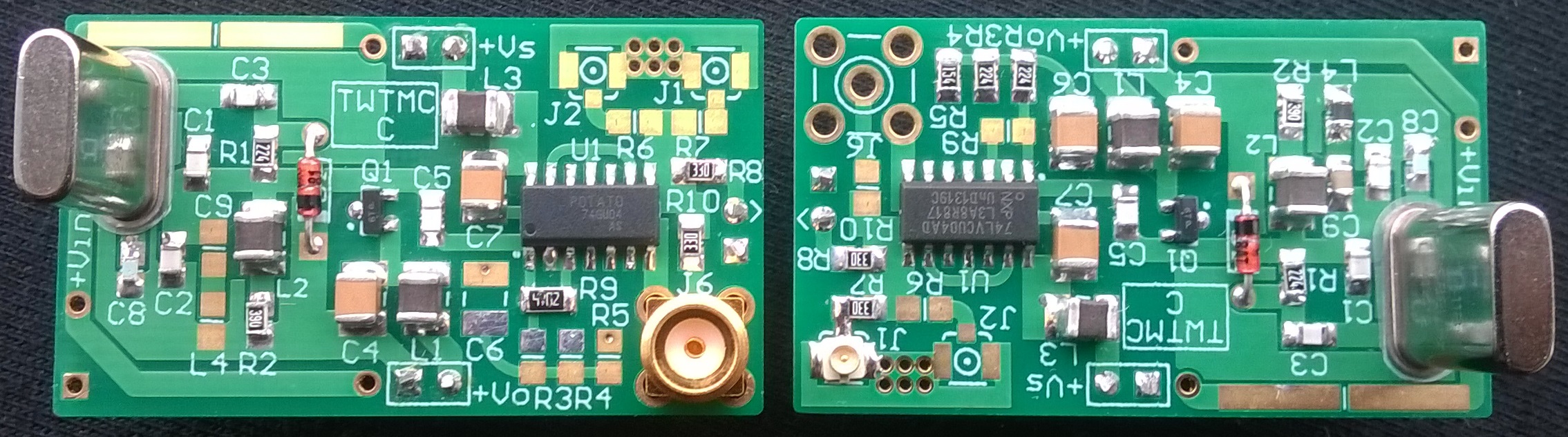

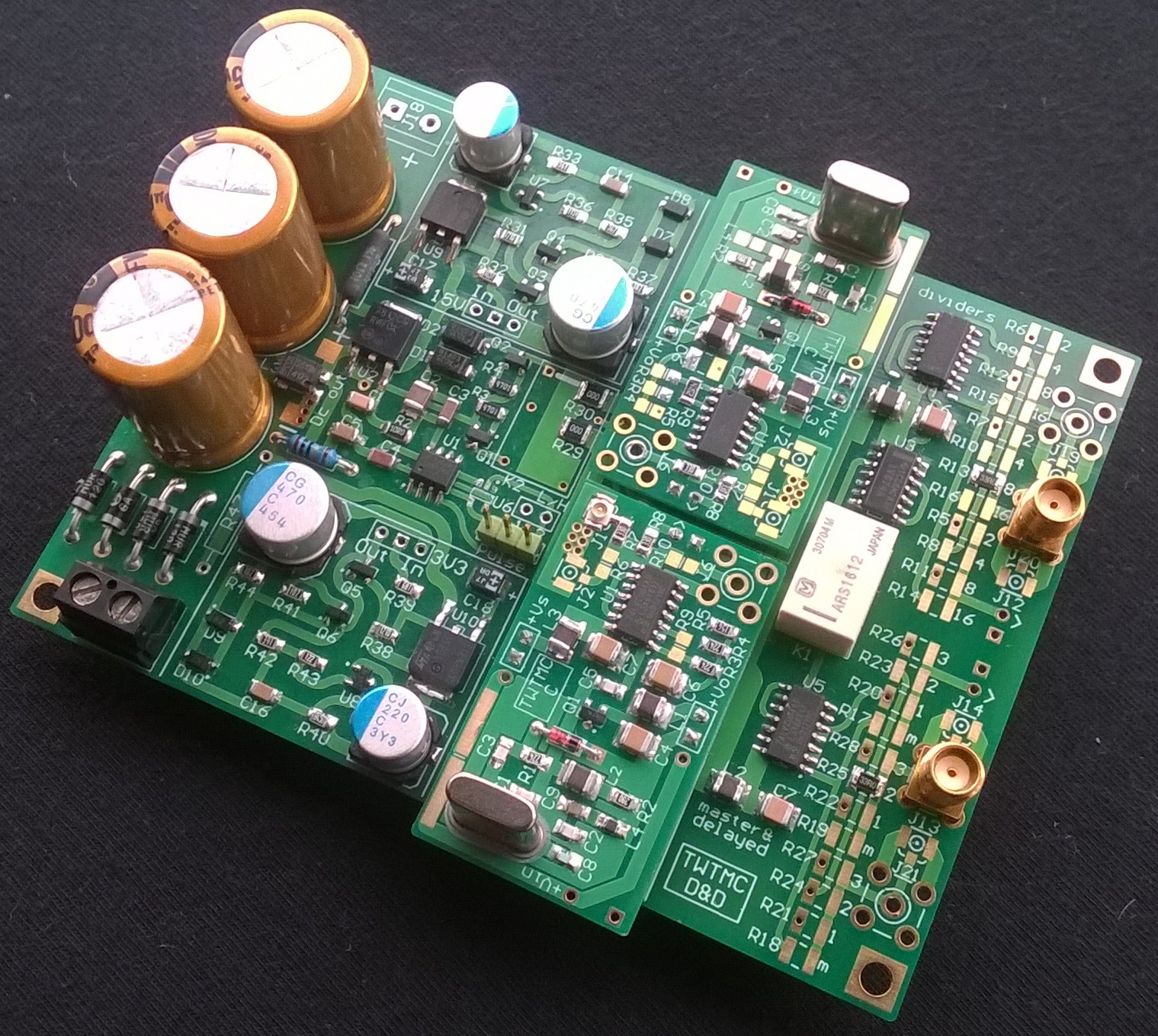

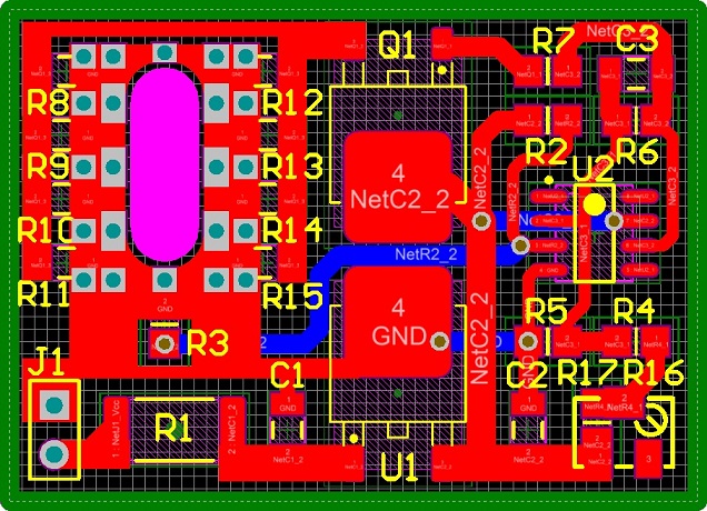

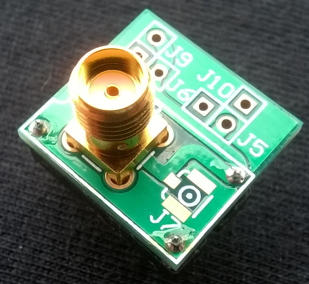

While waiting for crystals delivery, here attached some pictures of the finished boards.
DIL adapter, fundamental and overtone oscillators, daughter board and final assembly.

Very nice board Andrea,Congratulations.
you recommend a transformer 17 volts for TWTMC board,but transformer 17 volts are hard to find,an alternative?🙂
What is the 3 pins 'Pulse'

Hammond 229A34 parallel wired from Mouser
229A34 Hammond Manufacturing | Mouser
18Vac transformer works also as well.
Pulse pins are provided to switch between the two oscillator, drived with a >15 ms pulse signal. This logic is not needed if you are using TWTMC with Ian's Dual XO board.

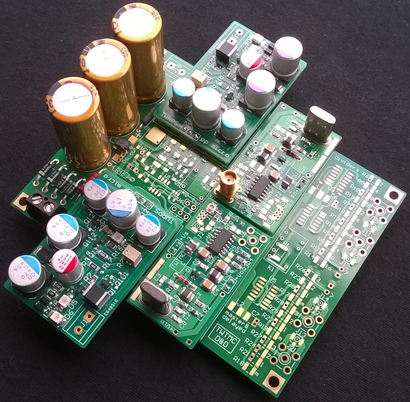

Daughter board using external regulators
http://www.diyaudio.com/forums/power-supplies/212476-well-regulated-power-supply-14.html#post4242428

This is a simple oven to be used with SC-cut crystals.
Board size is 1" x 1.4", compliant with TWTMC oscillators.
The crystal fits into the PCB slot. It should be soldered to the top and the bottom of the PCB.
I'm also looking for a copper clamp to solder to the PCB. In this case the crystal will fit into the copper clamp, without any soldering.
Components values have to be adjusted for the right temperature.
The TWTMC-C Colpitts-Clapp oscillator is not the ideal for SC-cut crystal, but the higher Q of the crystal could help anyway.
Next step I'll start designing the Butler two transistors and the Driscoll oscillators, more suitable to work with SC-cut crystals.

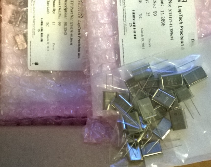

Crystals have just arrived, all with individual test (attached).
Let me give all a try to check they start at the right frequency , and to define the final component values for each frequency.
Then I'll begin the shipment to all the members.

As soon as I will have checked all the crystals in the oscillator circuit to define the final component values for each frequency, next weekend, I'll post the final BOM and the assembly guide for each board.
Each crystal comes with a number written on the metal can, so you can refer to the testing sheet I have posted to know the specs of the crystals you will receive.
