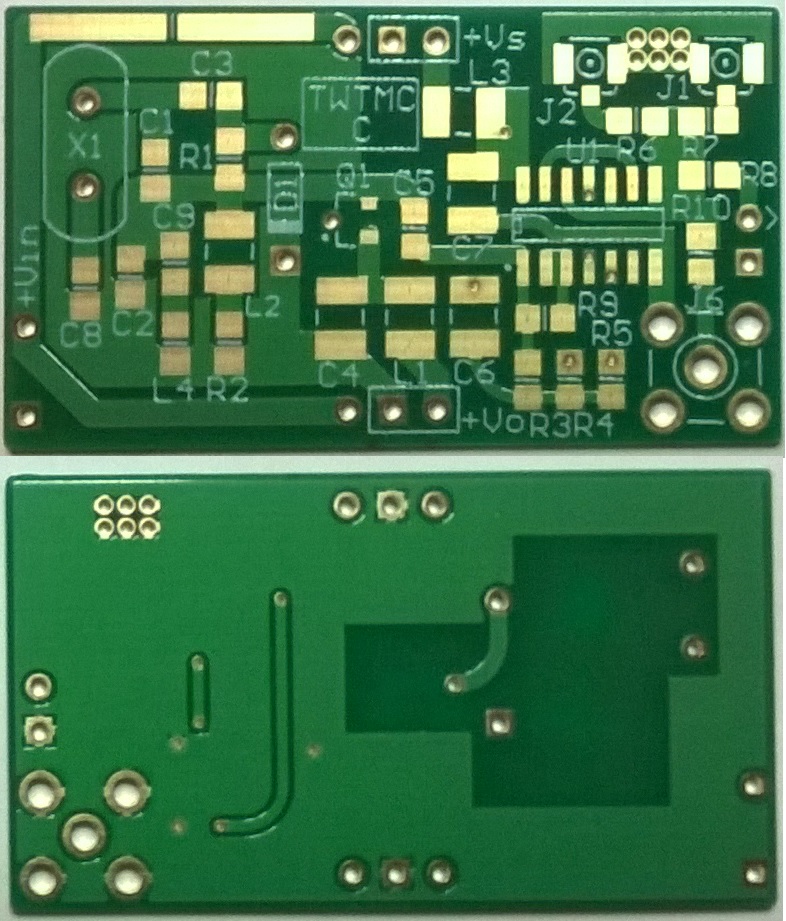

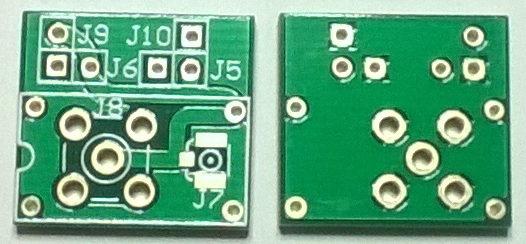

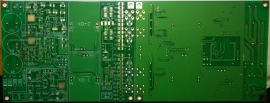

PCB
PCB preseries arrived, ready to build and test (sorry for the bad quality of the pictures).
Crystals shipment scheduled on March 23.
