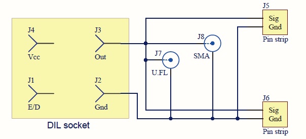

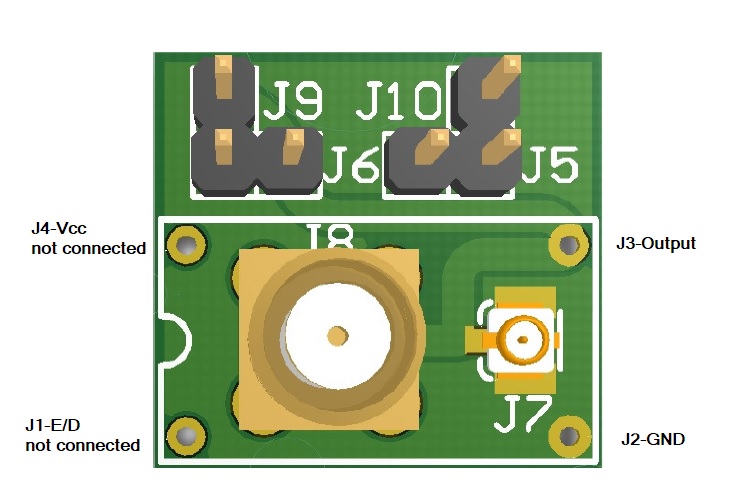

If you are using the old Driscoll oscillator TWTMC-D you don't need the sine to square converter board since its output is CMOS.
Then you need the DIL adapter TWTMC-DIL to fit Ian's board and no power supply is needed.
The problem is that I don't know if Ian's boards manage the clock switching between the sample rate families.
If so you have no problem since the board will select the right clock according to the sample rate family and no short circuit will occurr.
If not so you will get a short circuit between the two oscillators because they are both active at the same time.
So you need extednal circuit to manage the clock selection, just like the circuit implemented in the D&D board (you need 5V signal to switch).
Is someone knows how Ian's boards works please help.
If you would use the new Driscoll oscillator you need the sine to square converter because its output is sine wave.
Then you should use a pair of TWTMC-STS (SX and/or DX according to Ian's board layout).

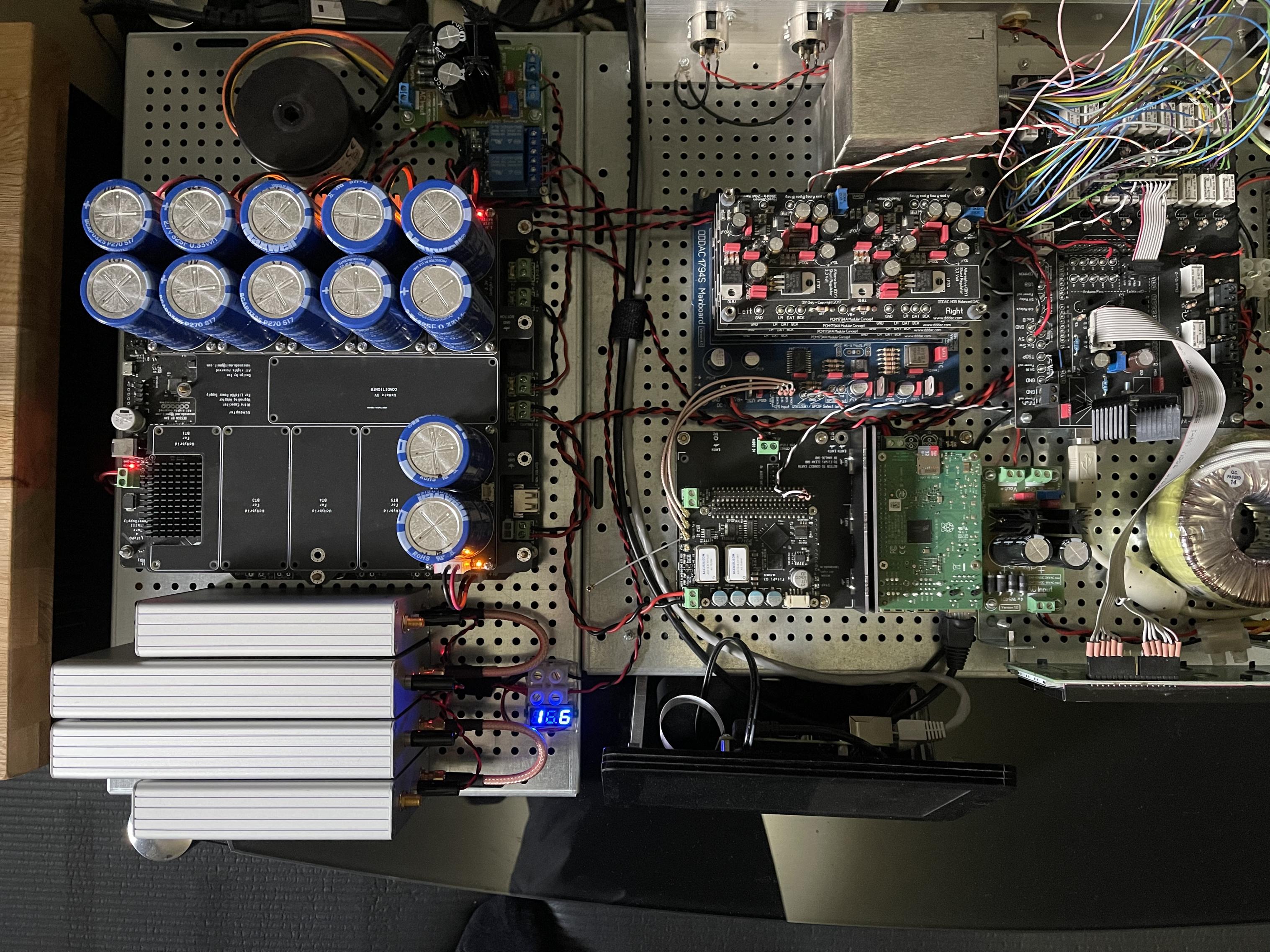

That has become one hell of a DAC Simon! Congrats and lots of joy
One question, I see only one set of doublers ?
Thanks Doede! I have the other set here and will see if they are needed later
For now I am covered up to 96khz music which is fine for my music collection

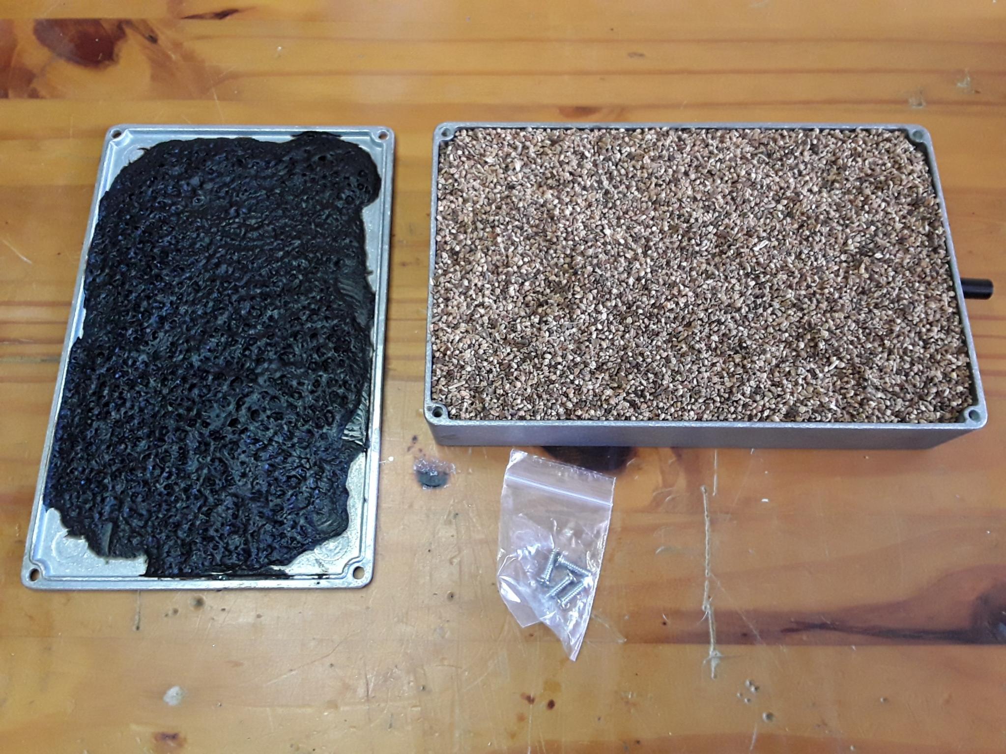

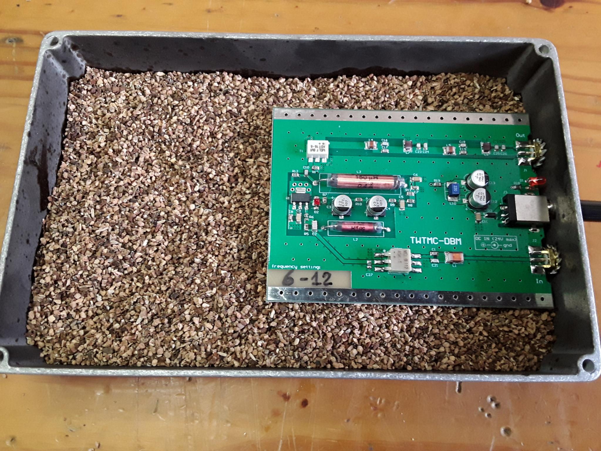

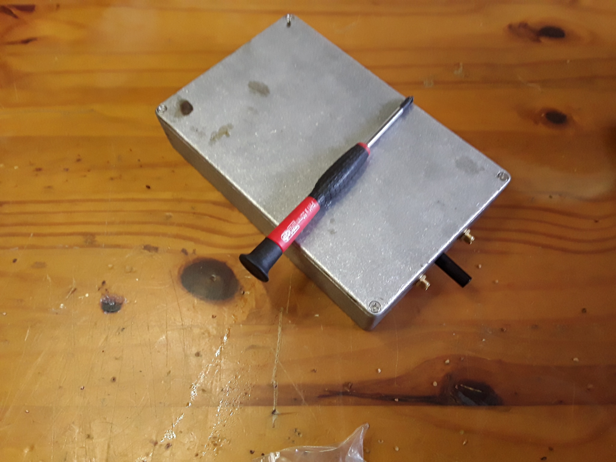

Hello,
Yesterday i received some cork panels to make a '' soundproof enclosure '' for the aluminium clock boxes.
I also got a shoebox volume of '' grinded cork '' which is use to completely bury the circuit boards in the aluminium stomping boxes.
So far i only closed two doubler boxes and when you give them a gentle knock you can not hear that it is a metal box!
You just put a first layer of cork particles. Then guide the SMA connectors to the holes in the box . Taking good care that the print is fully supported by the cork. Then add extra cork up to the rim make it even an have a level that needs a very tiny amount of pressure to get an airtight closure.
So it looks like it is going to work perfectly.
If Doede bought the same circuits he can compare his solution with mine.
Greetings, Eduard

Hello Simon,
From the information published by Andrea and some serious users of the clocks we can conclude that everything matters.
The box i am using is already a bit more acoustic " inert" because the way it has been produced and designed.
I didn't expect that adding the cork particles would give this much improvement. JUST the change in sound when knocking on a box filled with cork was really big. On top of that cork is a natural product which could be better sound wise than an artificial fabric. Remember removing plastic foil wrapped around electrolytic caps?
I made the hole for the powerplug a bit bigger so it can be passed without making any contact with the aluminium. This can cause the escape of some cork particles so i will have to add some nail polish around the tiny opening to keep the cork inside.
Once the plug is inserted the opening is covered.
