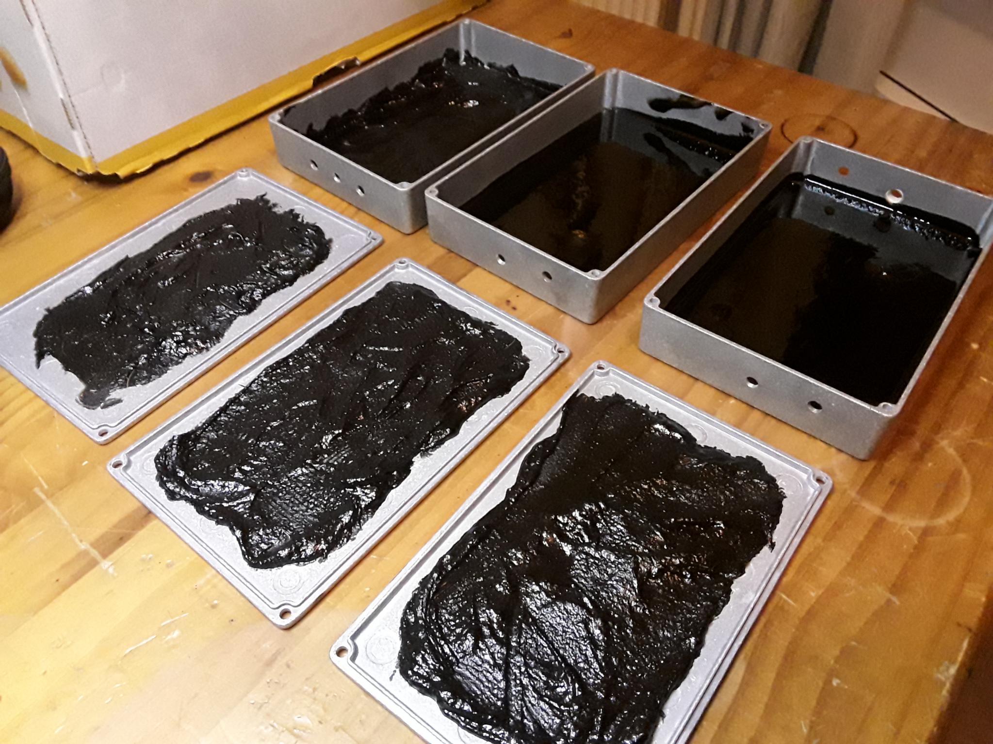

Hello,
Today i started preparing the so called aluminium stomping boxes. They are used in the entertainment industry for " guitar pedals" i like their industrial looks.
I melted some old vinyl records to give them a kind of vibration killing coating on the box and on the lid.
I have to see if i also need some vinyl on the smaller surfaces too but usually just covering the big panels will do.
The effect of this little vinyl is already clearly to notice. Maybe will use something acting like a gasket between lid and box.
If i can make a kind of airtight enclosure i could use dry sand inside or i will go for cotton/wool "" lining"
Maybe can use a tiny microphone and some acoustic measurement software to see which solution will give the biggest reduction of vibration/sound reaching the microphone buried in the box.
Greetings,Eduard

Hello,
There isnt any kind of coating on the aluminium. The surface has been given its look by " tumbling " it in a kind of rotating machine filled with some kind of pebbles. Of course after some time there will be a kind of " thin film" because the metal reacts with the air. But when you close the box you just have to take care that there is a good contact between the two parts. Having less parts will make it easier to get a good screening.
Greetings,Eduard
