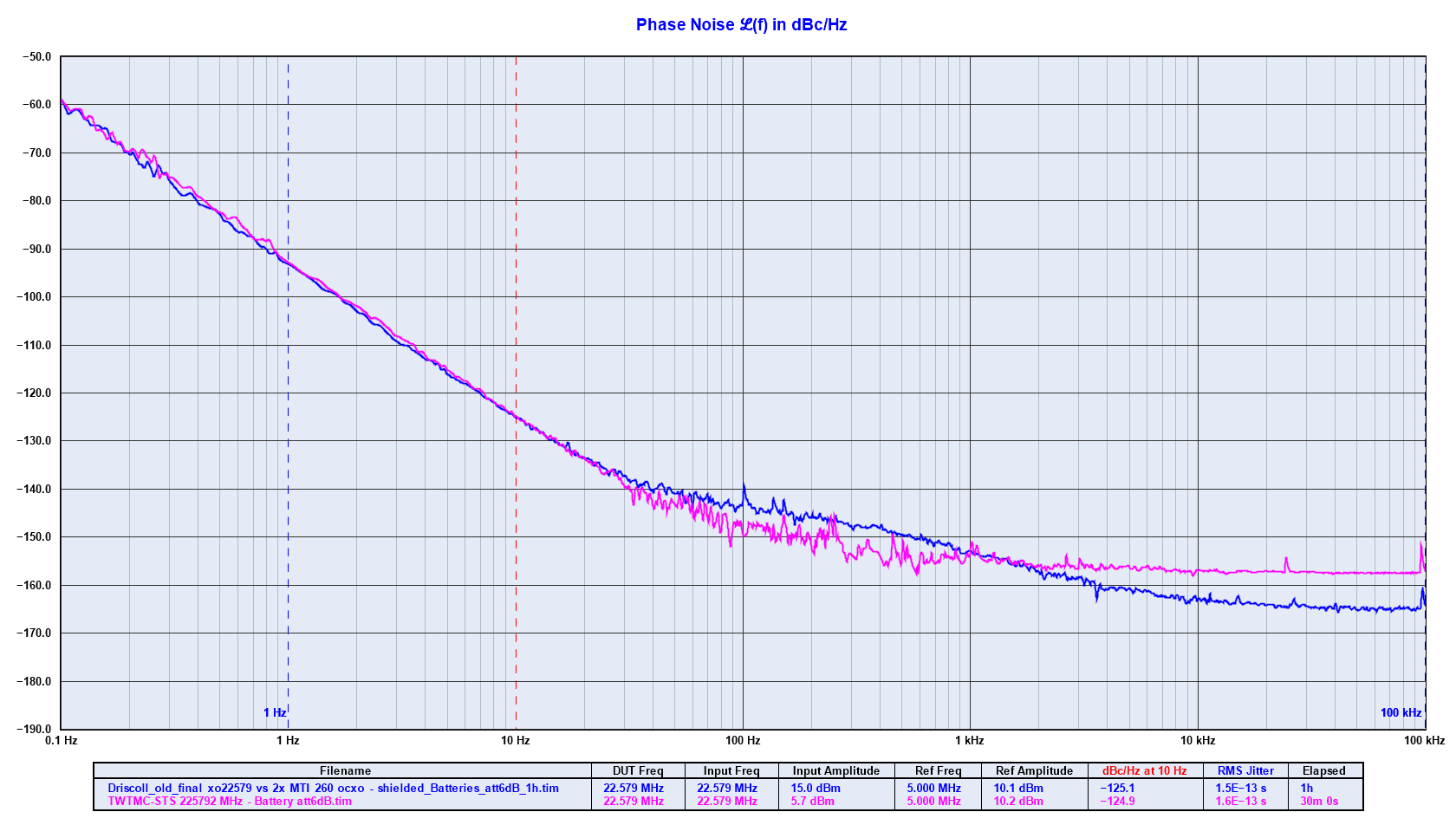

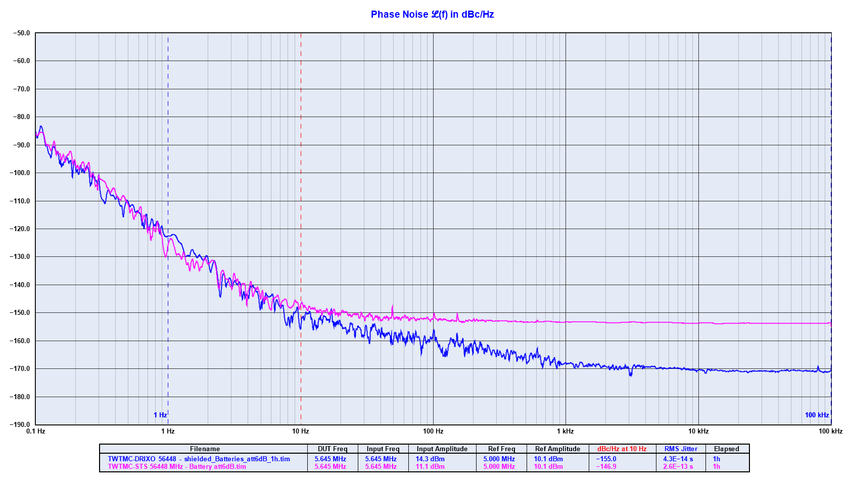

There is a big difference claiming that the sine to square conversion process does not affect the phase noise and claiming that the sine to square conversion process does not affect the CLOSE IN phase noise, that's what I claimed.
Plots have been published, sine to square conversion process affects the noise floor but it affects almost zero the close in noise.
The way in which the noise floor degrades is related to the slope of the sine wave to be converted, the lower the frequency the greater the degradation.
In fact the degradation is greater when converting 5.6448MHz sine wave in respect to 22.5792MHz one.
For me it's enough logical.

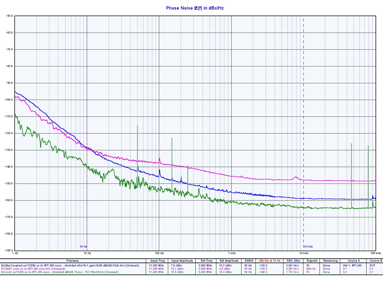

Unless I'm missing something the square to sine phase noise test is not using the Drixo, or was this a real attempt to mislead with 'technobabble'?
Yes, you are right, it was a 5 MHz CMOS output CTS oscillator.
And just to confirm the reliabilty of the measurement I attach the phase noise plots of the HCD661 OCXO CMOS output at 11.2896 MHz measured with the Timepod (pink line) and by the manufacturer with the Aeroflex PN9000.
As you can see the plots are almost superimposable, just in case the Timepod is a little pessimistic.

Sorry, and how is this relevant ref. the sine to square conversion phase noise issue discussion?

It seems to be very relevant since it demonstrates the reliabilty of the measurement of a square wave oscillator, repeatedly challenged as you know.
Instead I don't understand what is the sine to square conversion phase noise issue, i cannot see any issue.
