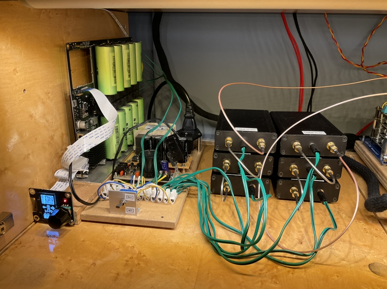

I have build a dual power supply with voltage regulator and battery so I can switch from battery to voltage regulator. In this way I keep the clocks continuously powered and can switch to battery power when I feel the need.
It works as a hot switch, the ps caps on the clock boards are enough to keep the clocks running without hiccups while switching to and from battery supply.

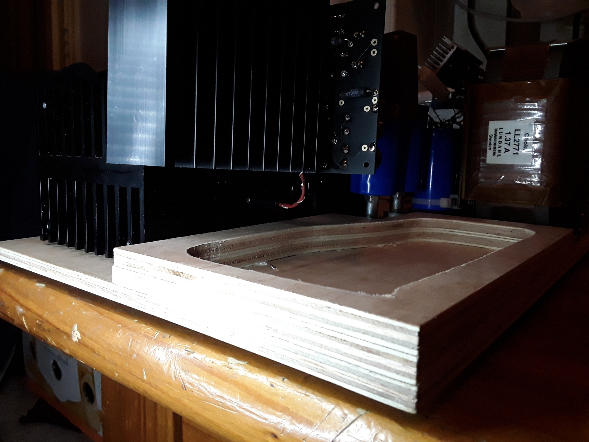

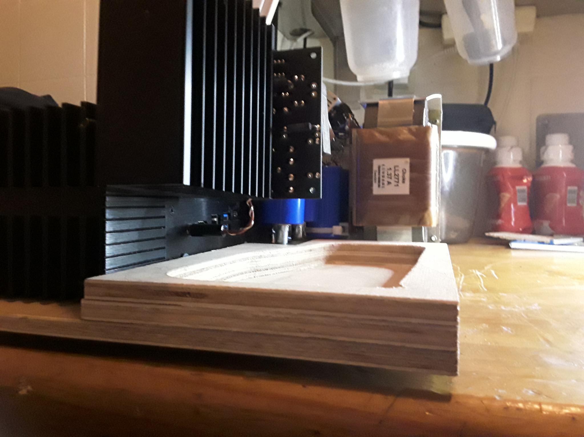

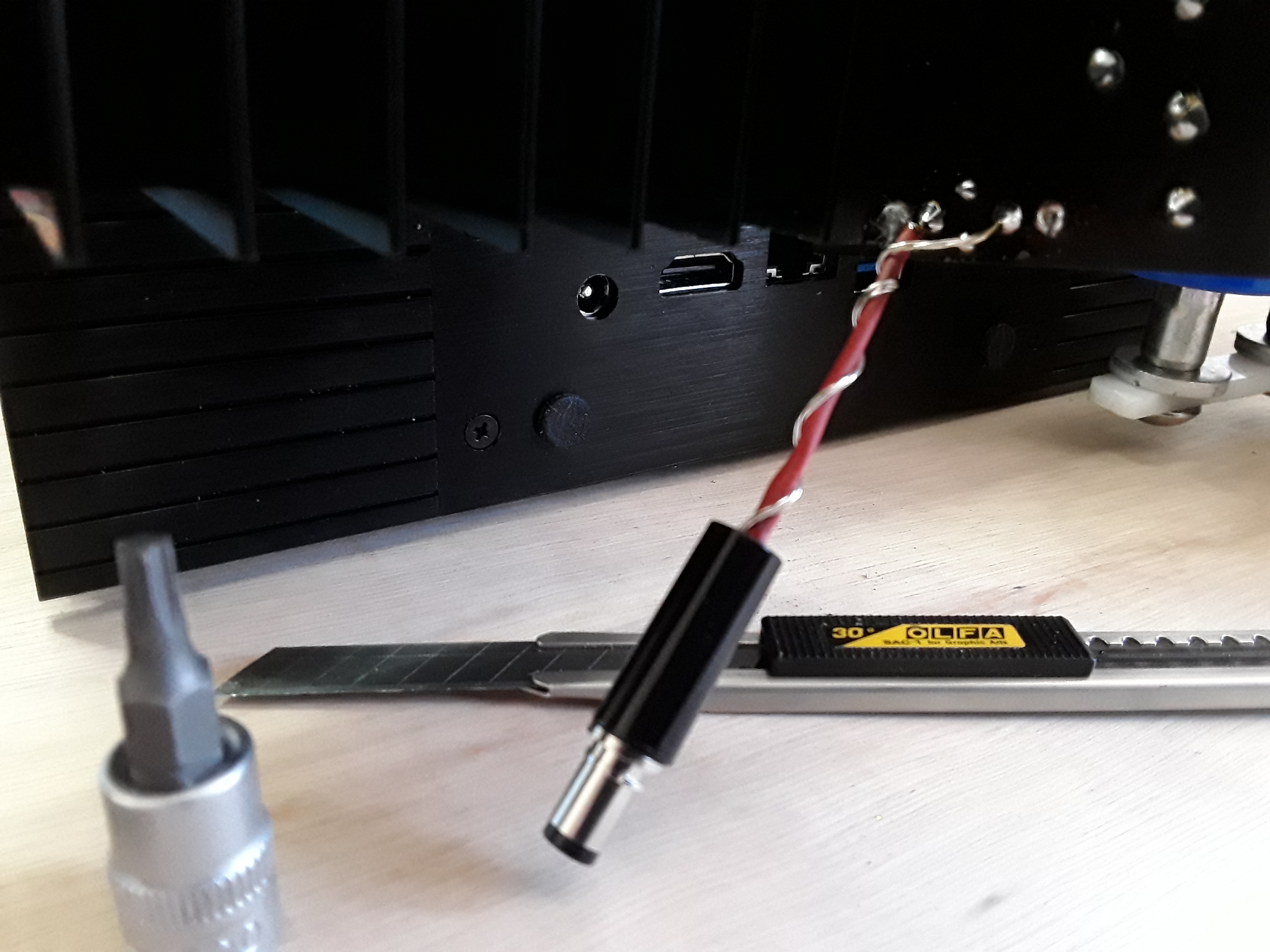

Just sharing some pics of Roon Nucleus power supply.
Using LL2771 for choke input in a LCRC configuration followed by a regulated supply made by Doede based upon the dddac supply.
Power output voltage around 16,5 volts so supply is similar to the clock supply.
With the clock supply i am using big Eaton supercap that is charged by a battery charger and when enough voltage is reached an Arduino controlled circuit will switch to an " audiophile supply "
Right now dont know if the Roon supply will benefit from adding a 60 plus F supercap.
I do know that reducing dc cable to the circuit is essential. It is really short between Doede's circuitboard and the dc input on the Roon chassis
I added a kind of wooden frame on top of the wooden board which is just 9 mm thick.
Dont know if it will add something but i wanna try adding some lead shot because still have some stock.
Greetings,Eduard

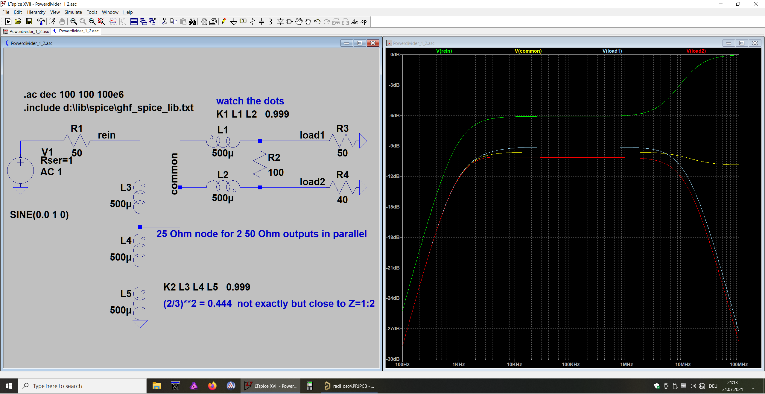

I have simulated around this evening for the power splitter for the timepod low frequency extension.
It will be interesting to include parasitics and less close coupling.

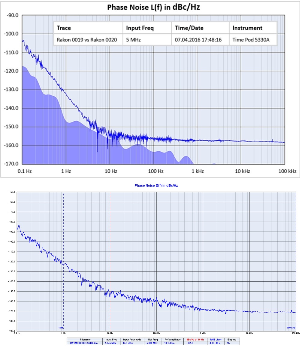

I seemed to have said several times that we didn't care for long-term stability, since it does not matter much in digital audio.
So if you are pointing to the Allan Deviation our oscillators are poor, I have also said this several times.
Looking at the short term stability there is not a great difference: the Rakon has better close in phase noise while the DRIXO has better noise floor.
Both measured with the disputed Timepod.
It's not that bad for two beginners like us. 🙄
