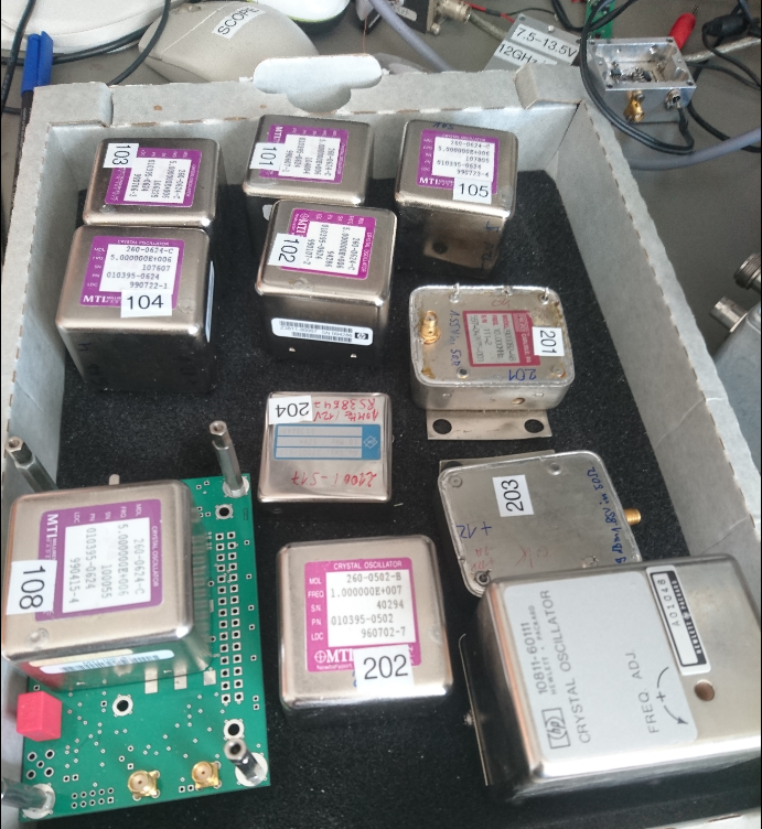

The 5 MHz units are all from butchered Lucent KS24361 GPS
receiver redundancy units, built by HP/Agilent for Lucent.
They were spare parts still in the original box, never spent 20
years on a telecom tower in China.
The redundancy units have no GPS receiver boards, so I got
them for a relatively good price. Shipping from Florida to .de
cost an arm and a leg, however.
They were OFF since the production end test maybe 20 years ago.
If they run for a month, they might improve, esp. closer to the carrier.

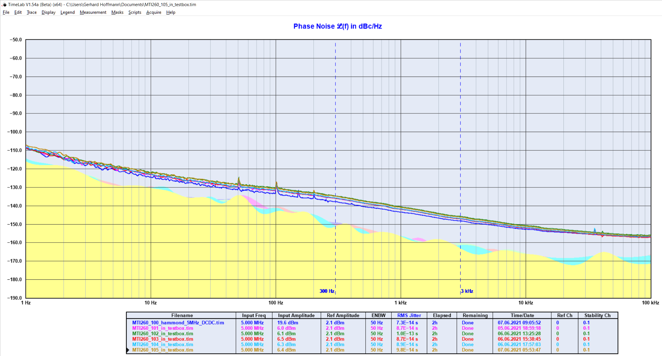

Unit 105 was significantly worse than the others, but after running for
a night it caught up. Maybe it has vibrated some debris from the crystal.
The Morion MV89A I got from China had a low success rate.
Power supply was a Rohde&Schwarz NGT 20 , with some low
pass filter in the Hammond cast alu test box.
Unit 100 ( 5 MHz MTI-260) and 200 ( 10 MHZ Morion) are permanently
mounted in a Hammond box with a Mean Well 230Vac to 12Vdc
switching converter. I added 1000uF on the output but not much more.
That does not seem to be much of a disadvantage. Unit 100 and 200
have been on for a week or two, that's why they have their own switcher.
In fact, unit 100 is the best of the 5 MHz units.
The MTI-260s are mostly the same, that's large series production.
There are rubidium-like versions of the 260, but they do not go
into Telecom towers.

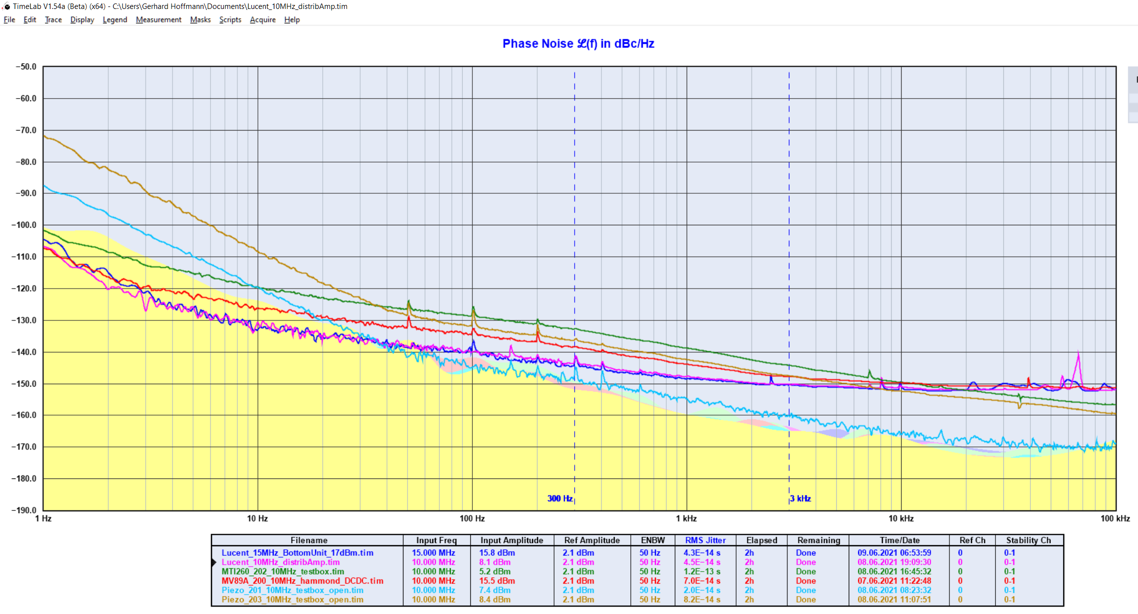

10 and 15 MHz
Piezo203 is the worst, I bought it on the flea market at the VHF meeting in Weinheim.
I got piezo200 for free as an add-on, it looks awful, but at least far out it is
the best of the bunch.
The Lucent traces are not running free but are locked to GPS.
Lucent_15 MHz is the normal output of the GPS receiver, the tripled MTI-260.
Lucent _10 MHz is one of the 4 10 MHz outputs of my add-on.
It has a CFB amplifier after the oven, then a doubler with 2 BF862,
then a CFB amplifier for each output.
< http://www.hoffmann-hochfrequenz.de/downloads/DoubDist.pdf >
