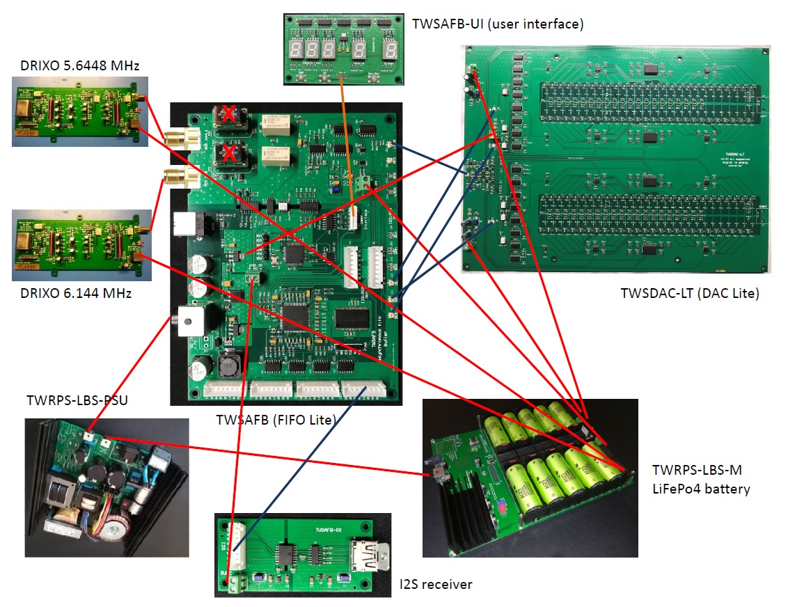

Exciting news Andrea !!
With regards to the I2S receiver, it seems to be HDMI right ?
I am definitely in for the DAC and the FIFO
Andrea. Do you think that HDMI interface for I2S is optimal? 😉
I think the source is not much important, the FIFO should isolate the DAC from the source since they work in different time domains.
HDMI is before the fifo+isolator, it shouldn't make any difference.
Yes, the jitter coming from the source cannot affect the DAC because the FIFO isolates them.
Data incoming from the source are stored in a memory and then they coming out with a different master clock, the FIFO is asynchronous.
The quality of the output depends on the quality of the FIFO master clock.
