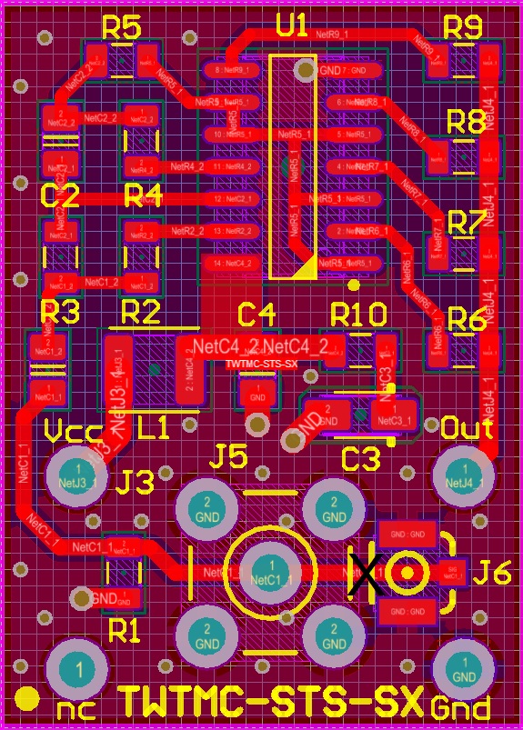

I am planning to experiment with WTMC in Network devices, 25 MHz, and the necessary parts are on order through a friendly helper. I will put the STS board inside the Network device, and provide a clean 3.3 VDC rail for it. The plan would be to use an SMA to SMA bulkhead jack, and a very short SMA-SMA cable from the rear panel to the STS board.
The question would be, what is best practice to connect the clock output and ground from the STS board, to the clock input (pad, SMD) on the device? Options:
1. I am handy enough that I could, likely mount a micro BNC to the board (u.fl), and then run a very short u.fl cable to the STS board output (it appears this board would require a direct soldering of the u.fl cable for output, right?). I can locate things such that this u.fl cable would be very short, perhaps 5 cm or less.
2. I could run a plain twisted pair of small gauge wires for clock output/ground and solder direct to the board pads, and to the STS board output, again very short, <5 cm.
At these lengths is either approach an advantage? Or is there a "better" way?

You can try to cut the trace between the input and J6, so you could use J6 as the output to connect the TWTMC-STS to your device using a 10 cm u.fl-u.fl cable.
Then you can connect the input to J5 using a SMA-SMA short cable from the pass-through SMA installed on the panel of the device.
