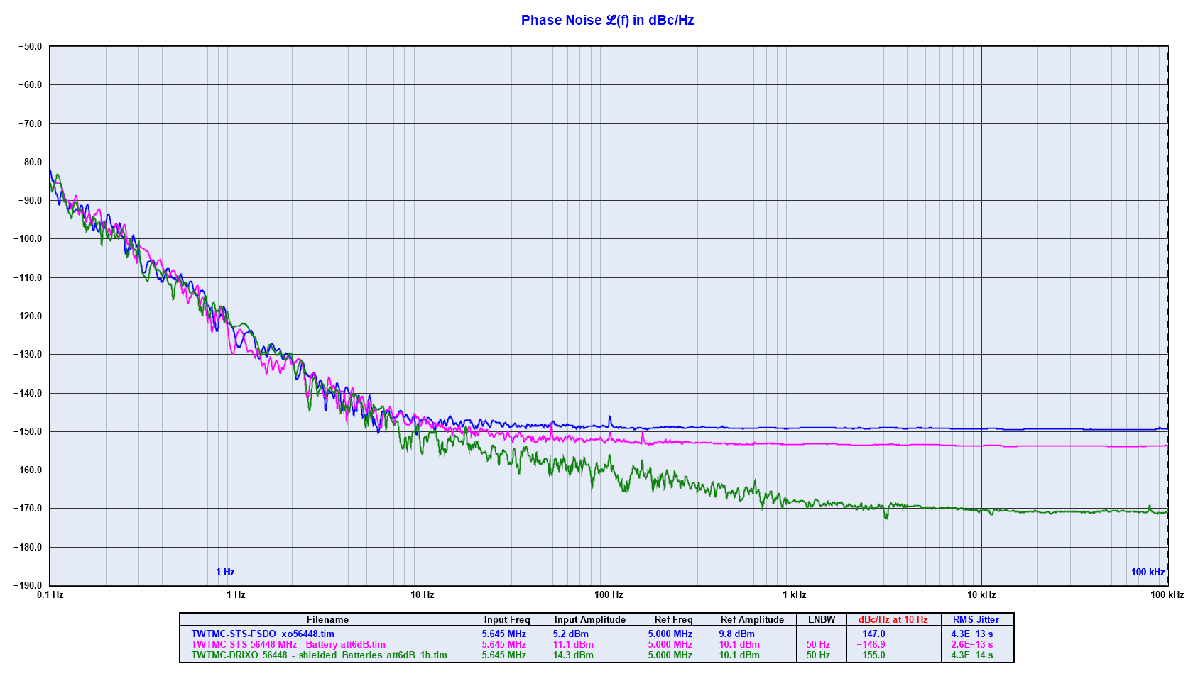

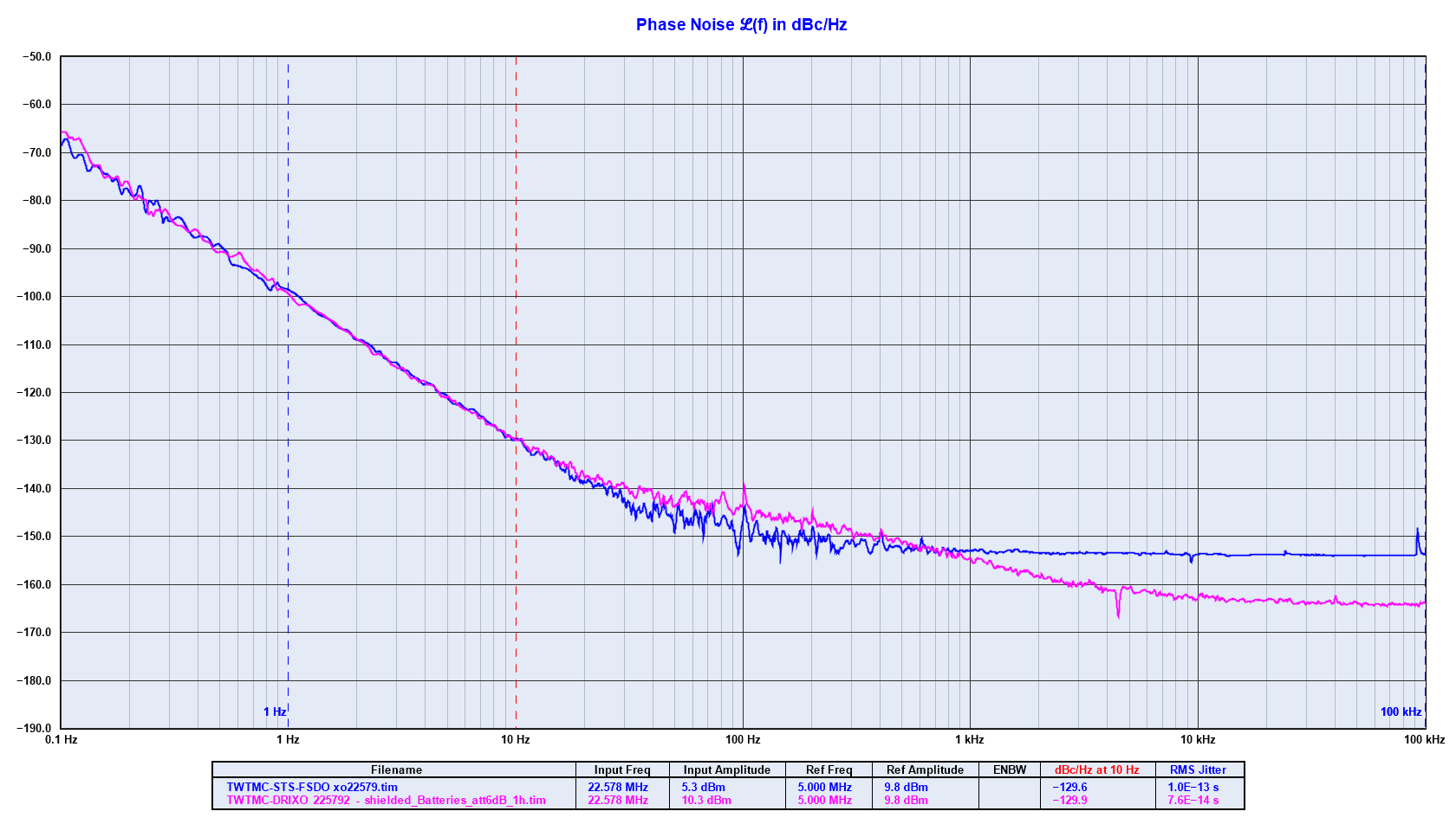

TWTMC-STS_FSDO phase noise
I attach the phase noise plots of the TWTMC-STS-FSDO (sine to square converter, fanaout/switched output) that implements the LTC6957.
The oscillator used to feed the TWTMC-STS-FSDO is the New Driscoll TWTMC-DRIXO at 5.6448 and 22.5792 MHz.
The plots show the phase noise comparison of the squarer against the sine wave oscillators.
The 5.6448 MHz plot includes also the measured phase noise of the TWTMC-STS-SX sine to square converter with the same oscillator.
There is not much difference, the LTC6957 is a little better close to the carrier (1 to 10 Hz) while the 74AC04 has a little better noise floor.
