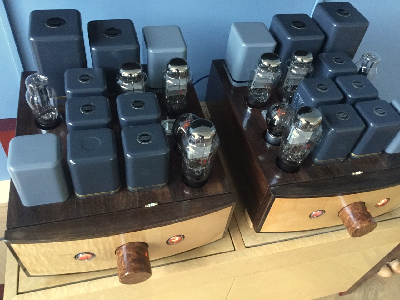

would you care to share which DHT are you playing with ?. I am in search of a nice design for a 2A3 with an interstage transformer. Any hints would be gladly welcomed
I have build an amp that is very flexible in use. I have had countless tubes and schematics build in this chassis.
When I had a 2 way speaker filtered at 200Hz it was equipped with 2 SE output stages using PX-25 and later AD-1 tubes including active filtering, interstage coupled to the driver tube.
Now I power a wideband open baffle speaker with a balanced AD-1 output stage. All stages are coupled with Tamura interstages.
You can PM me if you like more information.

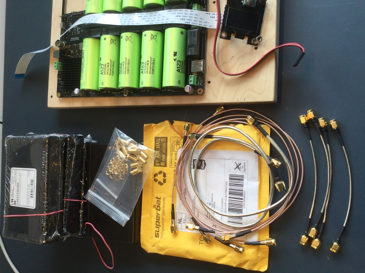

Hi Supersurfer,
Where did you got the short ufl cable of your picture please? Are they 2" long ?
