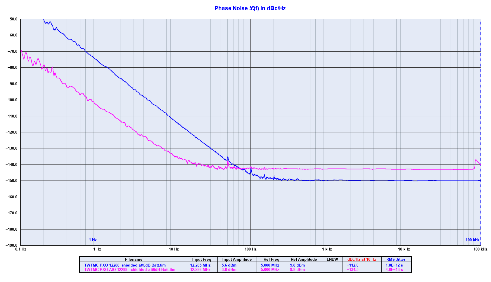

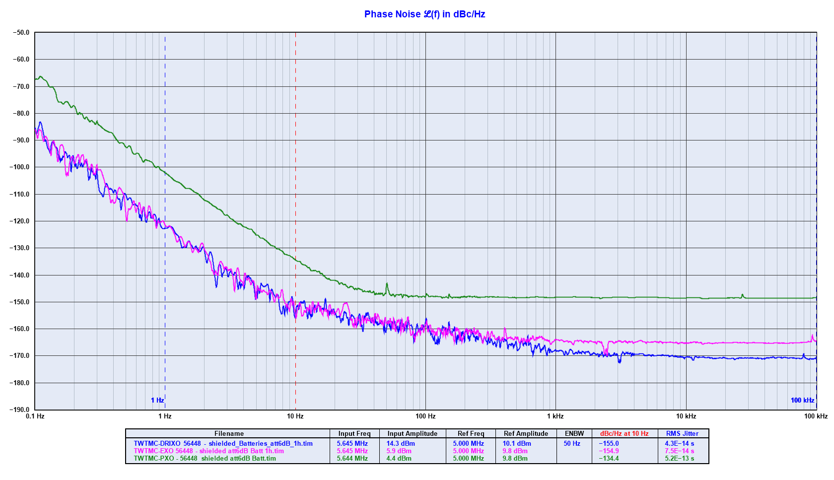

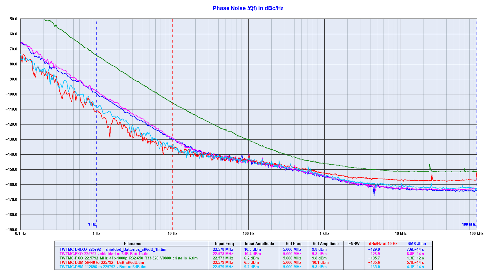

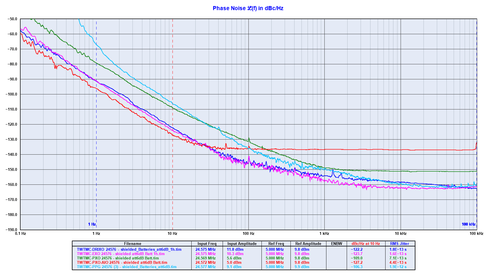

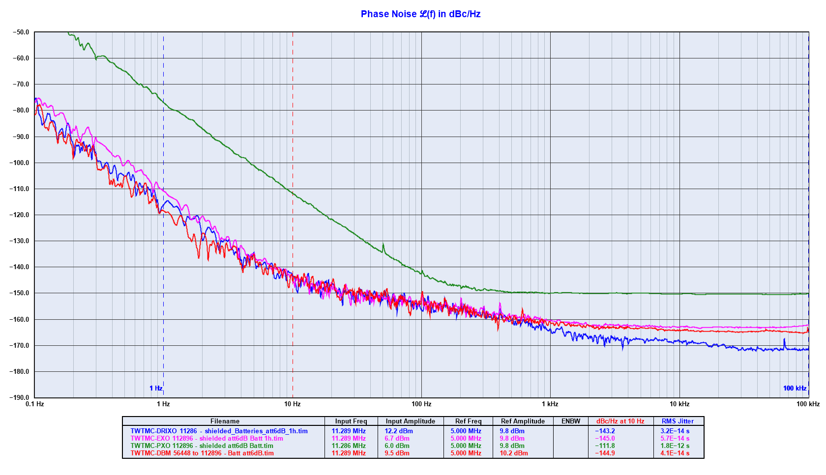

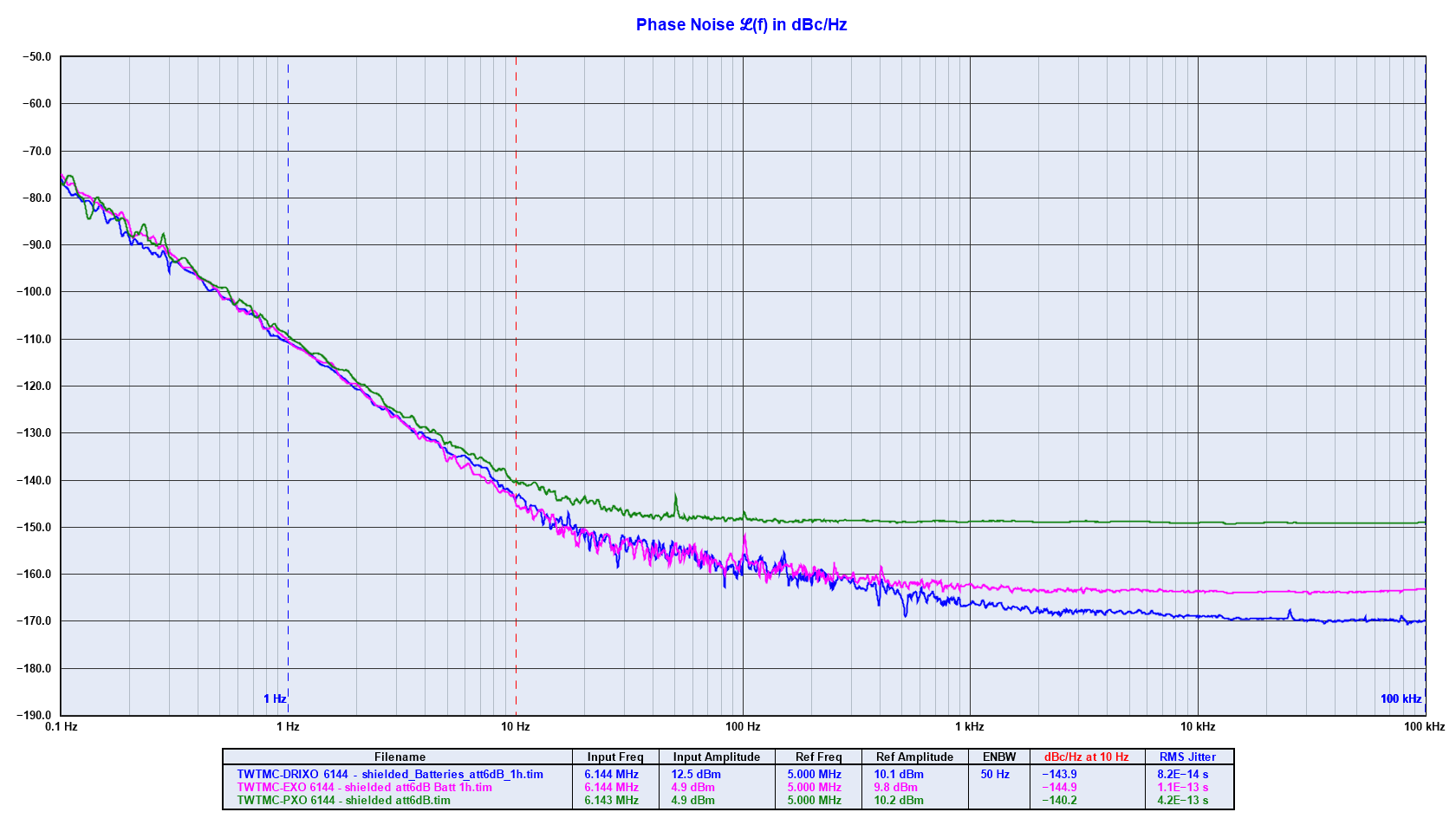

Oscillators phase noise comparison
I attach a few phase noise plots to compare different oscillators at the same output frequency.
