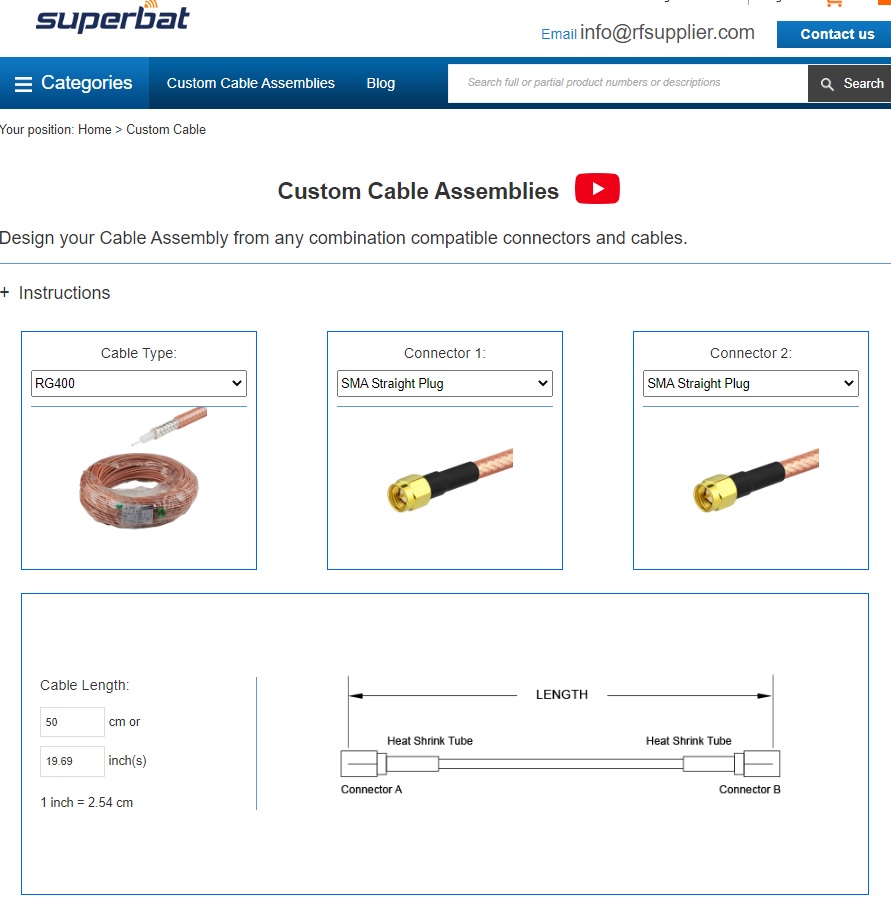

Do you mind telling us what SMA-Cables you are using or recommending? Anything "special" to watch out for in the Cable-specs?

SMA plug connectors and RG400 semi-rigid cable like in the attached picture.
You can buy them from RF Supplier
Custom Cable Assemblies | No Minimum Order
Maybe you also could find them on eBay.
